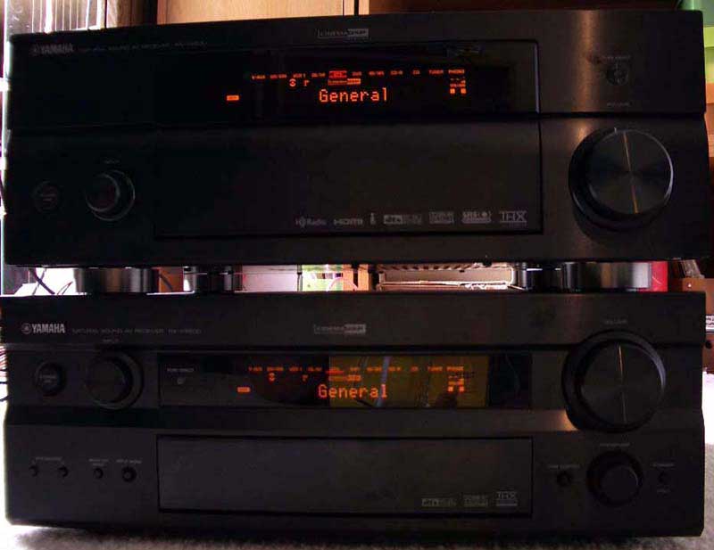

In preparation for our comprehensive review of the new Yamaha RX-V4600 A/V receiver, we thought we would give you a sneak peek at it up close and compared to the RX-V2500. Also check out the press release of the RX-V4600.

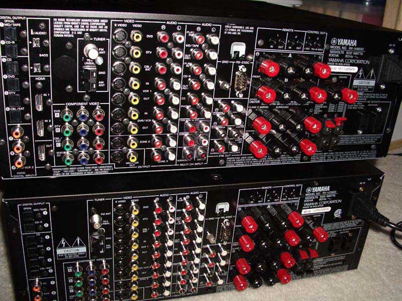

Yamaha RX-V4600 (top); Yamaha RX-V2500 (bottom)

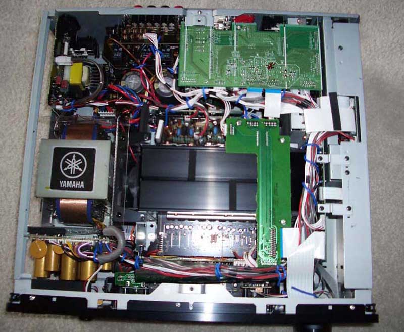

Yamaha RX-V4600 insides (left); Yamaha RX-V2500 insides (right)

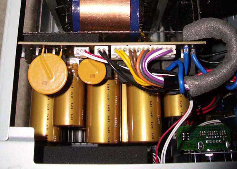

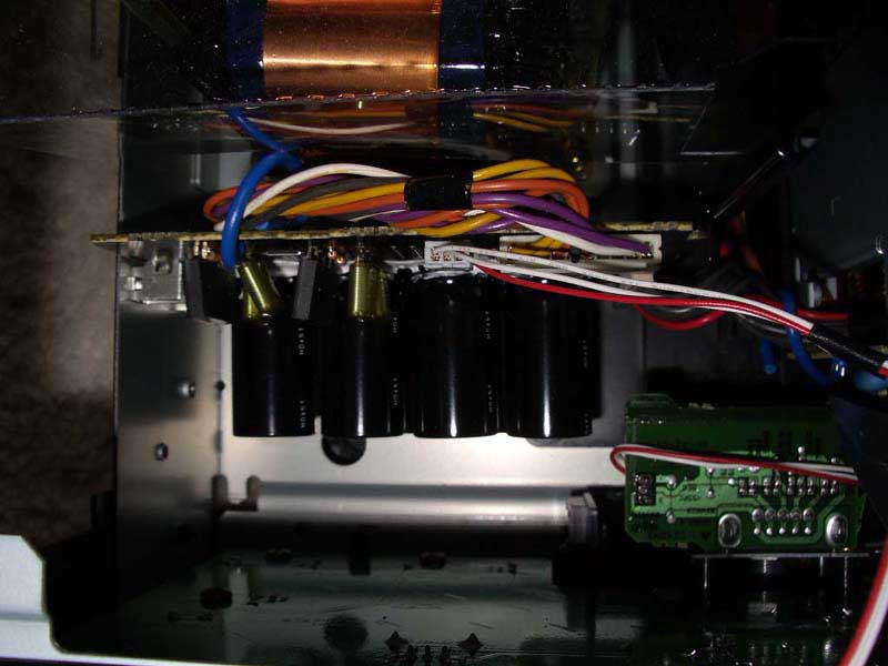

RX-V4600 preamplifier power section (left); RX-V2500 preamplifier power section (right)
Below the golden Nichicon capacitors of the RX-V4600 lies a heat sink about 3 inches in length which I could only guess its function is for additional regulation, power filtering, or to house additional op amp packages. There seems to be a great deal of attention in this section pertaining to component upgrades.

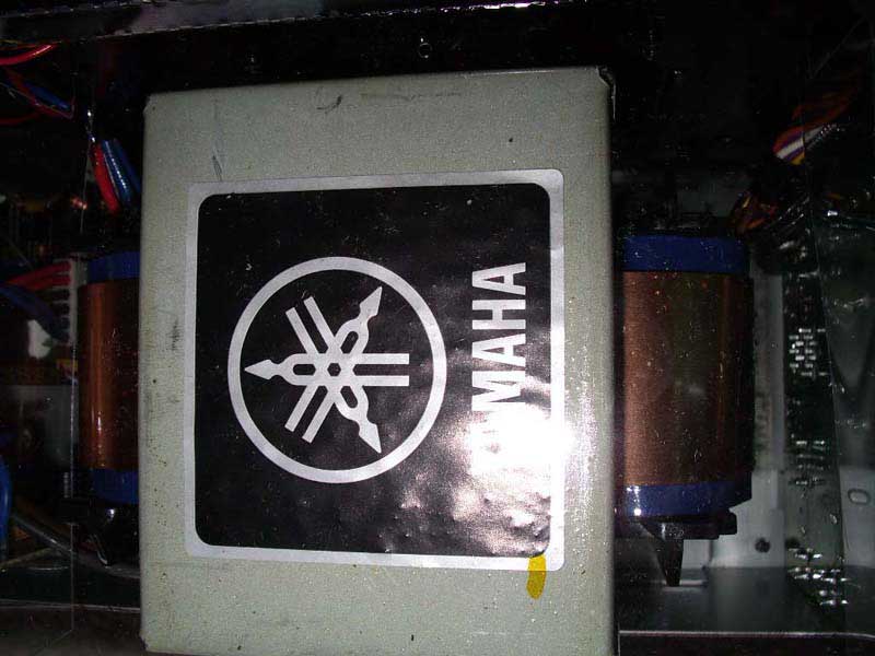

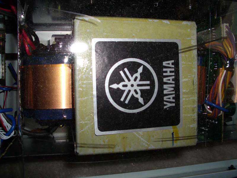

Yamaha RX-V4600 transformer (left); RX-V2500 transformer (right)
It’s hard to gauge the exact differences here, but the RX-V4600 power transformer is definitely a bit beefier than the RX-V2500.  It appears to have an additional 10-15% more volume and a slightly bigger core.  Without knowing VA ratings it’s hard to yield an accurate assessment but by the looks of it, the RX-V4600 would seem able to deliver more juice.

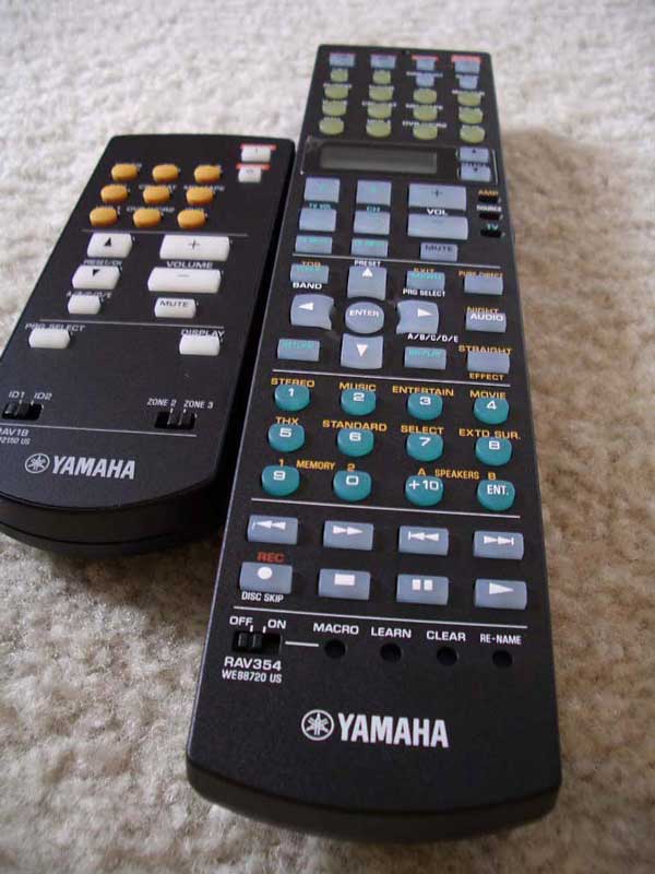

RXV4600Remotes
The main remote for the RX-V4600 is essentially the same as the one supplied for the RX-V2500.  However, the little companion remote (left) is an added goodie for controlling zones 2 & 3.

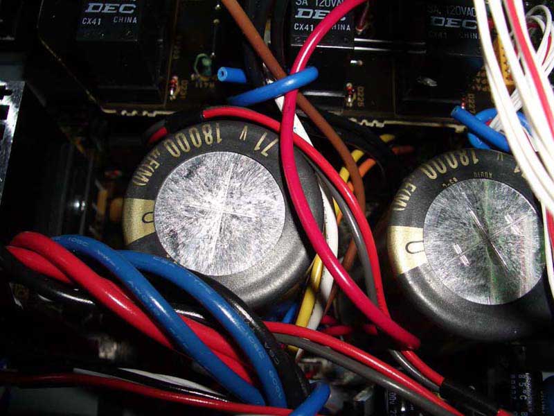

YamahaRXV4600caps2_lg.jpg   RXV2500Caps2
Yamaha RX-V4600 power supply capacitors (left); RX-V2500 capacitors (right)
The RX-V4600 has some distinct advantages over the RX-V2500 such as:
Power Supply
  • Upgraded power supply capacitors from 2 x 15,000uF; 71V to 2 x 18,000uF; 71V capacitors
  • Slightly larger Power transformer
