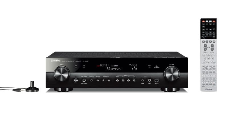

Sometimes it feels like there is a big disconnect between electronics manufacturers and furniture makers. Frankly, quite a few so-called A/V cabinets do a horrific job of actually accommodating equipment like A/V receivers, both in terms of providing a bit of extra breathing room as well as sufficient depth to comfortably run cabling. If that story sounds all too familiar, Yamaha's new RX-S600 slim-line receiver may offer you a bit of relief. Priced at $650 and measuring 17-1/8"W x 4-3/8"H x 12-5/8"D, the RX-S600 is a full-fledged 5.1 receiver that can go places where a full sized model would simply suffocate. Keep on reading to see how this small fry holds up to an at a glance look by the Audioholics.
Features, And Look, More Features

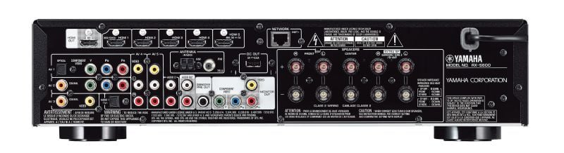

While the RX-S600 is of fairly compact dimensions, it would appear Yamaha has ensured that there is little lacking in its feature set. Connectivity is respectable, with a total 5 of HDMI inputs, four digital inputs (2 coaxial, 2 optical), a front panel USB port which can handle both portable audio players & memory sticks, a network port, and multiple legacy A/V inputs (2 component video, 4 composite video, 4 stereo analog audio). As you'd expect from Yamaha's latest, the RX-S600 supports Ultra-HD video pass-through, 3D video, and ARC; in addition, one of the HDMI ports is MHL compatible, meaning you can watch high definition video from a mobile device. And of course since this is a networking receiver, Yamaha has included niceties like Airplay and internet radio/streaming from Pandora and vTuner.
Aside from the latest features, the RX-S600 does include a few welcome practical touches. One thing that occasionally gets overlooked when attempting to cram as much on to a back panel as possible are the speaker connectors. In this case, Yamaha has delivered binding posts on all channels, and more importantly, they appear sufficiently well spaced to help avoid accidental short circuits. The RX-S600 also expectedly includes Yamaha's proprietary YPAO auto-setup & calibration routine, which is a useful convenience. Also in a nod to convenience, the Yamaha comes with a control application compatible with iOS, Android, and Kindle Fire devices. Last but not least in Yamaha's bag of tricks, the RX-S600 sports an ECO mode which is claimed to reduce power consumption by roughly 20%.
Rear panel of the Yamaha RX-S600.
