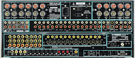

Yamaha RX-Z9 Back Panel
All speaker terminal posts sport WBT binding posts (a nice touch typically found on more expensive amplifiers). Six component video inputs and two outputs featuring digital video up conversion with OSD, along with a host of s-video and composite video connections, ensure almost all of your latest video gear is covered. However, with a back panel this well equipped, I wonder where Yamaha will find the space to accommodate a next generation product with DVI / or HDMI switching? For now you will have to directly connect your DVI enabled gear to your Display. The RX-Z9 comes with a detachable power cord and two switched outlets for your power connection needs. It supports 7CH EXT multi-channel analog Inputs, four digital coaxial (1 with RF Demodulator) and eight toslink inputs and three toslink outputs, i.Link, to ensure all the latest and future audio formats are covered. The Yamaha RX-Z9 comes with all the fixings that currently none of its Separates competitors and only a handful of super receivers offer such as:

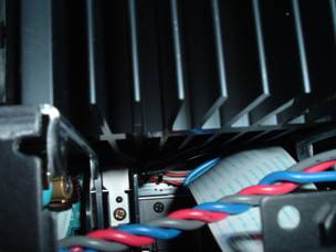

I do have reservations about how Yamaha chose to arrange the heatsinks of the power amp sections on the RX-Z9. The issue of comparing heatsinks vertically mounted on the sides of a unit vs. heatsinks mounted horizontally on the top of a unit is a little complicated, but I will do my best to assess the differences here. First, a few formulas. In general, for an object being cooled by natural convection:
Delta T = Q/(h-sub-c * A) [1]
where delta T is the temperature rise, Q is power dissipated, h-sub-c is the heat transfer coefficient and A is the surface area of the object.
Not depicted here, there are dual fans on the bottom side of the chassis that help force convection during high power demands. In my listening tests these fans only came on after pounding the RX-Z9 amps in extremely loud multi-channel DVD-A listening sessions for extended periods of time.
When you have a plate oriented vertically (like a heat sink),
h-sub-c = 0.29 * [(delta T)/L]^0.25 [2];
where L is the length of the item in the vertical direction. So according to the first formula, the higher your heat transfer coefficient, the less your temperature rise will be. According to the second formula, the less the length of your object in the vertical direction, the higher its heat transfer coefficient will be.
But, wait! The fins on top of the RX-Z9 have a shorter length in the vertical direction than the fins of alternatively vertically side mounted heatsinks of other receivers and should therefore, be more efficient. According to the math, it is true. But you have to think about the airflow. Heat rises. So when the air rises past heat sink fins of the vertically side mounted heatsinks, the air below the fins rises to fill the void and the process continues. This is why it is called natural convection; you will get a flow of air without any mechanical effort. Now think about the horizontally top mounted heatsinks of the RX-Z9. When the warm air tries to rise off these fins, cool air can't replace it nearly as easily. Air can't rise from below to fill the voids between the fins like it can in the vertically side mounted heatsinks. It can only trickle in from the perimeter of the unit. Actually, if you ran a computer model, you would find that towards the center of the top of the RX-Z9, the fins will be contributing almost nothing. It is almost like they aren't even there because they are so starved for air. It a nutshell, that is the difference between the two. This does explain why the Yamaha RX-Z9 runs significantly hotter than any receiver I have ever had the pleasure of reviewing, even during idle. Unfortunately the heatsinking topology employed by Yamaha is externally starved for naturally-convected cooling air and I highly recommend the user and/or customer installer be cognizant of this to allow plenty of air flow and perhaps forced air cooling if necessary.

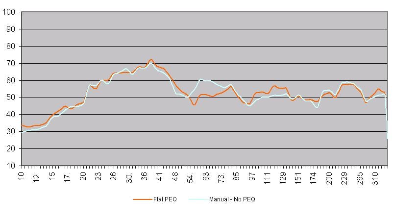

Yamaha really earned some brownie points with me by offering dual subwoofer outputs with your choice of mono, stereo, or front & rear. What was even more impressive was that each subwoofer output had independent channel trim, delay and phase settings. One thing I learned well from my HAA training was how critical it is to compensate for path differences between multiple subwoofer systems and the primary listening area.
More often the case than not, physically constraints force the installer to place the sub(s) within certain room locations. If they choose locations where the path differences between the two subs are ½ the wavelength of a particular frequency band within the pass band of the subwoofers, then those frequencies will cancel at the listener which can be measured by a dramatic dip in audible response within that range.
Fear not, for the RX-Z9 does allow for path difference compensation, at least laterally, helping minimize this problem in multi-subwoofer system installations. It is also important that independent level control compensation for each sub is built into the RX-Z9's bass management. Speaking of the RX-Z9's bass management, I was pleased to find a variable crossover, a Yamaha first to be incorporated into their flagship receivers.
RX-Z9 Variable Crossover Settings |
40Hz to 80Hz with 20Hz stepsizes |
90Hz to 120Hz with 10Hz stepsizes |
160Hz to 200Hz with 40Hz stepsizes |
For years I have been bugging Yamaha to offer variable crossover settings on their receivers (at least on their flagships). Ironically when they finally started doing this, I upgraded to a speaker system that works best with a high crossover setting.
The internal 1/6th octave bass test tone from 35Hz to 250Hz included in former Yamaha flagships such as the DSPA1, RX-V1, and RX-Z1 were absent this time around. It was a shame because this great feature, rarely found on most costly dedicated processors, let alone receivers, helped me to identify bass phasing problems in my early days when I lacked the test gear to measure it or was too lazy to root it out listening to music. In any event, the variable crossover setting, independent group delay and level control for the subs, and subwoofer pairing assignability more than makes up for this minor feature loss.
Manually setting the channel trims on the RX-Z9 proved to be a bit more challenging than my former experiences with other Yamaha receivers. Simply pressing the "Test Tones" button unveiled an assortment of speaker options where the pink noise would temporarily engage on each speaker before toggling to its associated grouping. You can also select for the pink noise to toggle through all of the speakers in the set-up. The problem I had initially was that the test tones only played on each particular speaker for about three seconds, thus not giving my SPL meter enough time to settle for an accurate measured response. I was later pleased to find that holding down the "enter" key for a few seconds locked the particular channel on which the pink noise was being played so you could have time to adjust with more precision.
I was a bit disappointed that the RX-Z9 had only one provisioned global channel trim setting. This was especially alarming since even the RX-V2400 and former flagship RX-Z1 incorporated independent channel trim settings for the EXT analog inputs. This is particularly important when playing high resolution formats such as DVD-A/SACD for compensating for subwoofer level output differences. However, after a bit of experimenting with the RX-Z9, I found that the EXT subwoofer analog inputs of the RX-Z9 were internally compensated (this was not documented in the user manual), but apparently only if you engage the "pure direct" mode (which one should do anyways to eliminate an extra processor conversion stage and preserve signal resolution.) I was able to balance the system reasonably well by also tweaking the channel trims in my Denon DVD-5900 Universal DVD player.

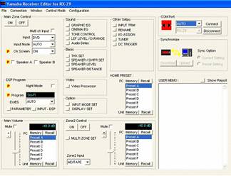

Yamaha Receiver Editor Software Feature![clip_image002temp_002_002.jpg](clip_image002temp_002_002.jpg/image_mini)
Another selling point and unique identifying feature of the RX-Z9 is its bi-directional RS-232 interface and receiver editor feature allowing the user, or more commonly, the custom installer to set-up, configure, and retain programmable settings on a computer in the event of memory failure or accidental user erasure/modification of settings. This feature is intended to be used by the custom installer, or a highly experienced user who desires to save all of the major configuration settings of the RX-Z9 (except YPAO settings) after the receiver has been fully set-up. The installer can also preconfigure the RX-Z9 with common settings prior to ever actually operating the unit, or customize bass management and level settings for different operational modes (IE. DVD-A, DD /DTS, 2CH,etc).

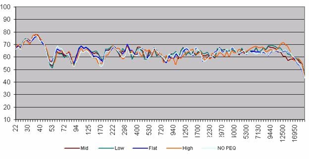

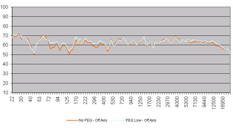

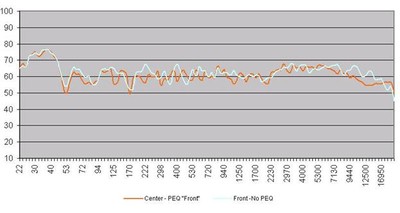

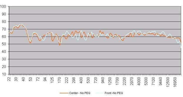

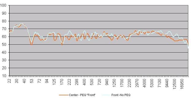

Yamaha RX-Z9 Auto Set-Up and YPAO Configuration
What good would Yamaha be if their latest technological achievement in receivers didn't explore the latest fashionable craze in automatic setup and room correction? Only a few years ago it was difficult to affordably acquire the processing power to take on such a feat. Today, Yamaha is implementing this on mid-fi level receivers starting at only $600. As I learned during my review of the RX-V2400 , these type of systems are far from being infallible and leave much to be desired.
However, they do have merit for users who don't want to spend hours fussing with the setup configuration and tweaking of their systems and instead opt for a quick one-button solution to give them reasonably accurate results - and more importantly sound output from all channels.
However, I caution all users of such systems to take the time, and evaluate how your system ends up being configured to determine if the results make sense for your particular set-up and listening preferences. This is especially important when considering how the PEQ or equivalent auto room equalizer tailors the response of your speakers to achieve what it believes to be the flattest or most accurate frequency response.
I began as instructed in Yamaha's rather lengthy, but easily digestible, Users Manual. I placed the supplied microphone (which appeared to be a beefed up version of the one found on the RX-V2400) at the primary listening position of my home theater room and engaged the "Auto Set-Up" feature.
Wiring Check
The RX-Z9 had no problems passing the wiring check for my system. However, I caution installers to interpret negative results with a grain of salt. Complexity of room dynamics and/or some loudspeakers unique crossover/driver arrangements, can trick this system into reporting speakers as being wired out of phase when in fact they are not. If it should report any of your speakers are out of phase, first check the wiring and then use the Avia or equivalent home theater set-up disc, to audibly confirm the proper phase of each channel. This is a good measure to practice on any home theater install regardless if the device has the built in ability to check it for you or not.
Distance Check
The auto set-up did a commendable job at setting the distances of each speaker from my listening position, except the subwoofers. Yamaha informed me that it is accurate within 1/10 th of a foot, and user adjustable is 1/10 th ft step sizes. This is more accuracy that is needed in home theater and certainly more precision than found in many higher priced exotic processors. Automatically detecting subwoofer distances is a challenge given the large wavelengths in question and the complexity of room dynamics. I recommend using the RX-Z9's distance checker to properly set all nine speakers in the system, and tweak the subwoofer distances if needed. Having this feature proved very useful in setting my speaker distances, especially those front effect channels that were out of reach for me to measure manually.
Size Check
Based on my
experience with the RX-V2400, I was a bit concerned that the RX-Z9 would have the same problems
identifying the size of my speakers. However, to my surprise, the RX-Z9 correctly identified all of my
speakers as "small" the first couple of times I tested this feature. This was good news as it correctly
diverted the bass from all channels to my dedicated subwoofers for proper bass integration and
preservation of system dynamics both for the loudspeakers (avoid them trying to produce frequencies
they aren't capable of producing) and amplifier power. However, moving the microphone a few feet back
from my listening position yielded different results. By repositioning the microphone back just a few
feet from my listening position, I achieved completely different, and in my opinion, unpalatable
results. The Auto setup now identified all of my speakers as small except for my surrounds. It also set
the crossover way too high at 200Hz. I believe the microphone was being duped into thinking my rear
speakers were large because of boundary gain effects of my rear speakers due to close proximity to the
rear walls. Incidentally, after the first time the RX-Z9 identified my rear speakers as "large", it

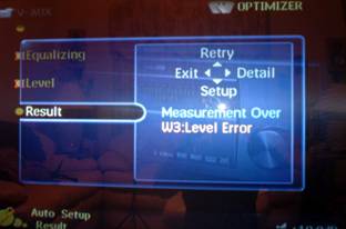

Yamaha RX-Z9 Auto Setup: Setting & Checking Levels
The level check was the last auto test set-up feature that the RX-Z9 performed. This test absolutely required a quite room to properly perform. My ceiling fan actually caused it to give me an error message "Noisy". After I controlled the noise floor in my room, I reran the level check portion of YPAO. Unfortunately the RX-Z9 failed this test when it got to my subwoofers.
After I pondered on this for awhile, I believe I figured out the problem. My room has a
pretty nasty bass peak at around 30-40Hz. The RX-Z9 likely measured this and interpreted it as my
subwoofers being set too loud. Since it couldn't compensate for this it attempted to lower the
subwoofer levels to its limits (-10dB) via the subwoofer level trims. Apparently this was not enough
and hence the error message. In reality, if I were to take the advice of YPAO on determining my
subwoofer levels, I would have near flat bass at my room peak, and a bass void for the rest of the
audible spectrum -
a listening configuration that both myself and most listeners would loath.

Yamaha RX-Z9 YPAO & PEQ Measurements and Analysis
All of the following measurements were conducted using 1/12th octave FFT analysis. I measured the effectiveness of YPAO's integrated PEQ in all of its settings for the front channels at the listening position as well as how it affected bass response, and center channel to front channel tonal matching.
Mid, Low, Flat and High PEQ Settings for YPAO
Front PEQ Setting for YPAO
With no equalization applied, you can see that the center channel of my system (which is basically a horizontally placed version of my main system speakers (without the subwoofers), measured similarly to the summed response of my main speakers at the listening position. This measurement was taken with the RX-Z9 engaged in "Prologic IIx" mode for the center channel measurement, and "2 Channel" mode for the Front channel measurement.
Flat Setting:
Flat yielded an EQ result very similar to no PEQ at all for my set-up. It inserted a slight bump of +3dB from 100-125Hz and helped to reduce a narrow null centered around 160Hz. Aside from a +4dB bump added by the PEQ at 315Hz, most of the upper end of the frequency spectrum was unaltered. This partly explained why I was hearing a slightly fuller sound in the mid bass region.
Low Setting:
From 56Hz-80Hz PEQ reduced a bass bump by about 4dB. As with the "Flat" setting, it inserted a slight bump of +3dB from 100-125Hz and helped to reduce a narrow null centered around 160Hz. A similar +4dB bump was added by the PEQ at 315Hz. PEQ smoothed out a slight null from 1700Hz to 2100Hz by adding a +4dB boost. PEQ added an unnecessary +4dB of gain from 8kHz to 11.8kHz. PEQ did improve frequency extension by adding +3-5dB of gain from 16kHz to 20kHz, extending the 3dB point of my system from the listening position from about 18-20kHz. This was my favorite sounding setting for PEQ.
Mid Setting:
PEQ gave a rather ragged response from 265Hz-760Hz. However, it also inserted a slight bump of +3dB from 100-125Hz and helped to reduce a narrow null centered around 160Hz. PEQ squashed the lower treble by -5dB from 12kHz-17kHz. This setting was too forward sounding with too much emphasis on upper bass, yielding a very chesty sound in male vocals.
High Setting:
The high setting almost mimicked the flat setting up until about 5.6kHz. It added +5dB bump from 5.6kHz to 8kHz and 11kHz to 15kHz while also extended the 3dB point of the system as in the Low setting. This setting was too lispy, bright and almost compressed sounding.
Front Setting:
The PEQ "Front" settings purpose is to tonally match all speakers to the un-equalized front speakers. It appeared to do fairly well from about 170Hz to 2.2kHz, but caused a sharp roll off above 7kHz that was clearly measurable and audible in my listening tests. In fact, the center channel output vs the summed front speakers was now too low by almost 10dB from 9.4kHz to 12kHz.
A Note About the YPAO Measurements
It is important to note that some of the graphs in these measurements for the same PEQ settings varied slightly because they were recorded at separate sessions where the microphone position may have been slightly different, or the PEQ Auto measurement resulted in a different overall response. These measurements only illustrate frequency domain effects and are not fully representative of all of the variables attributed to the sonic differences between PEQ and no PEQ.
Low PEQ Setting On/Off Axis Comparison
I was curious to see how my favorite PEQ setting, "Low", would
transform the sound of my front speakers when measuring their response
far off axis from where the microphone actually took the initial
measurement to derive its settings. I was pleased to find that the PEQ
did not butcher the frequency response in location measured away from
the initial calibration. In fact it did improve a bass null by +5dB in
the 70Hz to 80Hz region.
Low Frequency Comparison of Manual vs YPAO
By allowing YPAO to do my entire configuration, it did not provide the smoothest transition between the huge bass bump of my primary room mode. I was able to manually tweak phase and level of my two subwoofers to add a bump from 54Hz to about 75Hz to provide a more uniform and pleasing sounding system bass response.
