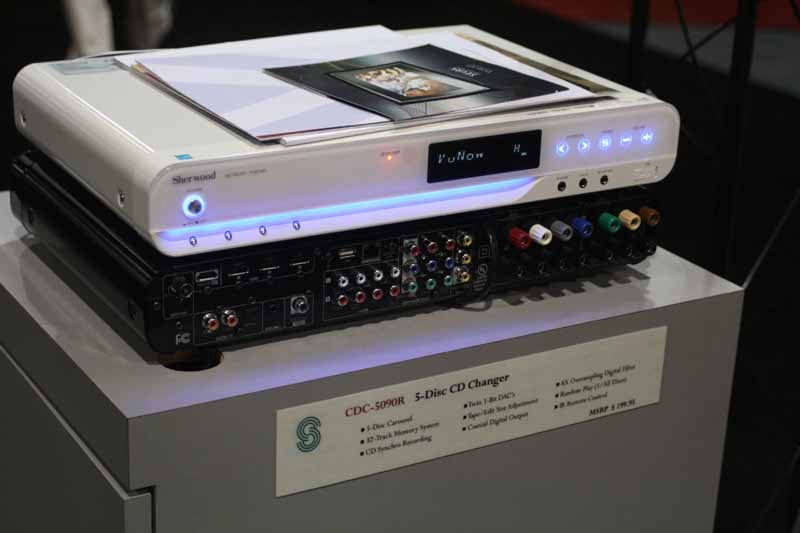

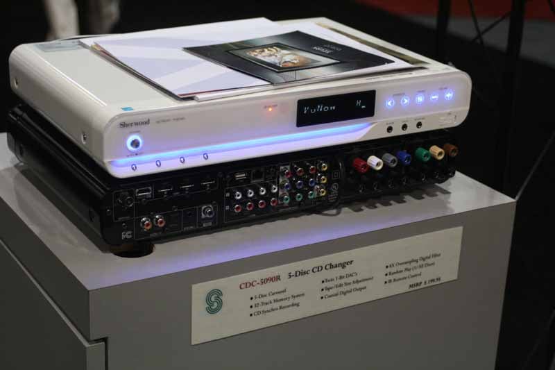

At a bit over 10 pounds and the height of many DVD players, the R-904n NetBoxx will fit in most any installation. The corners are rounded with a slightly offset front display. There are a few controls on the front but all are buttons instead of the traditional knobs. Also included on the front panel is a USB port under a rubber cover and Aux 3.5mm jack. Both of these are great for adding devices like MP3 players or other external storage mediums. One thing that is missing from the front of the unit is any sort of traditional input. We would have liked to have seen an HDMI port here for those with video cameras or other such devices.
peering through the brush
The major buttons glow blue when powered on along with the power button and a vanity light that looks to us like it might light up a bit too much. This vanity light illuminates the lower half of the unit for more than half the width of the receiver. While we appreciate the aesthetic value of the buttons, there is something to be said for the pure functionality of the volume knob. While not exactly a slam against the R-904n since most of the time the control will be via the remote, it does deserve a mention.

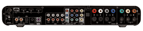

The back of the R-904N NetBoxx is really a lesson is space saving. We were really impressed that Sherwood was able not only to get as many connections as they did back there, but how well they laid them all out. On the right side of the back are all the 5-way binding posts for up to seven speakers. With this form factor you mostly expect a 5.1 offering so the extra two channels are definitely a check in the "Pro" column for the R-904n. From the left side you'll find a terrestrial antenna connection, 3/1 HDMI in/out, 2 coax and 1 optical digital audio inputs, a DegiLink input, and a subwoofer pre-out. There is a second USB port as well as a LAN connection. Four analogue stereo inputs are available as well as two Component and two Composite video. There both Component and Composite video outputs. From an input/output standpoint, very little has be left out of the R-904n.
R904_l_back
Now that you have everything hooked up, what do you have? Well, according to Sherwood, 700 watts of power - according to the specs measured 110W x 7 (1kHz, THD 1%)@6Ω / 1 Channel which is code for "just fine with 8 ohm speakers but don't push it too hard." What we liked was that you can use the surround back channels for a second zone. In a receiver with this form factor, you wouldn't expect Zone 2 support. Also included is an auto calibration program and mic, Dolby Volume, and native decoding of all the current audio formats. Missing was any sort of video upconversion. We're not just talking about upconversion and scaling to 1080p, but converting from component to HDMI. So if you have an component video input, you'll have to run a component cable to your display.

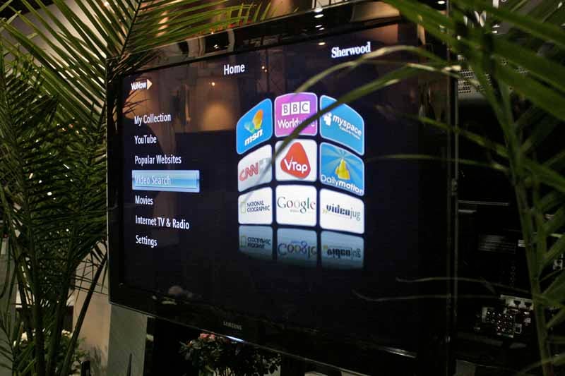

What, of course, is the claim to fame of the R-904n NetBoxx is it's streaming ability. First you can stream content from the USB interface. There is an Ethernet port for a wired connection but Sherwood also includes a 802.11g adapter. This gets you on your home network so that you can stream content from connected computers or the Internet.
Sherwood certainly has gotten the form-factor right with the R-904n NetBoxx. While the lights might be a little overdone, the aesthetics and size seem to be on point. The receiver functions all seem there with Dolby Volume, used to keep the volume constant, adding a pretty important benefit. We could really see this unit fitting right in a family room in a contemporary setting. While the streaming ability is pretty cool, we're not sure it adds as much as no video conversion takes away. Still, if all your devices are HDMI, maybe it won't be an issue. With a wireless connection, the network content becomes much more attractive. For those looking for a small box, bright lights, and streaming with the ability to expand to a second zone, the Sherwood R-904n NetBoxx might be the solution.
