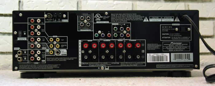

                            Connection types include composite video, component video (2 in, 1 out), one optical, and two coax
                            digital connections. The digital connections are assignable to whichever input you'd like. The
                            5.1 inputs are a bit confusing as you have to connect the mains over on the left with the rest of the
                            inputs while the rest of the speakers are connected closer to the center of the unit. This could create
                            a problem for people that invested in a six cable bundle as the separation might be too great.
                            Noticeably absent (but not missed) were the s-video inputs. DVI and HDMI were nowhere to be found (and
                            won't be at the price). The unit has 5.1 pre-outs if you want to use outboard amps. The unit has
                            this funky valley running horizontally across the front of the unit that made everyone think it was two
                            components sitting on top of each other. I didn't find anyone (myself included) that really
                            thought it was that attractive of a unit.

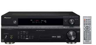

 Pioneer provides the VSX-516 with a remote
                              that is small, light, non back-lit, and fits well between the cushions of your favorite couch.
                              Square, ugly, and nearly impossible to use in the dark without memorizing locations and counting the
                              number of buttons as you run your thumb down the face, its one redeeming quality is that volume
                              control is in a different shape from everything else on the remote. This makes the one job you are
                              most likely to use in the dark the only one you can reliably find. Volume is controlled in 1 dB
                              increments, not that you can see the display, because you can't.
