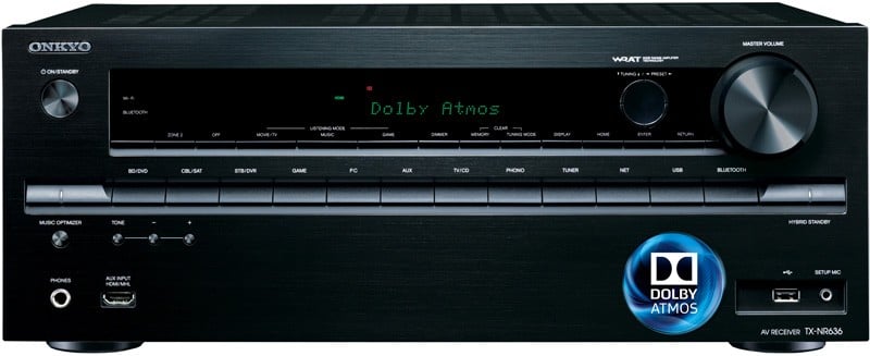

Onkyo TX-NR636

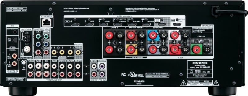

Priced at $699, Onkyo’s least costly Atmos-ready receiver packs a lot of goodies for the price including 7.2 channels of audio, 95W of power with 2 channels driven, integrated WiFi and Bluetooth for wireless streaming, 7 HDMI inputs plus two outputs, and a phono input for those with a vinyl collection. Not good enough for you? The TX-NR636 also features video upscaling up to 4K resolution, as well as Zone 2 capability (both powered and line out). In short, the TX-NR636 delivers almost everything you could ask for from a mid-priced A/V receiver.
Onkyo has the only Dolby Atmos AV receiver at the $700 price point, but there are caveats.
Only one question remains: what kind of Atmos experience can you get for $699? As mentioned earlier, the TX-NR636 is a 7.2 channel receiver. What this means with respect to Atmos is that a single configuration is supported: 5.2.2. Unlike costlier receivers that can support 9 or more channels, the TX-NR636 can only support a pair of height channels. As such, it can’t deliver the same 360 degree dome of sound you can achieve with a 5.1.4 or 7.1.4 setup running on Onkyo’s higher end models.
TX-NR636 TX-NR636 Rear

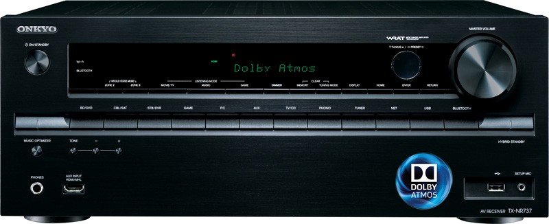

Moving up the model line to the TX-NR737 will set you back $899, which begs the question: what do you get for an extra $200? In short, more power. The TX-NR737 bumps up the power rating from 95W/channel to 110W/channel (2 channels driven), which amounts to less than a decibel of additional output capability. While that’s not much to write home about, the TX-NR737 is also certified for 4 ohm performance, which is helpful for those with low impedance speakers. Other than that, the only other noteworthy item is that the TX-NR737 is THX Select2 Plus certified; we’d wager the licensing fees for the certification account for a fair chunk of the price hike from the TX-NR636.
TX-NR737 TX-NR737 Rear

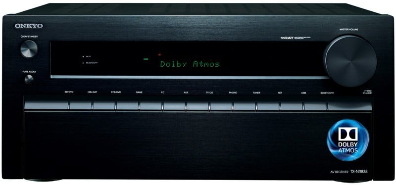

Onkyo TX-NR838

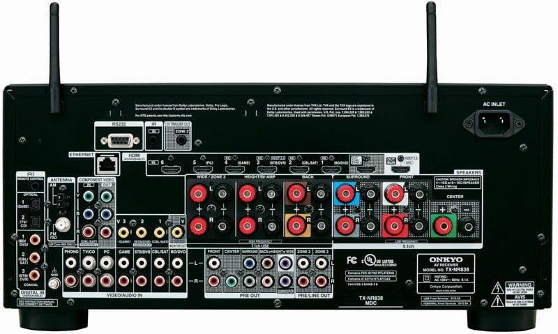

With an MSRP of $1,199, the TX-NR838 represents useful bump in overall abilities relative to its less costly siblings. Power again gets a marginal increase, now up to 130W/channel. More importantly, TX-NR838 is also blessed with a full complement of preamplifier outs, meaning you can attach an external amplifier if you want even more juice on tap. Things also get more interesting in the multi-zone department. The TX-NR838 can assign its second HDMI output to Zone 2, and it also offers line outputs for a third zone of audio. What’s more, the line-level zone outputs can be fixed level to feed another receiver, or variable to feed an external amplifier.
TX-NR838 TX-NR838 Rear

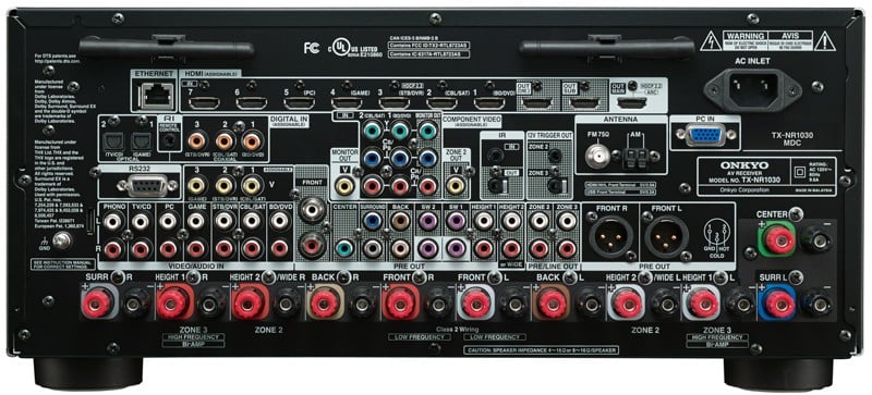

Onkyo TX-NR1030

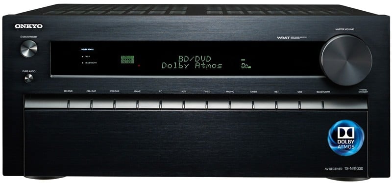

At $1,699, the TX-NR1030 represents the biggest price hike over a lesser model we’ve seen yet. However, as far as Atmos is concerned, this is where the rubber meets the road.  The TX-NR1030 weighs a whopping 11lbs heavier than its 838 sibling meaning it's got a beefier power supply to pump out more power.  Where the previous models we’ve looked at have all been limited to 7.2, the TX-NR1030 is a 9.2 channel receiver with pre-outs for 11.4 channels of audio. As you might guess, this means you can build up to a 7.4.4 system, allowing for a complete Atmos-in-the-home experience. Beyond the potential for Atmos, the TX-NR1030 boasts ISF certified calibration controls, which is useful for custom installations. On the connectivity side, there's an additional HDMI input and output, bumping the count to 8 and 3 respectively, as well as a pair of balanced preamp outputs. Last and most certainly least, there is a token increase in power, up to 135W/channel.
TX-NR1030 TX-NR1030 Rear

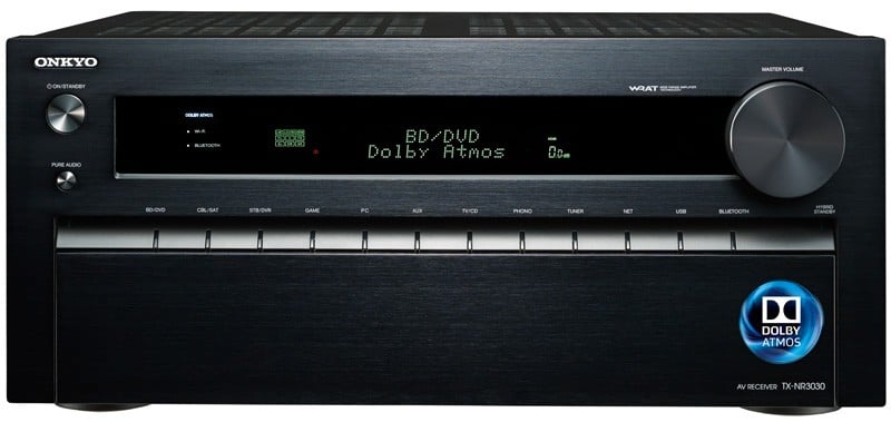

Onkyo TX-NR3030

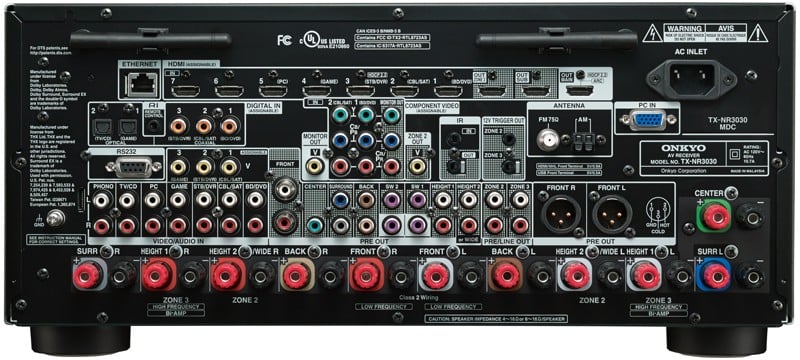

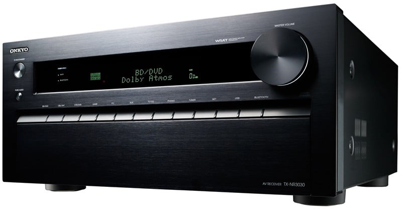

Capping the range at $2,399, the Onkyo TX-NR3030 boasts 11 channels of amplification as well as upgraded DACs over the TX-NR1030….and not much else. Yes, technically there’s another 12V trigger output for Zone 3, and a composite video output for Zone 2 (just in case you have a 20 year old TV that doesn’t support HDMI…), but we’re not convinced that those are big reasons to spend an extra $700 on an A/V receiver. Given that price premium, we’d just assume purchase the TX-NR1030 and spend a few bucks on an external amp like the Emotiva XPA-3. This way, you can still appreciate a 7.x.4 Atmos experience, not to mention get a serious boost in power for the front three channels where its needed most.
TX-NR3030 TX-NR3030 Rear
