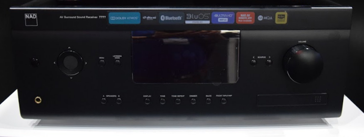

While we were at CEDIA in San Diego, California we got a chance to stop by and see the newest products at NAD Audio. We usually have a hard time deciding what to feature for NAD since they release a slew of awesome products each year at the trade show. This year was no different in the number of new products, but picking the one to feature was easy. They showered us their T 777 V3 which features a robust seven-channel amplifier that delivers 140 watts into 8 ohms (2CH driven) or 80 watts/ch (All Channels Driven) and is packed with the latest audio and video technologies. The NAD T 777 V3 supports Dolby Atmos and 4K UltraHD video pass-through. Their new AV receiver hosts a wide array of connections for excellent flexibility and MDC slots allow for further feature expansion and future upgrades. All this combined with their wireless streaming and whole home audio option called BluOS makes for a monster of a receiver.
Upon closer look at the T 777 V3, we noticed the absence of DTS:X support. We are hoping there will be a future upgrade path to DTS:X immersive surround sound for this platform as it's one of the only current receivers on the market that doesn't support that format out of the box. That said, all the current features the T 777 V3 has combined with their wireless streaming and whole home audio option called BluOS makes for a monster of a receiver.

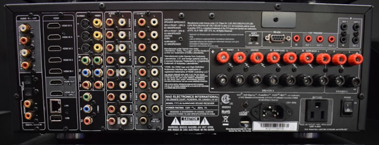

The T 777 V3 boasts six HDMI 2.0 inputs and two outputs, plus digital coaxial and optical in/outs. The T 777 V3 should be right at "Home" for custom integrators and smart homes. Their BluOS streaming software even can be integrated into your existing home automation systems from Control4, Crestron, URC, and RTI. Other connection options include IP control, IR outputs, programmable 12V triggers, and RS-232 port.
