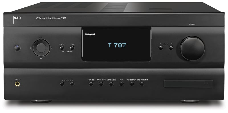

The last time we've written a preview article about a NAD modular receiver, we didn't have a lot of information available to ascertain exactly what features and upgrades would be offered. With the release of the company flagship T 787 A/V receiver, NAD has been more forthcoming in their press releases.

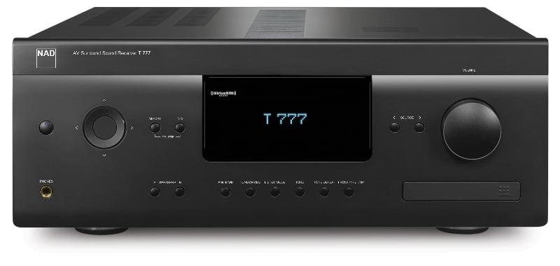

NAD's two new upper echelon receivers, the T 787 and the T 777 are built with serious audio quality in mind. This means that they not only carefully evaluate the components that create the sound and choose the ones that work best together, but also are concerned with they feature set and include only those that will enhance the audio and video performance.
T 777 Front T 777 Rear
To this end, the new offerings sport 24-bit/192kHz Burr Brown DACs and are fully compatible with all the newest HD audio codecs. In addition, they have included their proprietary EARS (Enhanced Ambiance Retrieval System) DSP which is a non-logic matrix surround mode. The amplifiers (200 watts per channel for the T 787, 140 watts per channel for the T 777, seven channels for each) and are stable into 4 ohms. With all channels driven over the full frequency bandwidth the T 787 will put out 120 watts per channel and the T 777 will provide 80 watts. With this rating, NAD differentiates themselves from many manufacturers which use less rigorous methods so that they can claim more power. In addition, the T 787 features dual power supplies - one for the front channels and the other for the center and surround channels. Lastly, there are two zones of audio (second zone can be output via RCA or powered) with nine pairs of speaker outputs for easy configuration switching. Tipping the scales at 55lbs (T 787) and 45lbs (T 777) it's easy to see that their heft is what makes them so powerful.

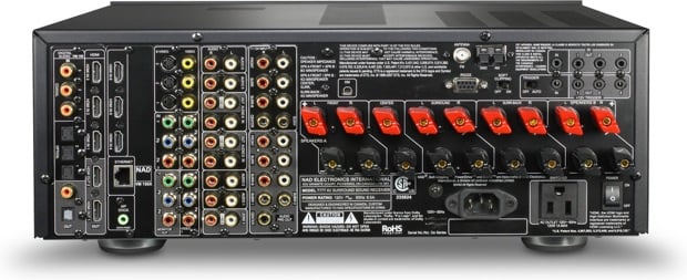

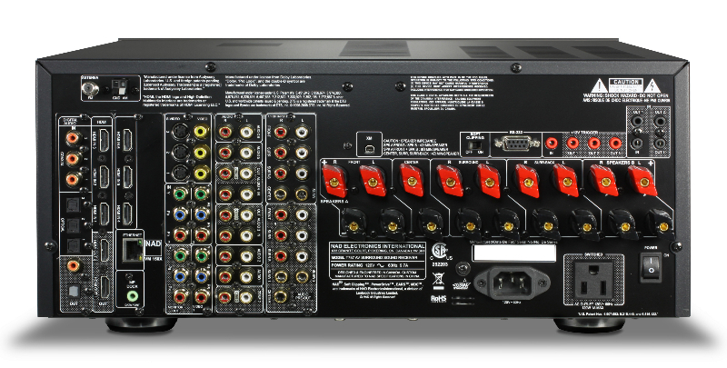

T 787 A/V Receiver Rear
Taking a look at the back, we see quite a bit of crowding. The HDMI inputs are stacked which, while technically not a problem, may make hooking up new components a pain. There are three each optical and coaxial digital audio inputs. There are 7.1 channel analogue inputs and 7.2 channel outputs. NAD is one of the few companies still supporting s-video inputs as well as composite video. Three component video inputs and one output tare included and the the T 787 will upconvert your analogue video sources to HDMI. The Ethernet port is not used for streaming content (NAD would prefer you buy their C 446 for that) but, instead, is used for IP control for custom installs. There are no USB ports, no phono input (odd omission considering the non-web-connected crowd likely to be interested in this receiver), no HD radio tuner, support for any of the height/width channels. Both the T 787 and T 777 sport Audyssey's MultEQ which should make setting up and calibrating your speakers much easier.
