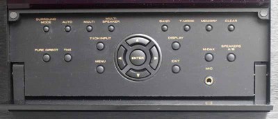

The front panel allows you to access Surround modes, Multi-room and Multi-speaker settings, radio functions and other features. Note that the Mic input is here for running the on-board Audyssey MultEQ system and you have direct access over the Setup menu and enabling A-B speakers. Marantz' M-DAX (Marantz Dynamic Audio eXpander) can also be turned on here, allowing you to expand MP3 and AAC-encoded files for a fuller sound and a recapturing of higher-frequency content.

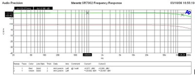

Frequency Response
SR7002 Frequency Response
Marantz SR7002 Frequency Response
The -3dB point for the SR7002 was around 125kHz at 1 watt and full power illustrating a very uniform power response which is to be expected with a receiver of this caliber.

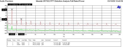

FFT Distortion Analysis
Marantz SR7002 FFT Distortion Analysis at Full Rated Power
At full rated power (110wpc, 8 ohms) the SR7002 exhibited very good distortion measurements (28.75+ 47.33)dBv =83.5dBv or 100*alog^-1(-76.1 /20) = .002 THD + N. These results (especially odd order harmonics) weren’t quite as low as I measured on similar priced Yamaha and Denon receivers but still good nonetheless.

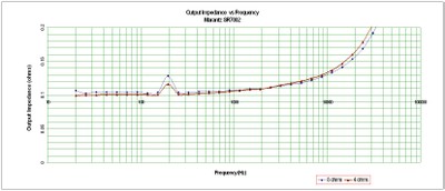

Marantz SR7002 Output Impedance vs Frequency
The SR7002 exhibited respectably low output impedance maintaining around 100mohms for the audible frequency range of 20Hz to 20kHz when driving 8-ohm and 4-ohm loads. This ensures that the amp will perform consistently under a wide variety of speaker loads.

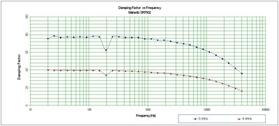

Marantz SR7002 Damping Factor vs Frequency
The SR7002, displayed a good damping factor which was not surprising based on the low output impedance the amp section exhibited. The damping factor for the SR7002 maintained above the minimum of 50 we like to see when driving an 8-ohm load and roughly 1/2 that (as it should) when driving 4 ohm loads.
