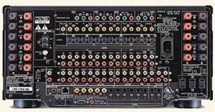

  • DDSC-Digital featuring New dual Analog Devices HammerHead SHARC 32-bit floating point DSP processors
  • 7 Channels equal power amplifier section
  • 170 watts per channel (8 ohms, 20 Hz-20 kHz, <.05%THD)
  • 200 watts per channel (6 ohms, 20 Hz-20 kHz, <.05%THD)
  • 24 bit, 192 kHz A/D conversion (Burr-Brown PCM-1804 x 4) on all analog inputs, including External 7.1 inputs
  • 16 Burr-Brown PCM-1738E 24-bit, 192-kHz highest resolution DACs, with DSD compatibility - each audio channel operating in differential mode
  • Pure Audio mode, features 4 DACs per audio channel in dual-differential mode
  • ALPHA 24 Processing Plus in Stereo/Direct/Pure Direct modes (left/right channels)
  • 4 24 bit,192 kHz Digital Interface Receivers
  • 3 sets component video inputs, compatible with wideband (480p, 720p, 1080i)
  • 8 sets composite and "S" video inputs
  • Video Conversion of Composite to S-Video and/or to Component
  • 1 AC-3 RF digital input for laser disc
  • TWO sets of 7.1 external wide bandwidth (100 kHz) inputs for multi-channel formats with full Bass Management(defeatable)
  • 11(5 Coax, 6 Opt.) assignable digital inputs
  • 8 Channel Digital External Inputs
  • 13 analog inputs including built-in AM/FM tuner
  • Multi-Zone 1 stereo pre-amp outputs with video output
  • Multi-Zone 2 outputs, pre-amp outputs or speaker outputs
  • RS-232C port for external controllers
  • 12 and 5 volt triggers
  • DENON Link, for connection to DVD-9000
  • Variable high/low pass Crossover 40/60/80/100/120

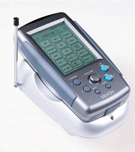

  • Audio Delay adjustment Digitally regulated volume control with .5dB increment adjustments AKTIS RC-8000 LCD touchpanel remote with IR and RF transmission Dimensions: 17.1"w x 8.5"h x 19.1"d
  • Benchmark performance in all modes of operation.
  • Endless configurability and tweaking options.
  • Excellent craftsmanship.
  • Component video up conversion on all video sources with OSD
  • Poorly written user manual.
  • Difficult set-up for neophyte.
  • Low current trigger output cannot drive many power relay boxes.
