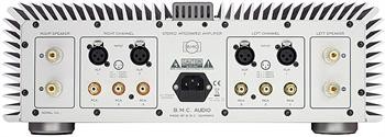

C1_rear
The Amplifier C1 has a very unique looking design if you've never seen a Marantz amp (which we're sure Marantz aped from someone else). The fins on the top (presumably used for passive cooling and to add weight) are distinctive and seem to sway toward the corners. There is a knob (or maybe a large button, we're not sure) on the left for power, one on the right for volume, a button on the left labeled "Dim" (probably to lower the output of the front display), and a button on the right for switching inputs. Overall, a very clean and distinctive look, something that audiophiles are often looking for in an audio product.
But that's not all. The BMC Amplifier C1 sports a cool running and silent operation design. The specification sheet indicates a "Massive" build quality which seems to translate into "Heavy" as the 17.1" x 15.9" x 5.9" (WxDxH) tips the scales at a staggering 88lbs. It has a balanced design from input to output and a DIGM volume system. DIGM (Digital Intelligent Gain Management) is a volume and amplification control that recalibrates the gain without dividing and downgrading the input signal. According to BMC, the DIGM is what replaces but pre-amp in the C1. Whatever you think about that, the most controversial BMC claim is about feedback: According to B.M.C., the C1 doesn't use any feedback in the signal path. What they most likely mean is that there is no global feedback from input to output. A properly designed feedback circuit is essential to any decent amplifier design.  Feedback improves gain and frequency response linearity while it also reduces sensitivity to parameter variations due to manufacturing or environment.  It always raises our eyebrows when an esoteric amplifier manufacturer claims to NOT employ any amplifier feedback into their design.  It's almost like a car manufacturer claiming they don't use rotors or brake calipers for any of the wheels.  Sure the car may go faster due to less frictional losses, but how useful is that when you actually want to stop the vehicle?

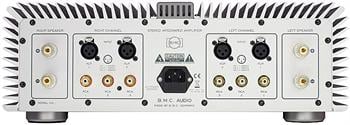

The Amp C1 delivers 200 watts into 8ohms, 350 watts into 4ohms using a 2-kilowatt toroid transformer. There are two balanced and three unbalanced inputs. Again BMC lives up to their name looking at the back of the C1. All the inputs on the left side in the picture above are for the right channel, the left side for the right. This means that for each of the inputs, the cables have to reach to both sides of the amp. Add to that, the inputs are a mirror image meaning that for the RCAs on the bottom it reads RCA1, RCA2, RCA3, then the power cord, RCA3, RCA2, RCA1. That's right, for RCA 1, you'll be plugging your gear in on the far sides of the C1. The XLR inputs are the same. Not the most intuitive design. There are matching gold plated binding posts for speaker connections.
