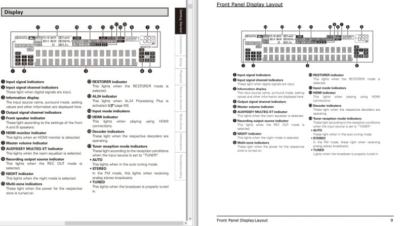

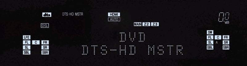

So, if Simaudio wasn’t getting the technology from Audyssey, where were they getting it from? A potential clue lies in the front display of the unit. The configuration of the symbols in the display bore a striking resemblance to products from another unaffiliated manufacturer: Denon.
The Simaudio Moon CP-8 Display
The Denon AVR-2808 Display

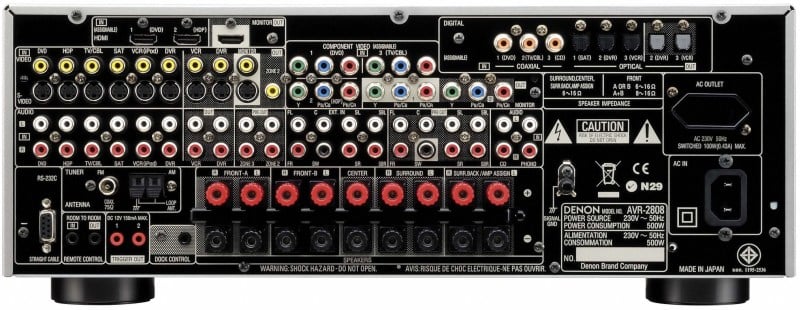

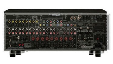

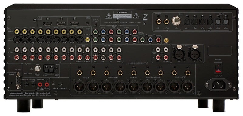

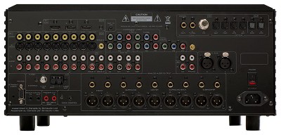

The similarities carried over to the back panel. Differences in the Simaudio from the Denon included an additional optical input and balanced pre-outs, but otherwise, the configurations were strikingly similar, from the analog inputs, right down to the “Dock Control.”
Simaudio Moon CP-8 Rear
Denon AVR-2808 Rear
The back panel of the Denon AVR-2808 vs the Simaudio Moon CP-8.  Notice the position of the analog inputs, trigger outs, and dock control.

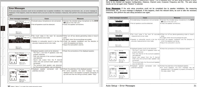

Even the accompanying literature revealed clues. While the Simaudio site did not currently have a downloadable manual for the CP-8, a version still linked at goodwinshighend.com.
(...seemed nearly identical to Denon’s own)
Denon AVR-2808 on the left, Simaudio Moon CP-8 on the right.

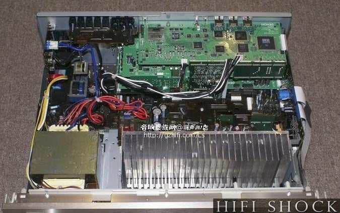

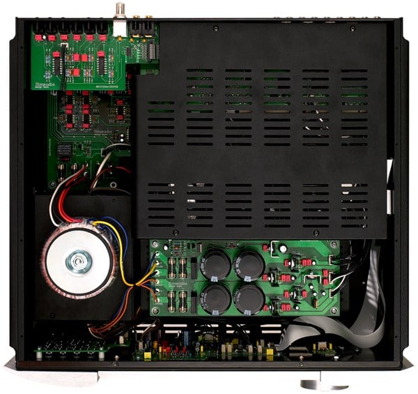

As for the inside of the unit, based on internet images, the power supply of the Simaudio is undoubtedly different, as are other details, though a metal shroud covers much of the internals.
Photo of the inside of a purported Denon AVR-2808 pulled from an internet image search.
Photo of the inside of a Simaudio Moon CP-8.
