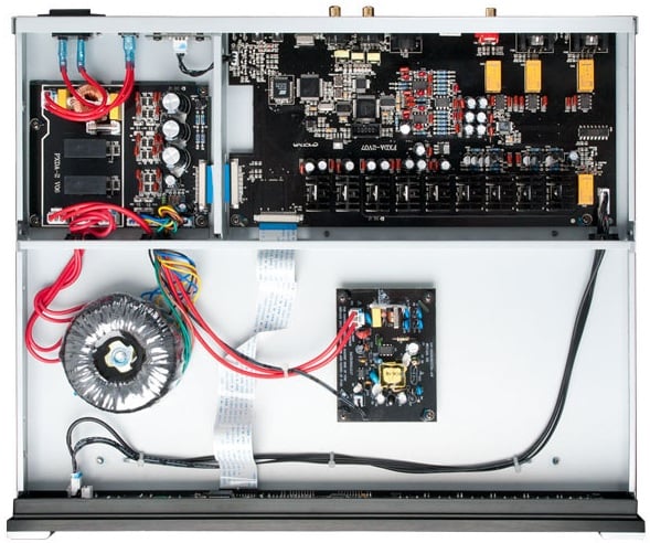

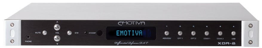

Emotiva Audio is looking to turn all that around with the XDA-2. The XDA-2 almost defies easy description as it does so much and yet it is still a very targeted product. First of all it it is an audiophile quality DAC (Digital to Analogue Converter). With full support for 24-bit/192kHz resolution for all inputs, including USB, it will have no problems handling all your high quality files. The XDA-2 has an Analog Devices AD1955 multi-bit delta-sigma DAC which delivers exceptional performance and superior audio quality. Sporting two coaxial digital audio, two optical digital audio, one USB, and one AES/EBU input, the has just about all your input needs covered.
xda2_rear

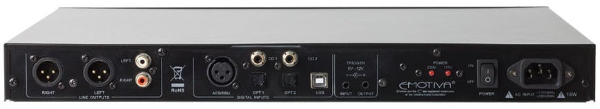

On the output side, Emotiva has included not only standard RCA unbalanced outputs for connection to an amplifier, but XLR balanced outputs for your higher quality amplifiers. Using Analog Devices AD1896 asynchronous sample rate converter (ASRC) provides almost total immunity to jitter. The analogue resistor ladder volume control is in .25dB steps and gives the XDA-2 the ability to be a digital preamp as well as a high quality DAC. With the large line of quality Emotiva amplifiers, it would be easy to put together a stereo listening system on the cheap. But where Emotiva has really changed the game is with the last functionality of XDA-2.
The XDA-2 is a high-current headphone amplifier with independent control and retention of main output level and headphone volume. The XDA-2 has a low-noise discrete design with 0.1-ohm output impedance. The headphone amp features a 105dB Signal to Noise Ratio (SNR) and will work well with sensitive headphones.
XDA2_top
There are many other audiophile features of the Emotiva XDA-2, like Emotiva's Differential Reference balanced design with OPA 2134 precision op amps, but what will most grab your attention is the price. At $399 (currently on sale for $349), this is the perfect office system. We can see this near you workstation feeding a couple high quality near-field monitors that are either self powered or with Emotiva's XPA-200 amplifier (150 watts x 2 channels into 8ohms). When there are people around (or your music dips into language inappropriate for an office environment), the XDA-2 steps in to power your high-end headphones. And when someone comes in and asks you what that box is with the pretty blue light? "Sonic bliss" should be response enough. Of course, it would be just at home in a stereo listening room for the Audioholic on a budget. Either way, Emotiva has brought a very interesting product to market with the XDA-2. We're betting it will be a hit.
