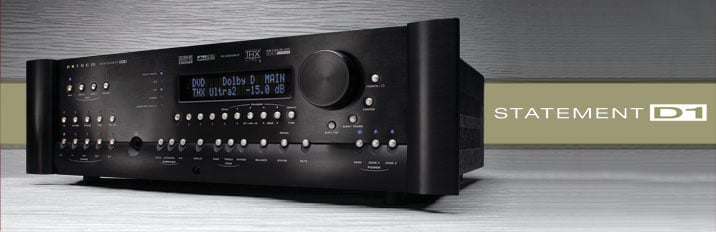

There is quite a buzz building about the Anthem / Sonic Frontiers latest addition to the Home Theater A/V SSP (Surround Sound Processor) world with their new $5000 Anthem Statement D1 SSP. Audioholics forums alone has experienced a good deal of activity about the Statement D1 with some even comparing it to the latest high end receivers and processors.
This mighty looking processor seems to have quite the build quality and aesthetic appeal that appears to be a step up from their previous products which included the AVM2, AVM20 and AVM30.
The Anthem D1 SSP has just hit the market and already there's a v1.02 software update indicating that Anthem is being very pro-active in solving some of the initial software issues. If you are a new owner of the Anthem D1 SSP, you can download the firmware updates here.

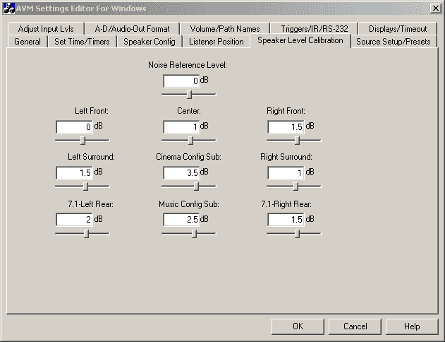

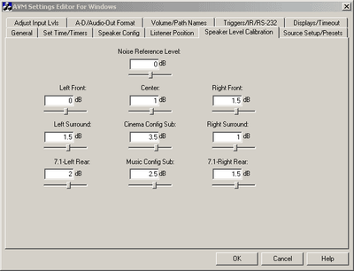

Anthem Settings Editor
Anthem Settings Editor for Windows
