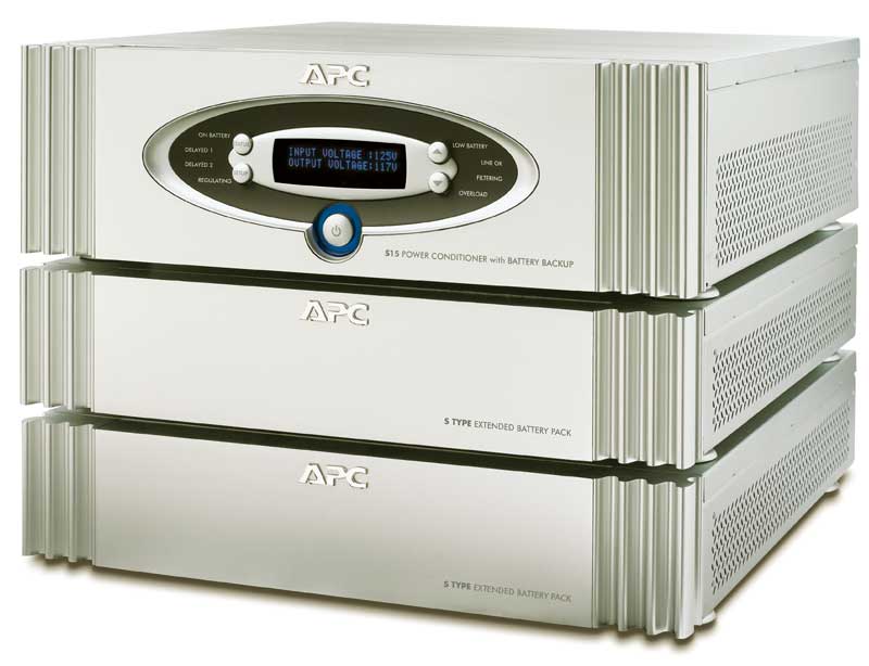

APCS15SBATT.jpgIf you look at specific APC AV offerings vs. specific competitive models in the high end AV market, the differences can be large and many. However, from a general overall standpoint, APC AV products can be said to differ from the competition in the following ways:
  1. APC products are ALWAYS designed to and carry the appropriate safety agency approvals required for the region the product is sold in. Not only that, but each product design must comply with over 100 APC internal design standards which actually surpass these agency approval standards.
  2. APC AV products clearly represent the best value in the market. No other product solves as many real world problems at anywhere near the same price points that APC AV products are offered at. Take the S Type Power Conditioner with Battery Backup, for example. To get the S Type's Pure sine wave battery backup, voltage regulation, isolated noise filtering and surge protection, you'd have to buy multiple competitive products and spend well over $2000 to get it.
  3. Although not a general difference, the fact the S Type battery backup was specifically designed from the ground up to be capable of powering high end Amplifiers and Subwoofers constitutes an important difference between us and other so-called AV UPS competitors. Amplifiers and subwoofers will often draw a tremendous amount of current on startup. This large in-rush current can damage or at the very least overload a traditional IT-style UPS. APC had to design the inverter of the S Type to handle these types of unique power draws.

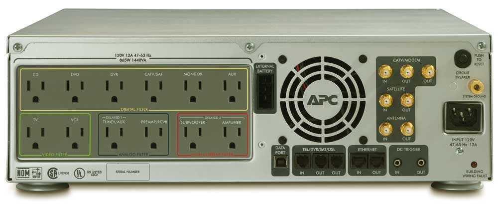

Why does the rear panel of the S15/H15 say 120V / 12A? Does this mean the power conditioner is fuse-protected not to deliver any more than 1,440W from the wall outlet?
APCS15back.jpgNo, as explained above the product is purposefully limiting the end user not to connect more than 12A of load to it. In reality, you could keep loading it until the internal circuit breaker (15A) trips, but that would be misuse. Again, we put ourselves at a competitive disadvantage by doing what is right. Our competition allows the customer to load up to 15A while we limit the customer to only 12A. It is important to understand that this 12A refers to steady state and the unit can source in excess of 30A short-term to handle large inrush currents drawn by professional-grade A/V equipment. APC specifically tests for this by repeatedly cold starting high power A/V equipment well over 6,000 times. In one case the limit on the test was the fact that the amplifier used broke because it could not handle that many starts and stops, but the S type power conditioner kept on running.
