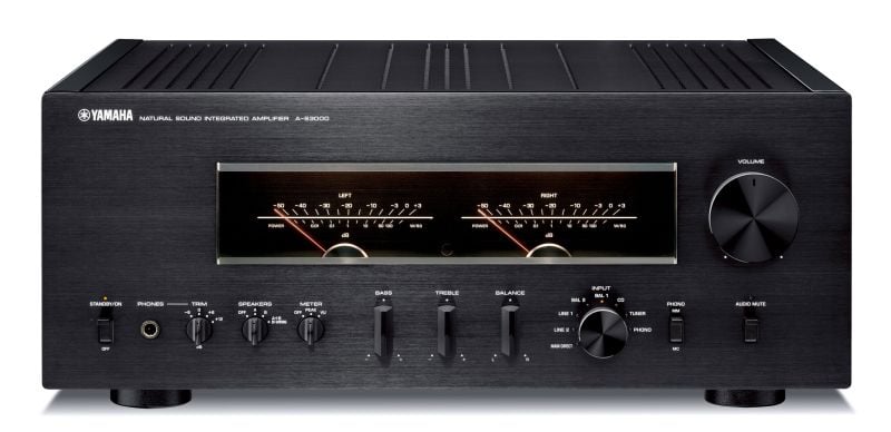

As you might guess from the high end price tag, the Yamaha A-S3000 doesn't skimp on fit and finish or build quality. The overbuilt chassis includes double construction, i.e. a chassis within a chassis, which allows for neater and more direct routing of internal cabling, a solid 0.28" thick aluminum front panel and 0.24" thick aluminum top panel, and a three-dimensional copper inner frame to minimize vibration. On the exterior of the amplifier you get cut aluminum dials and switches, over-sized, ergonomically designed solid brass binding posts, and insulating feet which can be fitted with either spikes or pads. And for the pièce de résistance, the Yamaha A-S3000 is precision fitted with a pair of LED backlit VU meters, reminiscent of their vintage gear loved by so many audiophiles even today . In sum, no cost appears to have been spared in the construction of this integrated amplifier outside of perhaps a solid gold chassis.

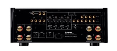

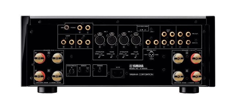

In terms of feature set and operation, the A-S3000 is a straightforward beast. On the front panel, you have the volume knob, input selector (including a switch for phono MM and MC cartridges), adjustments for bass, treble, and balance, a switch to control the VU meters, a speaker selector, and a headphone output with a switch to control its relative volume level. The rear panel is equipped with two pairs of balanced inputs, as well as five pairs of standard unbalanced RCA inputs, a recording output for input "line 2", pre-outs, a trigger input, remote in/out jacks, and four pairs of binding posts. The A-S3000 also comes with a basic remote control which shouldn't cause much confusion for users.
Back panel view of the Yamaha A-S3000.

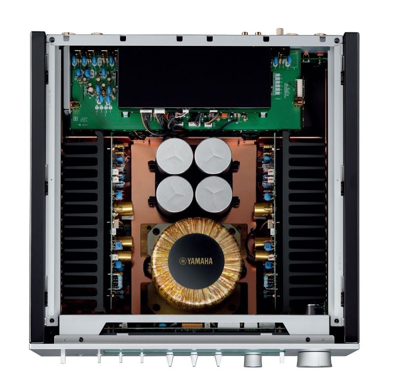

The (very clean looking) innards of the A-S3000.
So what do these numbers mean? In terms of raw performance, based on the specifications alone, the A-S3000 doesn't appear to be an extraordinary performer. But, we've often found published specs for high caliber gear to be more conservatively rated than mass market components. I suppose the only way we will be certain is running some of our own bench tests on this baby.
Even within Yamaha's own lineup, the A-S1000 appears to largely meet the performance specifications of the A-S3000 for a bit over 1/5th of the cost. However, Yamaha does make a pretty big deal out of the fact that the A-S3000 has a fully discrete phono preamp stage and every circuit from input all the way to the power amp is fully differential. Balanced audio circuits have significant advantages in distortion and noise immunity over unbalanced designs but they are more complex and costly to implement.
