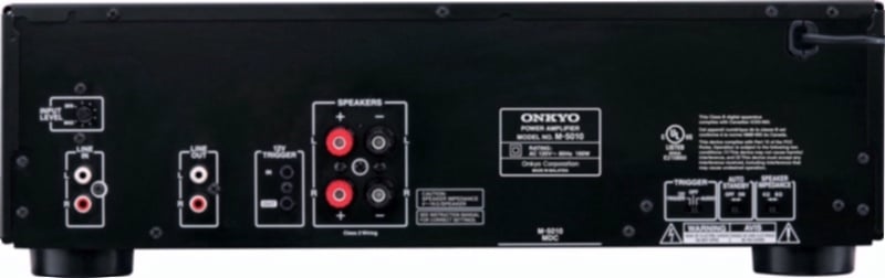

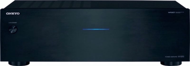

If nothing else, the M-5010 isn't a bad looking amplifier; it's not going to get the juices flowing like a McIntosh or Classe, but the brushed aluminum front plate adorned with a simple blue LED and power button aren't likely to offend anyone. Flipping to a rear view of the Onkyo, you'll find a fairly basic set of connections: standard RCA jacks for line input and output (the outputs allow for daisy chaining), 12V trigger input and output, and an ordinary set of binding posts which appear to offer adequate spacing. The M-5010 does also offer an input level knob which presumably offers a modicum of volume adjustment, though it'd be nice to see the ability to adjust volume for each channel independently. There's no audio jewelry here, but the connectivity options should be adequate to get the job done and lend some utility for multi-zone operation.
View of the Onkyo M-5010's rear panel; in a few words, bland but functional.
