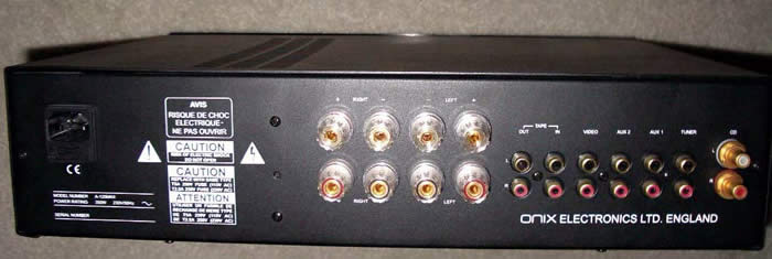

Setting up the A-120 M KII couldn't be easier. It had a very basic back panel with 5 audio inputs, a tape monitor, and four sets of WBT binding posts to power up to four speakers via its internal two-channel amps. The speaker outputs are wired in parallel so if you do plan on taking advantage of all four outputs, we would advise using 8-ohm minimum loudspeakers since the amplifiers will actually see half that impedance when driving two 8-ohm speakers per channel. Otherwise, feel free to use 4 ohm speakers in a two-channel configuration. As you will see in our bench tests, this amp has plenty of drive and will not hiccup on difficult speaker loads.
The thicker solid copper RCA connectors for the CD input add a nice touch of nostalgic value for audiophiles concerned with such matters. I like them because they were firmly coupled to the chassis - easing my concern when attaching and removing even the most exotic and not-so-form-fitting interconnects without fear of breaking them off.
Though I am not a Vinyl fan, lovers of this format should be aware that the Onix A-120 M KII does not contain a moving coil phono preamp. Thus, you will have to add your own and attach it to one of the unused inputs. I don't see this as an issue since true phono fans can always be found chatting up their favorite outboard preamp.

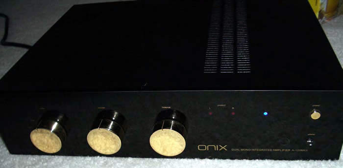

The front panel was void of the gadgetry commonly found on home theater equipment and instead contained a very basic user interface. Consisting of three large golden circular knobs, these sparse controls handled volume, balance (no tone controls) and input. A blue LED indicated power was on and two red LED's indicated a fault (which never tripped even during my max power measurement tests).

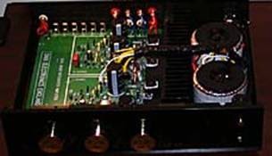

Peering inside the A-120 M KII reveals some impressive and uncommon electronics for a product in this price class. The power supply consists of dual 315VA toroidal power transformers with four (4) 10,000uF 63V power supply capacitors (a more robust power supply than most mid level 7.1 channel receivers).
Editorial Note on the Onix A-120MKII Amplifier Design
- Paralleling multiple BJTs in push pull configuration is a good method of ensuring amplifier output impedance is low enough to deliver high current while driving low impedance loads. It's also an effective way of minimizing frequency response variations which can occur when driving highly reactive speaker loads and exotic cabling.
- Multiple high voltage (63V) capacitors (4 x 10,000uF = 40,000uF total). In order to do 120wpc a minimum recommended cap voltage of sqrt(2)*31 + 5 = 49V should be used. Using 63V gives them plenty of design margin and added headroom since the rails can swing much higher.
- Dual toroidal transformers ensure this amp has the power to back its ability for driving low impedance loads.

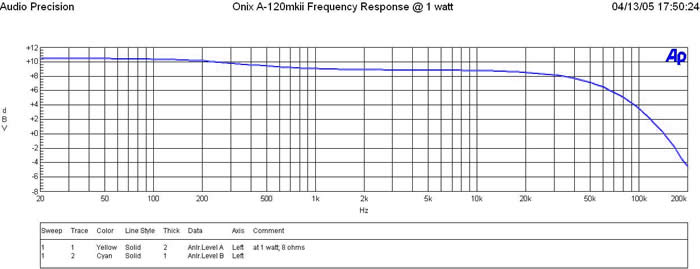

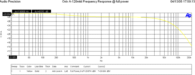

The Audio Precision revealed one reason I was hearing authorative bass impact and a warm sonic signature. There was a +2dB bass boost built into this amplifier out to about 200Hz or so. This was obviously a deliberate design attribute which can also be inferred by their published frequency response specification from 20Hz to 20kHz +-1dB. I can't really fault them since it was in fact intended and I did find it pleasing to the ear despite it not being the normal ruler flat response typically found on most consumer gear.

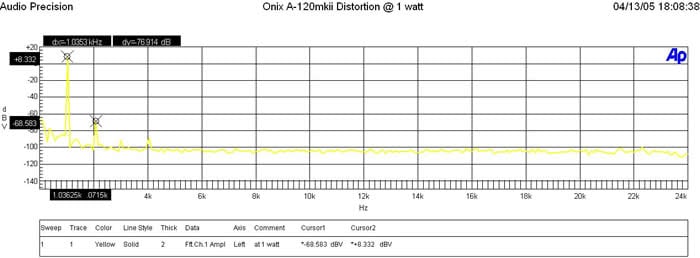

Distortion at 1 watt was respectable (+8.332+68.583)dBv = 76.915dBv or
                            100*alog(-76.915/20) = .014%.

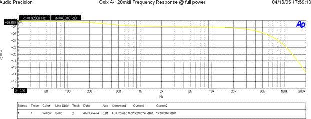

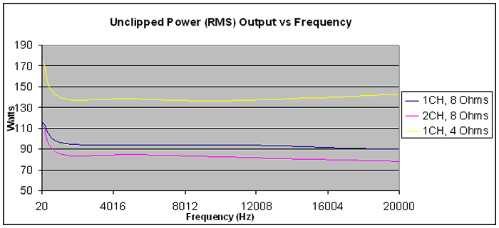

At full unclipped power, the Onix A-120 M KII delivered about 116wpc into 8-ohms but with the caveat of it being a function of bandwidth. From 20hz to 200Hz it delivered about 30Vrms (116wpc) via 8-ohms for .1% distortion and 26Vrms (85wpc) at 1kHz when fed the same input signal level but at a much lower distortion level. Into 4-ohms the Onix A-120 M KII delivered about 170wpc at .1% THD from 20Hz to 200Hz and roughly 115wpc for the rest of the audible spectrum. Since Onix doesn't specify distortion over a specific bandwidth for their power specifications, we can't declare they didn't meet them. We didn't run into any situations where we felt the amp was short of power during our listening tests.

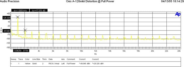

Distortion at
full power was good, though higher order harmonics were more pronounced;
(+28.328+49.048)dBv = 77.376dBv or 100*alog(-76.915/20) = .014%.
Signal to Noise Ratio at full power was -103.57 dB below 29.70 dBV Reference Level (at 0.09 % THD+N) <10 Hz - 22k Hz bandwidth, no option filter. With 200mV in, 1 watt out the SNR was found to be 80.4dBrA which is decent performance of a product in this price class.
