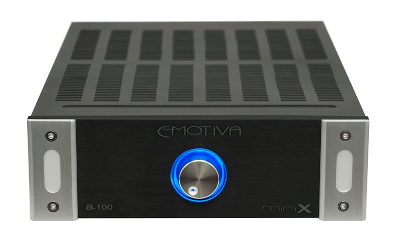

At $219 MSRP (and just $199 during the holidays), the a-100 Stereo Flex Amp is not going to break the bank. It is designed with the traditional Emotiva stylings including the blue light around the single volume knob on the front, black case, and aluminum plates on the sides. The volume knob is machined aluminum as well and the unit is almost 12 pounds and 8.5" wide x 3.125" high x 15" deep (including feet, connectors, and volume knob). This is quite a bit bigger than other "mini" amps but you get, in exchange, power. Real power.

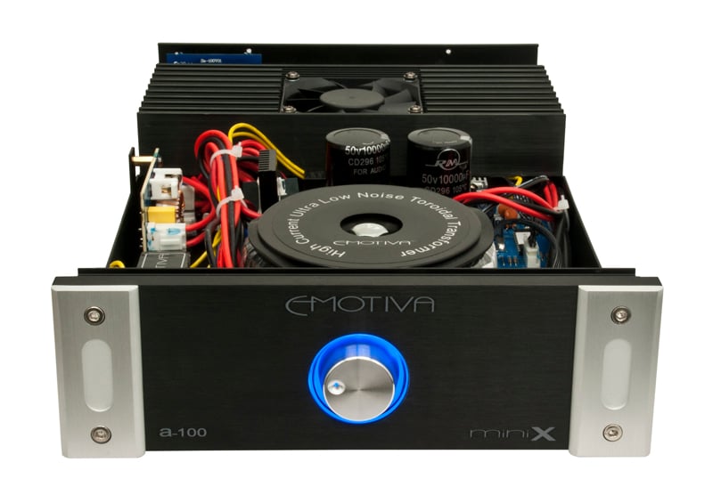

With 60 watts into 8 ohms and 80 watts into 4-ohms, you may be thinking, "Yeah, and?" Well...and what $600 or less receiver can you think of that is even rated for 4-ohms much less a $200 power amp? Not only that, look at the power supply on that bad boy. We're having a hard time thinking of one on a mid-fi receiver that is as large. Add to that the 2 x 10,000uF 60V power supply capacitors, fully discrete design, and Emotiva's reputation for quality, and you have a two-channel amplifier that will power just about any speaker you can think of.

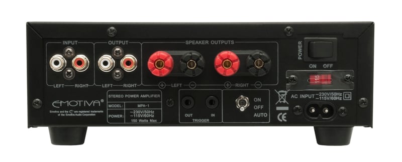

Of course, you can't have all that power without some trade-offs. While the a-100 is designed to be either a fixed-level amp or as a standalone "integrated" amplifier, there isn't much integrated into it other than volume control. There is a single line-level input (unbalanced RCA) which means you'll either have to settle for a single source or figure out a way of switching inputs outside of the a-100 (we suspect more products are coming to this line in the near future). The buffered loop output means you can string as many of the a-100s together as you like. It does have a 12 volt trigger input and output as well as an Auto on sensing feature. Emotiva has also included real 5-way binding posts as well as an user-selectable AC line voltage (115 or 230 VAC). There is no indication that you can bridge the a-100, though it seems like a more likely use would be for bi-amping.
As you can see from the top picture, there is a cooling fan. Emotiva has included horizontally mounted heat sinks which was probably a space saving measure. Unfortunately, it most likely reduced the effectiveness of the heat sinks necessitating the addition of a temperature activated forced air system. There is no word on how loud that fan will be.
