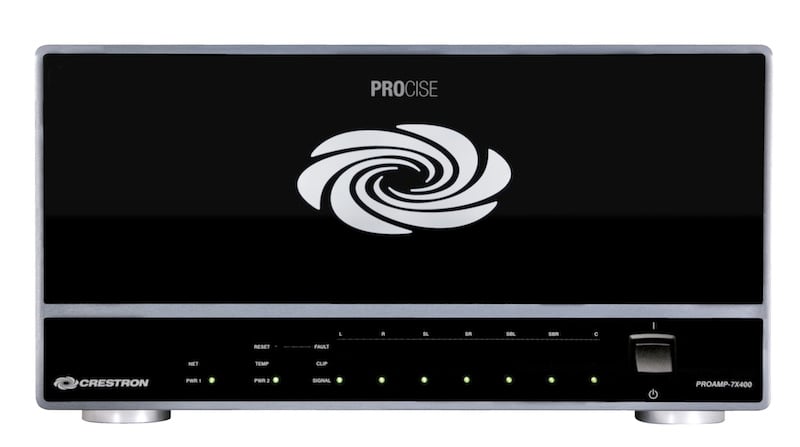

The Crestron PROAMP 7X400 amp sorts an aluminum front with a plastic overlay displaying proudly the Crestron logo. It is a bit prominent for our tastes and seems to look like it is in need of either a surf board or a grass skirt. Of course, geeks like us recognize it as the last thing we saw before the dreaded swirlie. But we digress.
There is a lot of technology in the Crestron PROAMP 7X400 to attract not only PROCISE processor owners, but consumers looking for a powering amp for their home theater system. As the name suggests, the amp sports 400 watts per channel into seven channels at 8 ohms and 700 watts into 4 ohms. It is stable into 4 ohms with all channels driven. On the front there are signal, clip and fault indicators for each channel. The amp weighs a hefty 108 lbs (the 7X250 only sheds three pounds. The chassis is metal with vented sides. We were surprised to learn that Crestron had gone with an ultra-quiet speed-controlled fan for cooling rather than a passive solution. The extra weight of huge heatsinks would surely impress those that measure the quality of their gear in pounds rather than performance. On the upside, though, the fan means you can mount it in your rack without leaving extra clearance above or below.

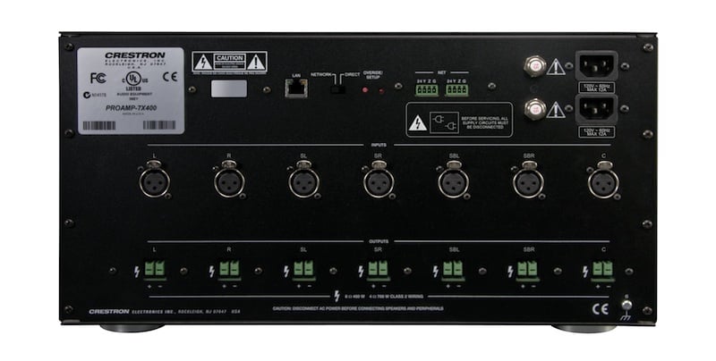

Glancing at the back you'll notice two power cord ports as the PROAMP 7X400 needs a lot of juice. This is not unheard of and a solution we've seen on other amps in the past. There are balanced inputs but no provision for unbalanced RCA inputs, a curious omission. While it is clear the the Crestron PROAMP 7X400 is designed to work with the PSPHD, leaving off the unbalanced inputs seems a bit shortsighted. It isn't like only PSPHD customers are going to end up with this amp. Eventually one will show up on one of the auction websites.
The other oddity is the omission of traditional five-way binding posts. Instead, Crestron included only the little green screw type connections which, while familiar to industry professionals and custom installers, are all but foreign to audiophiles. It seems like Crestron could have included both traditional binding posts and unbalanced inputs for consumers as well as the balanced and CI binding posts for installers.
Editor's Note: The intent of the design seems to be squarely for the custom install market, so we're not surprised at the lack of binding posts here
There is a LAN connection on the back for control via the PSPHD. Using a simple Ethernet connection, the PSPHD processor and PROAMP amplifier automatically pair, enabling seamless control and monitoring of the amplifier through the PSPHD front panel. If you remember from our coverage of the PSPHD, the front panel display can be modified to display real-time VU meters or spectrum analyzers. Plus you can actually confirm the specific fault condition, check the real internal temperature, and even monitor the output level of each amp channel on the face of the PSPHD. Pairing the two components also streamlines remote control and monitoring through a Crestron control system, providing programmers with a unified device interface for all functions.
But even without a PSPHD (and another reason Crestron could have included traditional binding post and RCA inputs), the PROAMP-7X400 can be integrated into a Crestron install. Using Cresnet and high-speed Ethernet you can directly control and monitor the PROAMP via a Crestron control system. You can control amplifier power, mute individual channels, monitor temperature and signal status, and receive fault alerts, all from a Crestron touchpanel, computer or mobile device. Signals from the amplifier may also be utilized to enable custom automation, such as reducing audio levels when clipping is sensed, or regulating climate control in the equipment room in response to amp temperature.
