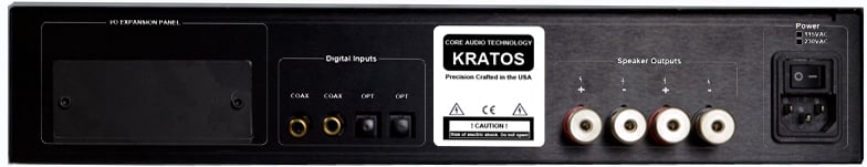

At this point, it’s important to clarify what “amp of this design” actually means. I’d suspect that many readers are unfamiliar with what a fully digital amplifier actually is. A quick glance at the back panel will tell you that this isn’t a typical amp. The back panel sports the expected two sets of speaker binding posts, but it also has a 2 digital optical and 2 digital coax inputs that can handle 24 bit/192kHz native. On the front you will find a volume/Input control and LED display. It also comes with an IR remote. It’s similar to traditional integrated amp in terms of functionality, but with a few very important differences.

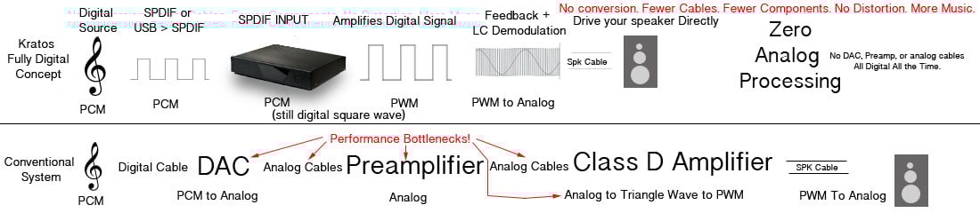

Kratos Fully Digital Concept
The Kratos is designed to have no “digital to analog conversion, no analog to digital conversion, no analog to triangle wave conversion, no analog to pwm conversion, no DSP, no sample rate conversion, and no switching power supplies.” It does not accept analog inputs of any kind; instead, everything is done in the digital domain and ONLY digital inputs are accepted. The logic is that no DAC is better than even the best DAC. The amp takes a PCM digital input, amplifies it, then the signal is demodulated to drive the speaker directly. One of the added benefits is also that THD does not change with power output. Ultimately, the goal of this design is to achieve better sound quality by eliminating unnecessary conversions, cables and circuitry.

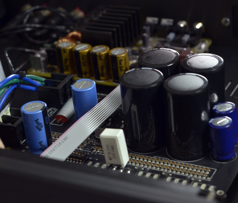

Core Audio doesn’t provide as detailed of specs about the amplifier measurement as we sometimes find, but they do go into far greater that normal detail about the power supply.Core Audio Kratos MKII Internal It’s a dual rail design with roughly 96,911uF of capacitance generated by 86 capacitors per rail. They claim that, “several LC filters and expensive feed-through filters are utilized in the regulation circuitry to eliminate noise in the bandgap and prevent spikes and ringing through capacitive coupling of higher frequencies”. It also utilizes a Wolfson 8805 Digital Interface Receiver. The Kratos MKII draws less that 1w of power when idle, and about 120w at full power (one channel driven). In comparison, the power supply is actually larger than the amplifier. Core Audio claims that, “We found a strong correlation between power supply performance and sound quality. That’s probably why the power supply is larger than the amplifier.”

 Core Audio Kratos MKII Rear Panel
