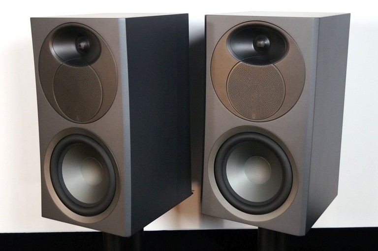

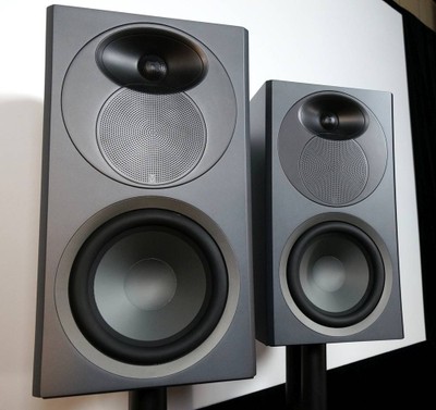

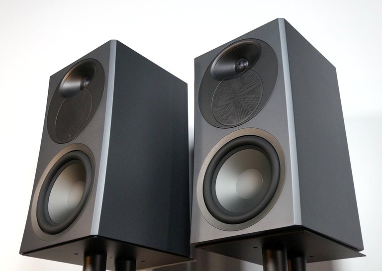

Once unpacked, the speakers are stylish yet reserved, like so much Scandinavian design. The cabinet front has a very gentle vertical curve, and the vertical edges are beveled. They look a lot like the 1528 series. The tweeter and midrange assembly are nearly identical to the 1528s. The bass cone is a bit different and looks like a more conventional bass driver as opposed to the 1528’s sleek aluminum cone and trim ring. The bass cone can be hidden by a grille that protrudes outward a bit. Since the tweeter and midrange are already covered with non-removable grilles, the included grille covers the bass driver only. The speakers that I received came in a ‘Basalt’ finish, which is a dark grey, but the 1610s can also be had in ‘Polar,’ which is a satin off-white. In the grey, these speakers aren’t visually eye-catching, nor are they at all ugly. I think they will do a good job of disappearing in most rooms, even though they are relatively large for standmount speakers. If you don’t want loudspeakers that are visually loud, they look to be a great choice, but they still have enough of a sense of style to not be completely boring either.

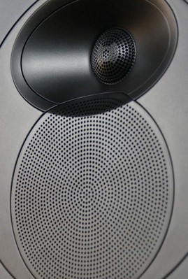

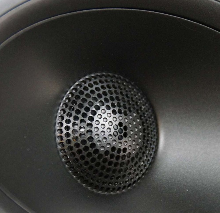

The 1610 Bookshelf 8 uses a 28mm (about 1.1”) aluminum-magnesium dome tweeter, (1528 uses more exotic lithium-magnesium), that is driven by a neodymium motor. The neodymium magnet must be a formidable one since Arendal says the tweeter sensitivity comes in at 95dB for 1W and 1m. The tweeter motor uses a copper shorting ring in order to lower inductance, thereby increasing bandwidth and lowering distortion. It is set in an elliptical waveguide that Arendal calls the “Røst™ Essence waveguide.” This waveguide looks to be going for a wide horizontal dispersion and narrow vertical dispersion. There is an acoustic lens covering the dome that looks like a grille. Not only does it protect the fragile dome, but it also helps to prevent acoustic energy radiating from different parts of the dome from interfering with each other, thereby reducing comb-filtering.

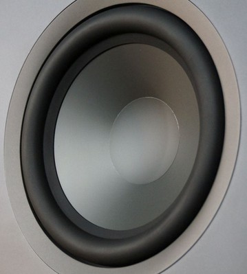

The bass driver uses an 8” aluminum cone. It has a beefy surround that looks to allow for a fairly high excursion. The surround has been reinforced with internal ribs, which should help lower distortion from deformation or flutter noise.

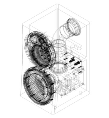

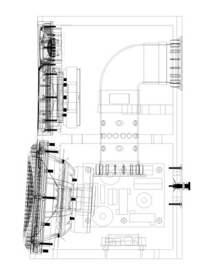

1610 3D X ray1610 Bookshelf X ray Side view
A good-sized bookshelf speaker with a high-sensitivity tweeter and midrange as well as a high-excursion bass driver and large port promises a wide dynamic range, but the low tuning frequency does suggest sacrificed sensitivity as well. This is a bookshelf speaker that wants to give you deep bass, but, in this form factor, that means it will need a good amount of wattage to get loud. This is not a big deal since wattage is pretty cheap these days, and you do not need to spend a fortune to get a few hundred watts per channel anymore. So then, let’s see what the 1610 Bookshelf 8 can do in some real-world listening with an adequate amount of power…

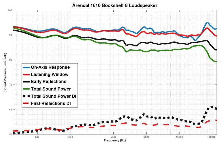

The above graph shows the direct-axis frequency response and other curves that describe the speaker’s amplitude response in a number of ways. For more information about the meaning of these curves, please refer to our article Understanding Loudspeaker Measurements Part 1.
The above responses of the 1610 Bookshelf 8 are fairly neutral. They are not quite as smooth as Arendal’s 1528 speaker that we measured, but they portray a loudspeaker that does very little to alter the incoming signal sound relative to human hearing. The on-axis response gets a little rocky at the top end, but that occurs in such a high-frequency range that few listeners would be able to discern anything there, and not much recorded content has anything important in that spectrum anyway. The most important curve in this group is the Listening Window response, and it shows a very smooth response with only very minor variances. The 1610 Bookshelf 8 is a well-controlled, linear loudspeaker. The Early Reflections and Sound Power curve shows a small blip around 3kHz which is the crossover point between the midrange and the tweeter, but it is barely a 1dB drop on the whole. The First Reflections directivity index, which is the most important of the two directivity indexes, suggests a speaker with well-matched dispersion between the drivers.

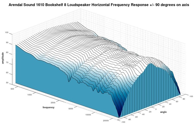

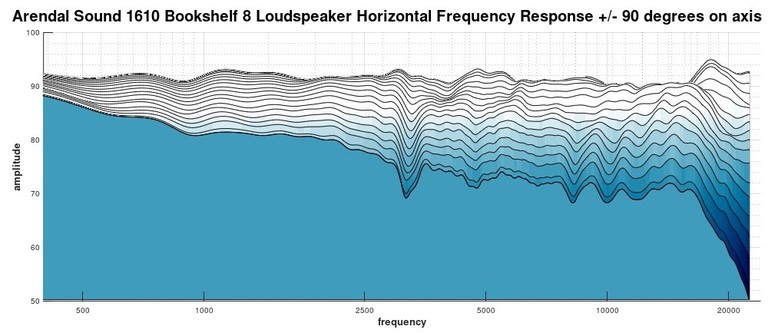

1610 3d waterfall response
1610 2d waterfall response
The above graphs depict the 1610 Bookshelf 8’s direct-axis and horizontal dispersion out to a 90-degree angle in five-degree increments. Information on how to interpret these graphs can be read in this article: Understanding Loudspeaker Review Measurements Part II.
The above graphs show pretty good, although not absolutely perfect, directivity control throughout the measured bandwidth. There are some slight bunching up of curves and some instances where the off-axis responses don’t quite match the responses near the on-axis, but these are minor and very unlikely to manifest anything audible. What we have here from the 1610 Bookshelf 8 is overwhelmingly good news. The responses generally have good correlation with each other, and that means that the speaker retains the same sound character across a wide angle of the frontal projection. The advantage of this is that this speaker will not be fussy about placement to get a good sound over a wide range of listening positions. It also has a major advantage in that the acoustic reflections will resemble the direct sound, and that is easy for equalization systems to achieve a specific target response. Systems like Audyssey and Dirac will take very well to this sort of dispersion pattern.

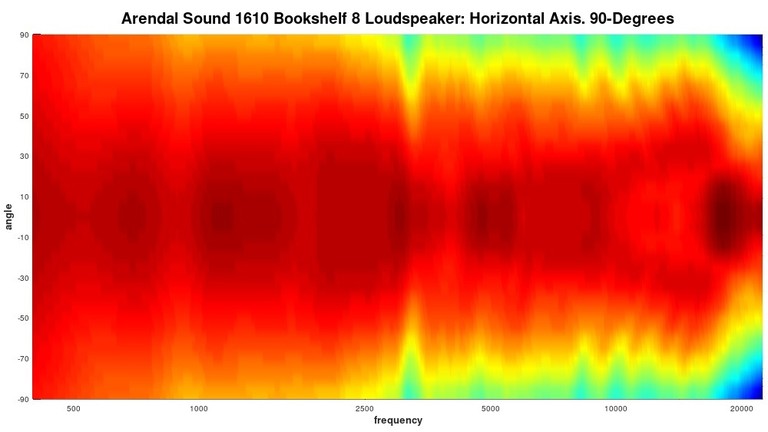

1610 polar map
The above polar map shows the same information as the preceding graphs but depicts it in a way that can offer new insight regarding these speakers’ behavior. Instead of using individual raised lines to illustrate amplitude, polar maps use color to portray amplitude, and this allows the use of a purely angle/frequency axis perspective. The advantage of these graphs is that they can let us see broader trends of the speaker’s dispersion behavior more easily. More information about interpreting this graph can be read in this article: Understanding Loudspeaker Measurements Part II.
In the above graph, we get another look at the 1610 Bookshelf 8’s superlative directivity control. It is a relatively wide-dispersion loudspeaker and holds a fairly consistent level of energy out to 60 degrees off-axis. Again, we do see a tiny directivity mismatch going from midrange to tweeter, but it would be too small to translate into anything audible. The width of the dispersion pattern holds out to nearly 20kHz, a pretty astounding feat for a loudspeaker with a relatively shallow waveguide. I do think that the slight tip-up in energy in the response as it approaches these high frequencies helps to keep the response broad in the top end. Usually, the width in dispersion narrows as the frequencies rise, but this speaker doesn’t start doing that until nearly 20kHz. That means that even far off-axis listening positions will get hit with the full range of sound, going all the way up to the highest frequencies of human perception. The bottom line for this graph is that the consistency in energy at horizontal angles will make this a very easy speaker to work with in setup and placement for optimal sound.

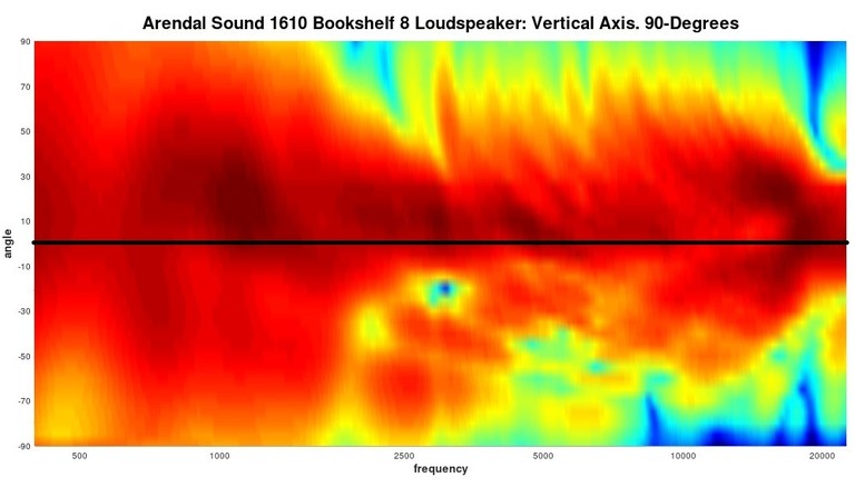

1610 polar map vertical w line
The above polar map shows the 1610 Bookshelf 8’s response behavior along its vertical axis, where zero degrees is directly in front of the tweeter (denoted by the lateral black line), negative degree values are below the tweeter, and positive degree values are above the tweeter.
Here, we can see some phase conflicts at lower angles but not much at higher angles. Phase cancellation is taking a chunk out of the responses once we go below 15 degrees, and it happens largely from 2kHz to about 5kHz. It is interesting to see that not much phase cancellation occurs at high angles. What this tells us is that the 1610 Bookshelf 8 is best listened to on-axis or at somewhat higher angles. Make sure the tweeter is at ear-level height or perhaps a bit below ear-level height when positioning the speaker. It may pay to get a somewhat low speaker stand to pair with these speakers.

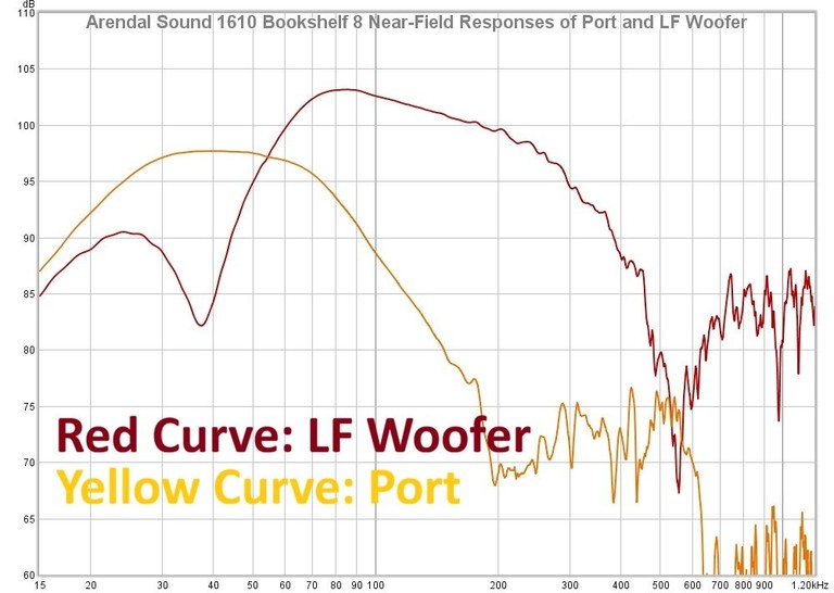

1610 near feild port2 labeled
The above graph exhibits near-field responses of the low-frequency woofer and port of the 1610 Bookshelf 8. In near-field measurements, we place the mic very close to the driver diaphragm to get a clean reading of its amplitude response. I don’t normally publish these measurements as they can be subject to misunderstanding, but I decided to do so in this case to show how well Arendal’s efforts to reduce port resonances have worked. The thing to look at for port resonances is spikes in energy above the main peak of the port’s output (here shown in the yellow line). What we see is very good control of port resonances, with no discernible harmonics at over 20dB down from the fundamental port resonance. Many speakers would be doing well to have harmonic resonances at -10 dB down, but the 1610 Bookshelf 8 brings these pipe resonances to much lower than that, even. I was skeptical of Arendal’s strategy to mitigate port resonances when they explained it to me, but seeing these results made me a believer. Arendal has given us a very well-executed port design.

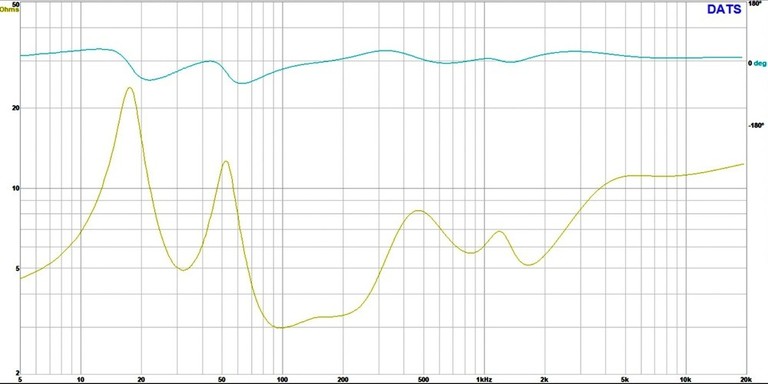

1610 imp
The above graph shows the electrical behavior of the 1610 Bookshelf 8 speakers. These speakers have a highly varying impedance response. What is concerning is the impedance minima around 100Hz, which dips to 3 ohms. That is pretty rough, especially for a loudspeaker that is on the less sensitive side. This is not a speaker that should be run on a flimsy or low-cost amplifier. The good news is that I think few users will run these somewhat pricey speakers on a cheap amp. Users will need to make sure their amplifier is comfortable with a real 4 ohm load. Something else to note is the dip in the low-frequency saddle, where we can see that the port tuning frequency is just above 30Hz, confirming that these speakers are relatively deep digging in bass, especially for their size.
