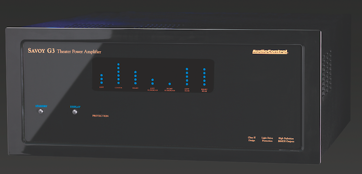

AudioControl has recently released their Maestro M3 Pre/Pro - a well featured pre-amp aimed toward the high-end crowd and integrators. The Savoy G3 is the mate to this processor providing the power that all processors need. The Savoy G3 is an attractive offering with a gloss black finish on the front and Maestro-matching Rose Gold lettering. The Savoy G3 is a bit of a beast at 54 pounds which is even more impressive when you consider it employs a class H design.

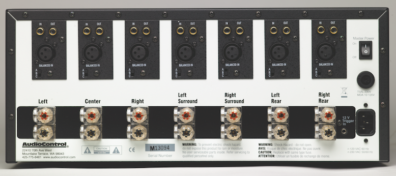

The AudioControl Savoy G3 is a seven channel, 200 watts per channel amp. On the back it has both RCA and XLR inputs for each channel. There is a removable power cord, a main power switch, a 12-volt trigger, and each channel has a "sensitivity" switch. There are three settings, A, B, and C. AudioControl recommends C for most applications with B being reserved for THX certified gear and A for gear with high output voltages. Each channel is labeled and has "audiophile grade" five-way binding posts.
The front of the Savoy G3 has a Standby and Display button with the Display button being used to defeat the power indicators. There are traditional blue LED bars that increase as power is provided to each channel. There is a small pin-point protection light that will illuminate red if one of the protection circuits are engaged.

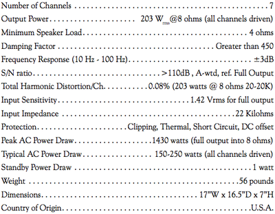

AudioControl claims over 200 Watts per channel into 8 ohms, all seven channels driven for the Savoy G3. It only needs around a half inch of space around it for normal operation (which isn't much and attests to how cool the Savoy G3 runs). While the marketing literature says the amp is "stable into low impedances," the manual states that it shouldn't be used with speakers that dip lower than 4 ohms. This means that some of your more demanding speakers (like electrostats) need not apply.
AudioControl has incorporated what they've termed a LightDrive Anti-Clipping Protection Circuit which protects the amp (and speakers) from clipping and maintains a clean audio signal. It also has high definition BiMOS ouputs, high current gold output terminals, and, most interestingly, RCA outputs. One thing that we often see with esoteric gear is multiple amps used on a single speaker. With an output RCA on each channel, the Savoy G3 is built for just such a contingency. It seems like it would make sense to have both RCA and XLR outputs but that isn't the case with the Savoy.
