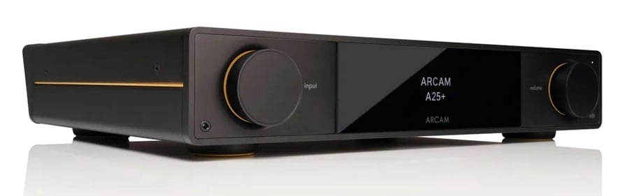

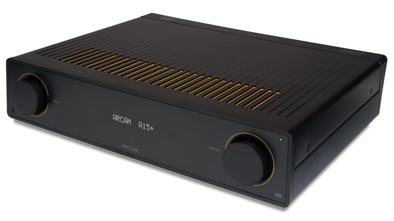

ARCAM’s Radia series introduced a new design language for the brand when it launched back in 2023, and I’m a big fan of the aesthetic. More importantly, the range set a new standard for what ARCAM’s entry-level Hi-Fi components could achieve. In particular, the $1,650 ARCAM Radia A25 integrated amp is an easy recommendation at its price point, having garnered positive reviews both here at Audioholics and elsewhere. (See Gene DellaSala’s Arcam A25 Integrated Amplifier Bench Test Results.) In 2024, The company added a new streamer and two higher-end streaming amplifiers to the Radia lineup. Now ARCAM’s engineers have given the three entry-level Radia integrated amplifiers a once-over, resulting in the new A5+ ($1,199.95), A15+ ($1,499.95), and A25+ ($1,999.95). These new models were shown for the first time in North America at CEDIA Expo 2025.

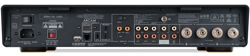

ARCAM A25+ rear
ARCAM says that the new models build on the DNA of their predecessors with upgraded circuitry, refined components, and intelligent power management. Together, these upgrades promise enhanced performance on top of the new models’ expanded feature set. The most asked-for upgrade was surely the addition of HDMI eARC, which is now included in both the A15+ and A25+. The A25+ has also been given some exterior upgrades, including a precision-cut glass front panel that sharpens and brightens the display, making it a better visual match to the Radia ST25 streamer ($1,650). The A25+ also receives the most substantial update under the hood, where you’ll find a dedicated ESS9018 DAC chip just for the SPDIF inputs, delivering superior audio fidelity, according to ARCAM. From a performance standpoint, the amp’s biggest upgrade is a new transformer featuring a dedicated winding for the digital and DAC circuitry, double linear regulation in the analog power supplies, and further power filtering refinements that lower impedance and enhance overall clarity, according to the company. The A15+ also received transformer upgrades. The transformers in both the A15+ and A25+ reduce unwanted current within the chassis better than their predecessors, according to ARCAM. Gene noticed under extreme power testing the older A25 underwent internal mechanical noise stresses and we wonder if Arcam has addressed his concerns with the A25+ model. He also wonders if ARCAM has updated the phono stage which he found could use improvements in drive level when testing the A25 outgoing model.

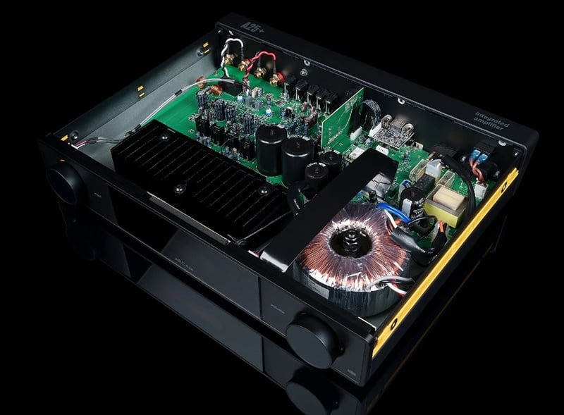

ARCAM A25+ inside
Noise reduction remains a key engineering focus in the Radia+ series, according to ARCAM. Even the entry-level A5+ reportedly benefits from component refinements that cut PCB interference and lower power supply impedance. The new amps can selectively power down idle components, thereby decreasing the overall noise floor significantly, according to the company. For example, when using an analog input, the DAC PCB is powered down, and the Bluetooth and HDMI modules are powered off, with the Autoswitch features disabled. When no cable is connected to the trigger input, the input is powered down. ARCAM says that all of these measures contribute to a cleaner power supply environment resulting in better sound quality.

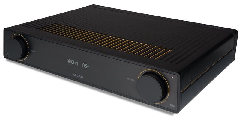

ARCAM A5+
The A5+ is described as “the perfect introduction to premium Hi-Fi,” delivering 50 watts per channel of Class AB power and a wide range of digital and analog inputs, including a MM phono stage.
ARCAM A15+
The A15+ provides “more muscle for larger rooms and tower speakers,” delivering 80 watts per channel of Class AB amplification. It also adds HDMI eARC for seamless TV integration.

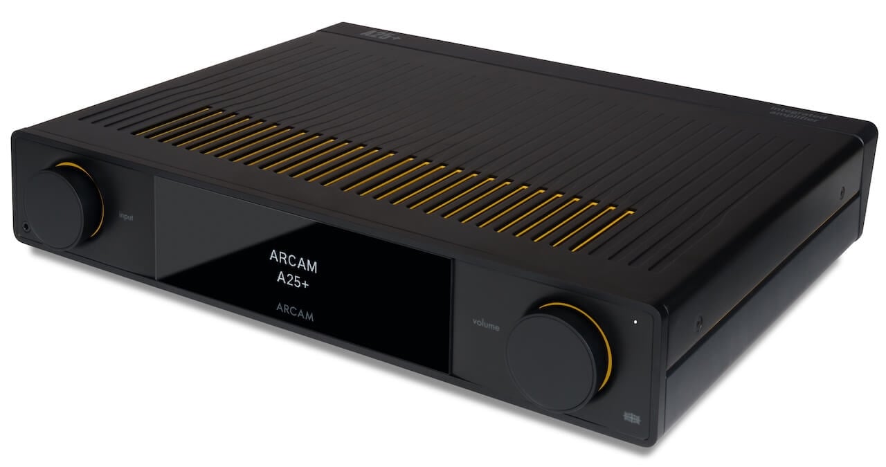

ARCAM A25+

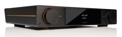

The A25+ integrated amplifier delivers 100 watts per channel of Class G power. It adds a USB-C input in addition to HDMI eARC, and a second ESS DAC chip dedicated to the SPDIF inputs. The glass-paneled OLED display matches the ST25 streamer.
