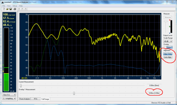

There are four pieces of functionality that XTZ Room Analyzer provides that is used to complete a system calibration by analyzing your room response:
  • Sound Pressure Level (SPL) meter with C weighting and slow averaging to set speaker and subwoofer levels
  • Delay alignment tool to set speaker and subwoofer distances
  • Real time analyzer (RTA) to set subwoofer phase / polarity
  • Frequency response ‘Room Analyzer’ with 1/3rd octave smoothing to check subwoofer phase / polarity

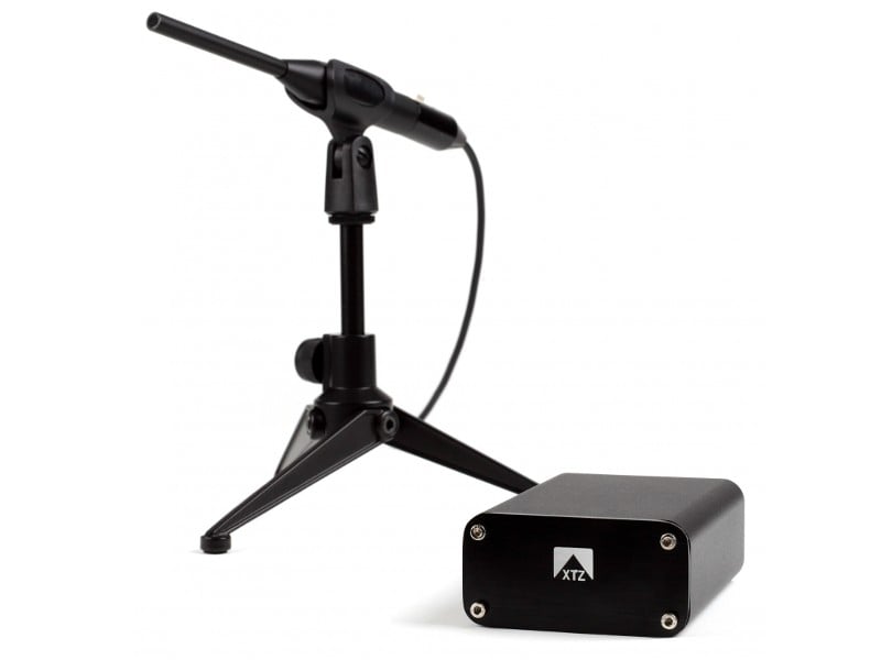

  • Both versions are all in one box packages that include the hardware (soundcard, microphone, cabling) and software required to take acoustic measurements
  • Standard version has upgraded hardware compared to the original version yet retails at $70 less
  • Pro version has completely new hardware with increased microphone accuracy
  • Separate software for Standard and Pro versions; Pro version has more functionality
  • New software for both versions includes SPL meter; Pro version also includes signal generator

  • Home theater calibration -  set levels with the sound pressure level (SPL) meter and dial in distance settings with the unique 'delay alignment' tool.
  • Subwoofer integration – using the high resolution 16Hz-300Hz frequency response and real time analyzer (RTA) modes.

  • Room acoustic analysis - the software has capability to do high resolution 16-300Hz frequency response and low frequency decay spectrogram measurements as well as full range 20Hz-20kHz frequency response and 2D/3D waterfalls to analyze reflections and check for flutter echo.
  • Room correction - the software automatically generates correction filters for room modes which you can then further optimize using the unique parametric EQ software emulation mode.
