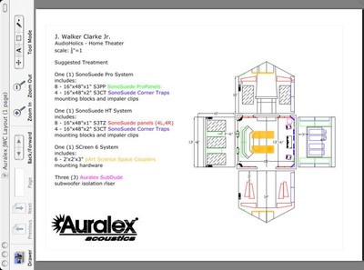

The form asks you to choose a budget level, describe the type of room, and list any preferred products. It also asks for a description of the walls, ceiling, floor and any existing acoustical treatments. Finally, there is a section on observed or measured acoustical problems, broken down into two categories: Room Acoustics (things like slap-back, boomy bass or excessive reverb) and Sound Isolation (disturbing neighbors, HVAC noise, or unwanted external noises). Next there is a sheet of graph paper for you sketch out the room and its measurements, windows, doors, etc.
If you are worried that you might not be "technical" enough to fill out the form properly - don't be. That is what the team at Auralex is there for. I was very brief in my descriptions. Other than making sure I measured the dimensions of the room and windows properly, I pretty much just checked the box by "Bass Build-up (boomy lows) and/or Cancellation" (bass drop-outs), as my room is definitely plagued by excess bass. I faxed the form back to Auralex and emailed the digital photos of the room.
Later that day, Sean had emailed me back with an email that said, and I quote, "Wow, that's quite a room!" He said he would work up some recommendations and get back to me in about a week.
As promised, a week later I found an email one day from Sean describing in detail the "number of acoustical problems" that my room presented, which were somewhat "atypical of what a dedicated home theater might encounter." Some of these problems included the sloped ceiling and large amount of glass windows (not to mention the picture and poster frames) that would make reducing harsh reflections and taming frequency response irregularities a bit of a challenge. He explained that in order to improve sound quality, we would need to strategically place absorbent and diffusive materials throughout the room to break up parallel wall/ceiling reflection and smooth frequency response across the listening positions on the couch.
The SonoSuede series panels are a great fit for the room due to their broadband absorption. Certain panels will help to address the low frequency inconsistencies throughout the room while others will minimize flutter and reverb in the mid-high frequency bands.
The cathedral ceiling was creating a small, focused sweet
spot that we wanted to expand, so Sean suggested using SpaceCoupler diffusers
suspended from the ceiling, hung parallel to the floor. This will break up reflection and decrease
the focusing from the angled ceiling while keeping the energy in the room,
which ultimately should result in a more open and natural sweet spot for
listening.
All of this sounded great - but would it work? I called Sean back to discuss color options and clarify some of the suggestions. Auralex offers the SonoSuede Pro and SonoSuede HT systems in several colors that can be custom ordered, and keeps four standard colors in stock. Red, Tan, Brown and Black are the stock colors, and for my room I chose to go with Tan and Brown.

The suggested treatment that Auralex came up with for my room included an assortment of products, including the following:
- 1 SonoSuede Pro System ($1199)
- 1 SonoSuede HT System ($1199)
- 1 SCREEN 6 System ($1199)
- 4 SubDudes ($49.95/each)
Each SonoSuede System contains 8 SonoSuede Panels, 4
SonoSuede Corner Traps, and mounting blocks and impaler clips. The only difference in the Pro model and the
HT model is the shape of the SonoSuede Panels.
While both are the same length (48") and depth (1"), the HT
version has a slightly triangular shape, whereas the Pro version is
rectangular.
The SCREEN6 system consists of a set of six SpaceCouplers and mounting hardware for wall or ceiling installations. They arrived in 3 boxes bundled together, each with 2 SpaceCouplers.
