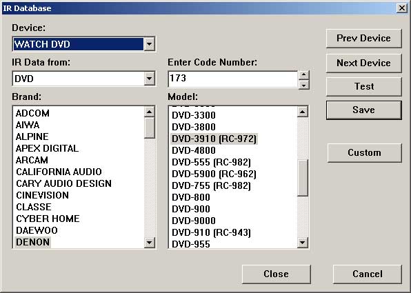

MX950_IRdatabase_lg.jpg2 Assigning IR data to devices using the included IR database
This is both a critical and time-saving step. It is also the place where you will begin to see some of Universal Remote Control's weaknesses. Their database is up-to-date in some areas, and terribly lacking in others. After dealing with Harmony's database which is almost uncannily maintained, I was surprised to see the MX-950 Editor lacking some newer (and even older) products, including the following components:
  • Yamaha RX-V2600
  • Yamaha DPX-1200
  • Sony VPL-HS51 (or the new VPL-HS51A)
  • Optoma H31
  • Optoma PD50 or PD50A
  • Sony STR-DA7100ES
  • PureLink HDMI/DVI Switcher
  • DVIGear HDMI/DVI Switcher
  • Panasonic TH-50PHD8UK
  • Pioneer PDP-42A3HD
For some of these devices, similar or older devices or sufficed to get the buttons and codes needed, however many did not exist at all and needed to be learned. Universal Remote Control mentions in their manuals that you can also try the generic manufacturer codes provided in the database as well. However, that is a time consuming process and should not be inflicted on the consumer unnecessarily (it also almost never results in a satisfactory button layout). I was rather surprised that there was not more attention to detail in the database in keeping it up to speed with new and old products. From a customer service standpoint it seems like a major drawback, especially as the competition in remote controls continues to heat up.

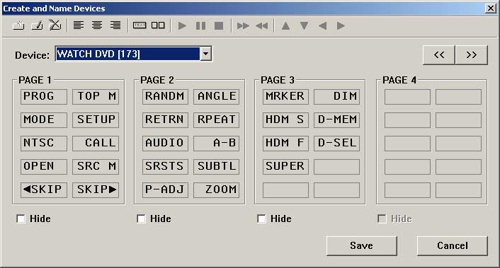

3 Edit Buttons
A continuation of the first step, this involves rearranging the new-found buttons which will now show up in the Button Editor screen. You can click and drag buttons around, set the left/right justification, re-label and rename, and even structure the screen buttons to take up one or two spaces on the screen. This last function is new to the MX-950 and results in the ability for users to create LCD-based soft controls that can be activated by using either the left or right side buttons on the remote. This is excellent for setting up a series of basic commands under the "Watch" and "Listen" activity menus or for making easy "family-friendly" controls that hide more complex macros underneath.

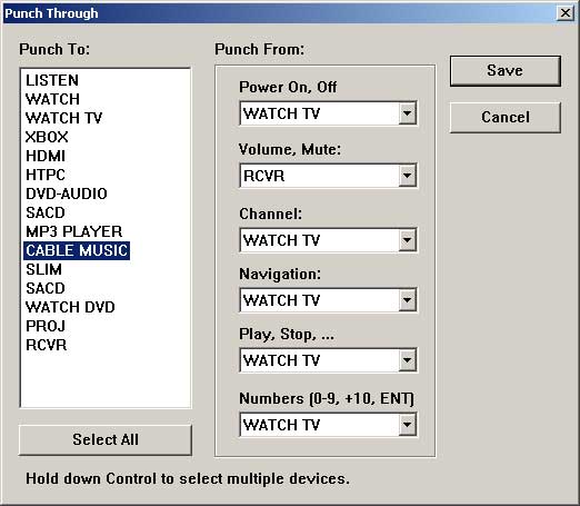

MX950_punchthrough_lg.jpg6 Punch Through Settings
When you are controlling the digital cable box, you probably want to have the volume buttons activate the receiver/processor, not the cable box volume. To avoid having to learn volume commands for each subsequent device, you can instead utilize the Punch Through function which allows you to configure Punch Through commands for:
  • Power On/Off
  • Volume/Mute
  • Channel
  • Navigation (the central arrow keys and Enter button)
  • Play, Stop, etc
  • Numbers (0-9, +10, Enter)
I make ample use of the Punch Through commands for Volume/Mute as I am almost always controlling the receiver's volume when I am in various modes. It is also handy for setting the basic functions for your "Watch" and "Listen" activity pages.

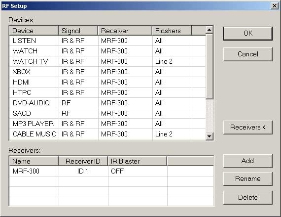

MX950_RFsetup_lg.jpg8 RF Setup & Control
Congratulations! If you made it to step 8, you're ready to really get into the nitty gritty of programming your Universal Remote Control product as a true RF device.
The key to this page is understanding what each item means. The Device menu is self-explanatory and represents each device you setup in Step 1. These may be real or virtual devices as mentioned in Step 1. The Signal menu allows you to determine whether the MX-950 will output IR for that device, RF, or a combination of both. In this way, you can eliminate stray IR commands from being thrown around the room when you are utilizing the RF features of the remote for a particular device. The Receiver menu allows you to select which RF receiver you are assigning the device to. In our case there is just one, however you can daisy chain up to 15 MRF-300 units (each can be set to its own ID, from 1-F in a hex sequence - you set it via a small rotary switch on the bottom of each unit). That's likely enough to wire up the White House. The Flashers menu takes configurability one step further by allowing you to set which of the 6 IR flashers should be utilized by that particular device (including an option for 'All'.) In this way, you are able to control 90 (15 RF receivers x 6 IR blasters) different devices or zones with a single remote. That's a little more than I need in my home theater.
At this point I want to note something that caught me off guard. With the MX-700's RS-232 interface, remote control updates took seemingly forever and it was a rather cumbersome process to test and tweak different configuration options. When I first downloaded an update to the MX-950 I almost fell out of my chair... Gone were the long waits for downloading and updating the device. The MX-950 takes mere seconds to update - even the remote reboot sequence takes longer to complete.

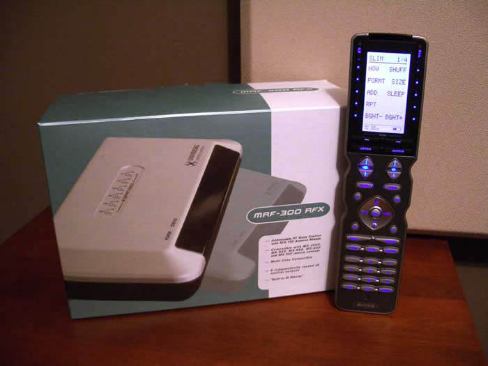

null MRF-300 RF Receiver Base Station
In Reference System 2 , I utilized 5 of the 6 IR flashers and connected them to the front of my devices. Locating the RFX-150 antenna on the wall outside of my equipment rack I was able to get a nice clean RF signal with little interference. I located the MRF-300 base station away from my equipment and utilized some of the ample length provided to the IR blasters to accommodate this remote location.
The MRF-300 features adjustable IR output levels for each of the six IR emitters (blasters). You'll need to use these when connecting to most cable or satellite boxes as they require a lower level of IR in order to function properly (their IR receivers tend to get easily oversaturated.) For those who are able to position the MRF-300 in front of their equipment, you can enable the unit to function as an IR blaster, increasing the number of devices you can control beyond the six IR emitters.
Overall, the MRF-300 is a fantastic device to use with any of Universal Remote's RF-capable remote controls. It enables true care-free remote control over your system and is absolutely essential if your equipment is not all located line-of-site.

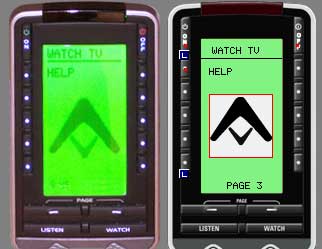

The first time you use the MX-950 you'll be greeted to something not common on prior URC remotes - sound. In addition to the exceptional programming capabilities of the MX-950, now you will be able to program feedback into the remote for various macros or functions. The remote shipped with a default button sound and I toyed around with various "completion" sounds to let the user know a macro was being run or had finished. These are things you can do to help make the client's experience with the remote control more successful.
MX950_graphics_lg.jpgCustom Graphics
How about some more? The MX-950 also accommodates basic graphics. You can select from the included library or import your own JPG or BMP files. We snagged the Audioholics logo and entered it in to see how it looked and were rather pleased with the results. A practical example of how to use a graphic would include setting up a "waiting" or "macro-in-progress" screen that you could trigger at the start of a complex macro, then jump to the destination page at the completion of the macro. It's these types of niceties that spell the difference between a "nice remote" and a truly functional system controller. The graphic system is drag-and-drop so you simply pull a file off of the image gallery, and drop it onto the remote screen where you want it to appear. You may want to create a hidden page to house specific graphics that can be used during the course of executing macros and commands.

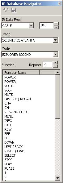

MX950_IRcodes_lg.jpgIR Database Navigator
The IR Database Navigator is a very direct way to call up discrete remote codes from any device in the Universal Remote Control library. Using the MX-950 Editor, simply select it from the Tools menu, choose the brand and model of the device control you wish to procure and then drag it to a button on the remote control. This is a very quick and easy way to utilize commands from devices other than the currently selected one without having to learn them (assuming the required codes are in the database).
