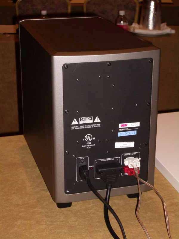

  • The 8" subwoofer enclosure contains all amplification and connects to the main unit via a single DB25 "umbilical" (which also supplies power to the main unit). As a result, the sub module is the only component that needs to be supplied power

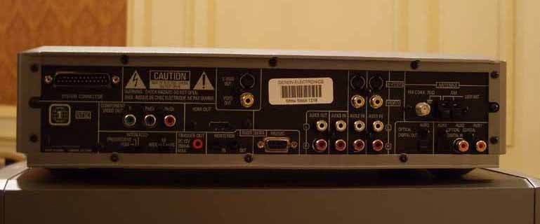

There is so much to say about this units. Take special note (above) of RS-232C support as well as 12V trigger output for the S-301. The S-301, in addition to iPod functionality can control a Rio or other portable USB-based players or flash devices through the inclusion of a USB port that will also charge the unit while connected. SImply connect the device and the S-301 can navigate the content with its on-screen display. The remote functions automatically control the playback of the device contents.
These pictures show you some of the compatibility and flexibility of these new systems. This home theater product is designed to go head to head with a certain name brand product that you would probably recognize. Just in terms of appearance, features, flexibility, and ease of use I believe it could stand to alter the marketshare numbers significantly.
