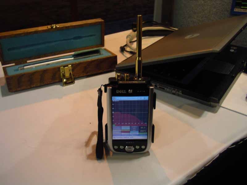

[IMGP0012] Ivie Technologies, a long time manufacturer of acoustic test instrumentation and commercial audio electronics, showed us their new miniature handheld audio analysis system called the IE-35. With the IE-35 system, Ivie has moved to the Dell Axim X51v computing platform. The new IE-35 weighs in at only 11 ounces and contains new functions such as STI-PA, RT-60 and Delay.

A Dell Axim X51v PDA can be inserted into the Ivie IE-35 "jacket" and is connected via the CompactFlash slot thereby transferring information from Ivie's 7mm electret condenser Type II microphone, low noise preamp and 24 bit A/D converter to the processing power and display of the Axim PDA. The jacket also accepts one or two line input channels.
