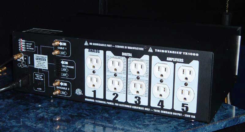

![[TributariesTX1000rear]](../../../audioholics/images/tributariestx1000rear_th.jpg) There are 10 outlets on each of the two units, and they are set up so that each pair can be programmed with a simple dipswitch combination, which allows the power switch or the trigger circuit to activate with either a five- or ten-second delay. This means for those units that have to be left on, like a VCR, a satellite tuner, or a TiVo, they can always be left on.

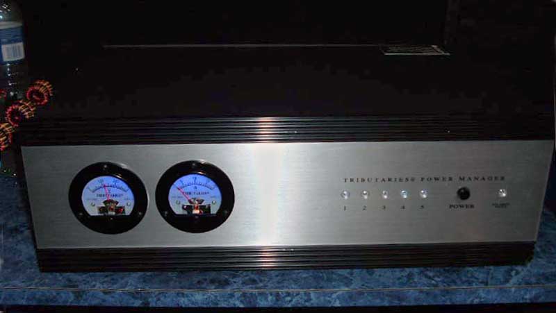

Tributaries gave these units a retro look. They used a brush treatment on the front; horizontal heat sinks on top and on the bottom, and utilized meters with soft blue lights inside. There are blue LEDs on the front panel that indicate when the corresponding outlet pairs are on. It's a very simple and elegant front panel without much clutter.

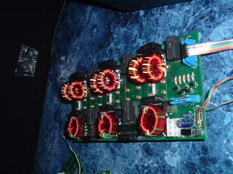

Inside look at some of the filters in these power centers.
