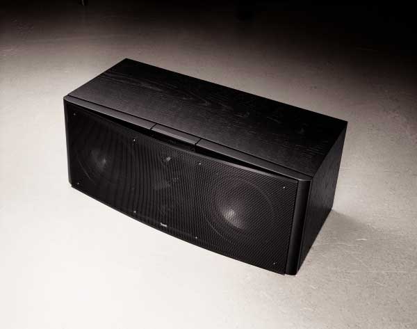

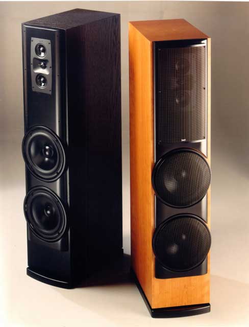

The XA 60THX is a tower version of the XA 1900THX, the first ever THX Ultra2 LCR. Designed for freestanding [XA55THX] applications the XA 60THX will hold its own in any two-channel application or anchor a multi-channel system with the companion XA 55THX center speaker, the AMC 900THX or the SR30THX surrounds and the ICS Sub24.
All three new THX Ultra 2 speakers employ Snell's exclusive eXpanding Array (XA) technology that is capable of delivering a very broad and even vertical dispersion. The eXpanding Array's design is a tweeter sandwiched between two mid-range drivers mounted over and under a single aluminum done tweeter, sometimes referred to as an MTM array.
Both the XA 60THX and the AMC 2000THX's MTM array consist of dual 2.5-inch midranges and a 1-inch aluminum dome tweeter mounted on a separate aluminum plate. This MTM array is coupled with two 8-inch high output woofers, capable of tremendous output providing bass response to 30Hz for the XA 60THX and to 60Hz for the AMC 2000THX. The XA55THX uses the same MTM array, however, it is coupled with dual 6.5-inch woofers since extended bass is not as critical for center channel dialog and effects and is rated with a bass response down to 55Hz.
