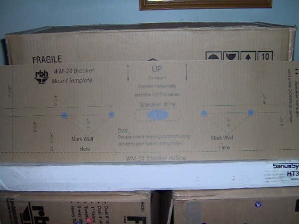

02 - Template.jpgRight out of the box, its no-brainer obvious the WM-24s and WM-30 are on-wall speakers well suited for pairing up with flat panel displays (FPD). Whether you’re upgrading the factory installed speakers your FPD arrived with (and what genuine audioholic hasn’t thought about it at one time or another) or perhaps piecing together a surround sound system and prefer wall mount to floor standing, the WMs are tailor-made for the job. Though both the WM-24s and WM-30s can be used stand-mount, they come with wall mount hardware and an excellent template that’ll aid in making the install a trouble-free process.

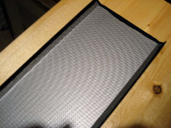

03 - Grille Cover.gifIt’s also obvious, right out of the box, the WM-24s, WM-30 and the FM-45s are well built, sturdy products. For example, pry off a front grill cover and you’ll discover it’s made of perforated metal stock covered by a thin, stretchable fabric. The latter is a particularly clever design feature in that the material can absorb the occasional snag and snap right back into place. Easy to clean, too.

Wall mount speakers necessarily require the extra effort, come setup time, of installing the hardware on the wall to which the speakers are to be affixed. So there’s going to be a bit more initial time & effort investment required than that needed when dealing with floor standing or stand mount speakers.
Installing the mounting hardware can be a tricky challenge and success demands careful attention to the details. (This holds especially true when dealing with masonry). On the other hand, if it’s to be a DIY job you’re likely in the fortunate position of having available a variety of placement options to explore prior to bolting the things permanently in place. Similar to floor standing or stand-mount speakers, it often happens the final location is nevertheless a compromise between sonics and aesthetics. Taking the time to explore or rather audition the sonic merits of different locations is recommended.

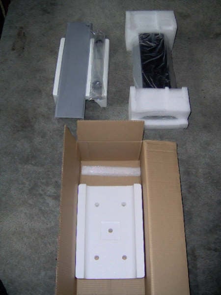

04 - Unpack1.jpgThe WM-24s and WM-30 were exceptionally well packaged, with both the products entirely encased within the shipping carton by the packing material. The quality of the packaging design is a key detail. After all, no matter how good the speaker, if it arrives busted up, its useless and now you have to deal with the delays and potentially hassle-rich process of returning the item to the manufacturer.
Both the WM-24s and WM-30s shipped with a manual, mounting hardware and a second grill cover and mounting template. The template is well diagrammed & annotated and is well worth holding onto should you need to move the speakers at some point in the future.

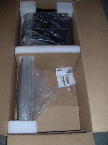

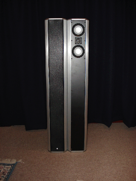

The FM-45s were packed likewise, with the system base & tower segments of the speakers well isolated from the carton walls. The system shipped with the usual accessories (manual, etc). Laying the cartons out flat before opening them is recommended; you don’t want to find out after opening them in the upright position that an FM-45 is upside down and about to topple out on your feet.
05 - Unpack2.gifOnce out of their shipping cartons, positioning the FM-45s was fairly straightforward, having previously identified the general preferred location by walking the room. “Walking the room” entails having an assistant, whose voice you’re familiar with, walk the room reading from a textbook. Sitting in the main listening position and listening to the tonal changes that occur in the voice as the assistant walks the room will help locate appropriate locations for the speakers. Once placed, some positional fine tuning will likely be needed. After that, time to listen!

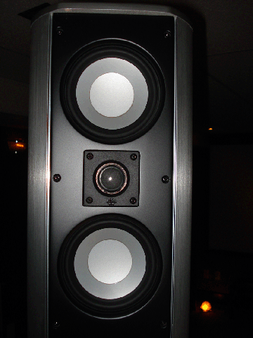

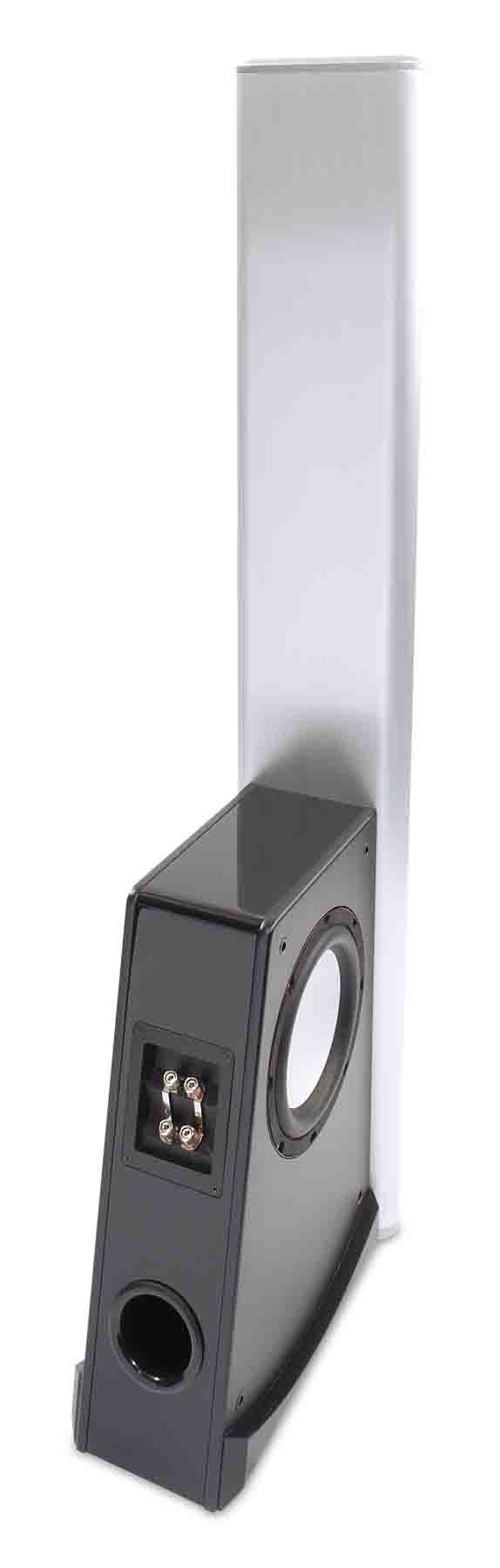

The FM-45s feature a D’apollito M-T-M arrangement, with the drivers mounted near the top of the tower, the 1” silk dome tweeter ~ 38” above ground level. The two 8” woofers are arranged in a side-firing configuration, ported out the back of the cabinet. 2 pair of 5-way binding posts, configurable for biamping via a pair of included removable jumpers. The cabinets are built of MDF and metal stock, lined\stuffed where appropriate and wired with 18AWG cable throughout.

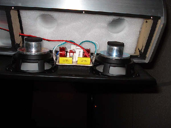

The woofer pair is wired in series and connects directly to the bottom two binding posts. There are no passive components in the signal path between the woofers and the binding posts; RBH chose instead to rely on the inherent lowpass amplitude response of the series-wired drivers to determine the lowpass characteristics of the LF system’s response. A purist approach if there ever was one!
The highpass amplitude response characteristic of the LF system’s response is controlled not only by the duct fastened into the back of the cabinet but also by two ports found in the bulkhead that partitions the LF cabinet from the tower. One such port can be seen on the right interior side of the cabinet showing in the photo above right.
Mid-way or so up the tower an internal bulkhead separates the 4” midrange drivers & tweeter from the woofer. Both woofers and midranges feature aluminum cones and half-roll surrounds. The mids are wired in parallel and the tweeter features a series blocking cap in the circuit that serves to protect it from electrical damage. The crossover itself is located between the two mids and directly behind the tweeter, as seen in the photo, below right.

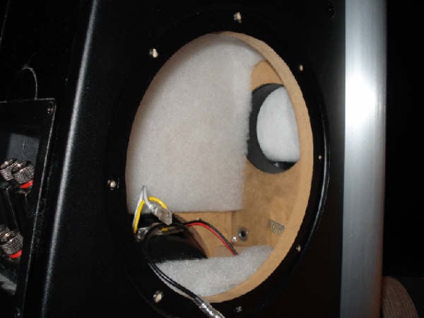

The WM-24s and WM-30 are similarly constructed, sharing many design features with the larger FM-45.  Like their larger sibling’s M-T-M tweeter/midrange configuration, the WM-24s & WM-30s have their driver complement arrayed in an M-T-M, or more accurately, W-W-T-W-W. Though the FM-45s are vented and the WM-24s & WM-30s are not, the latter make use of a pair of passive radiators that function in much the same way as does a port. Similar hardware, similar specs - such as sensitivity, frequency response & so forth - and you’ve got what amounts to, sonically speaking, a well matched set. More on this later.

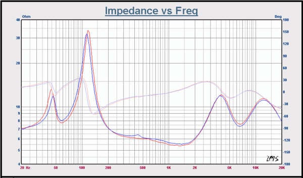

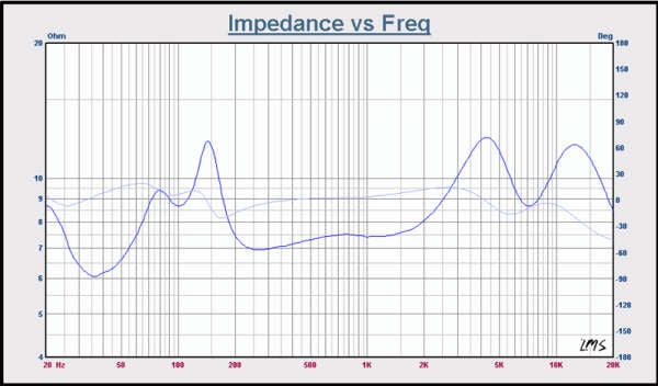

Figure 1. Impedance & Phase. FM-45 at left, WM - 24 & WM-30 at right.
At left in the FM-45 graph we see a local minimum at just under 40 Hz. It’s also a global minimum in that at just under 40 Hz we also find the minimum system impedance at just over 6 ohms. To the right of that point, at just over 100 Hz we find another local minimum of about 8.7 ohms. This saddle point, located as it is between the two local z peaks (found at 80 Hz and 150 Hz) arises as a consequence of the electrical interaction between the woofer/ported cabinet system and the midrange/sealed cabinet system.  The saddle point found at just over 7kHz is likely due to the MF/HF drivers setting up an electrical resonance with the highpass section of the crossover network. Also noteworthy is the system’s electrical phase response: Maxing out at 19.7 degrees (64 Hz), reaching a minimum of -45 degrees (20kHz). In the critical 300 Hz – 3kHz range the phase deviates a maximum of 15 degrees from 0.
At right are the impedance curves of the WM-24 & WM-30. At left in the graph we see the typical peak-trough-peak impedance response of an LF system employing passive radiators. In the case of the WM-24 & WM-30 the 4” active driver pairs are augmented by a pair of passive radiators. At right we see a z peak-trough-peak, located at roughly 500 Hz lower, though similar in appearance than that seen in the FM-45 impedance plot. As was the case with the FM-45, it is likely due to the MF/HF drivers setting up an electrical resonance with the highpass section of the crossover network.

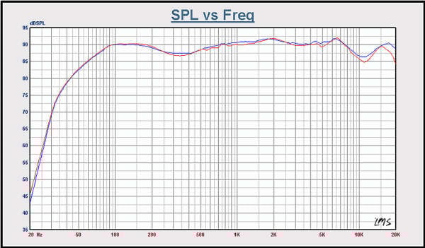

 Figure 2. Amplitude response plots. FM-45 at left, WM-24 (Red) & WM-30 (Blue) at right.
1m, on-axis, 2.828Vac, dB re 20 µPa. 1/12th Octave smoothing used for enhanced visual clarity.
In Figure 2 we see at left the amplitude response plot of the FM-45 and at right the amplitude response plots of the WM-24 & WM-30.
Using the measured 89 dB sensitivity as a reference, the FM-45 produces a response plot that remains largely within +/- 3dB of that figure from about 45 Hz to 20kHz, stepping slightly ( a fraction of a dB) out of bounds only in the 5kHz to 9kHz range. Apparent in the plot is the slight upward tilt of the system’s amplitude response noted earlier in the subjective assessment portion of this review. Depending on where you’re seated in relation to the FM-45s this can present as a slight emphasis on detail. The effect diminishes, of course as the listening position is shifted off-axis.
The FM-45 LF response you’ll likely encounter in practice will certainly be influenced by placement and your listening space’s acoustics. Factoring in room gain and so forth, useful extension to somewhere in the neighborhood of 40 Hz seems a reasonable outcome. LF extension to at least the 40 Hz – 45 Hz range is often judged as essential should a loudspeaker system aspire to successfully presenting the listener with a musically satisfying experience. And in this case, the FM-45 meets those criteria.
Referencing the measured 90 dB sensitivity figure, the WM-24 & WM-30 both produce amplitude response plots that remain largely within the +/-3dB range from about 70 Hz to 20 kHz, stepping out of bounds by a fraction of a dB only in the 10 kHz to 12 kHz region. Sounding slightly reserved in the upper mid-bass/lower MF region and likewise in a portion of the HF region, the WM-24s and WM-30 otherwise presented similarly in many ways, sonically speaking, to the FM-45.
Noteworthy in the measurements is the high degree of similarity between the amplitude response of the WM-24 & WM-30. There also exists, especially in the 500 Hz to 20 kHz range the already mentioned family resemblance in both products to the FM-45.

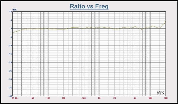

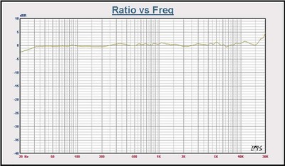

Figure 3.  WM-24 & WM-30 amplitude response match comparison
In Figure 3 we see a comparison between the amplitude response plots of the WM-24 & WM-30.
Across the majority of 20 Hz to 20 kHz range they match to within 1 dB.  This partially explains the rock-solid stability of the images and the exceptionally clear pans across the soundstage presented by the WM-24s and WM-30 during the listening sessions. Excellent!

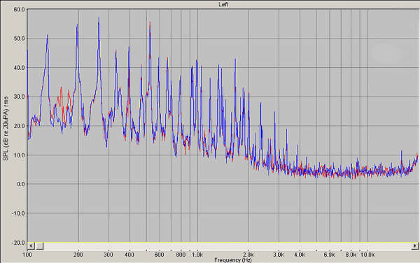

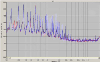

Figure 4. Spectral component comparison of two WM-24s
In listening to the various RBH products it was clear how well matched, in terms of timbre, they are to each other. Curious to take a closer look at this, a spectral analysis of the two WM-24s was done.
Above in Figure 4, the red & blue plots are the spectral components or harmonic profile of the two WM-24's acoustical version of a chord, sampled from Gershwin's "Rhapsody in Blue" as played on a Steinway Concert Grand piano.
When broken down into the individual spectral components the strong similarity between the two is immediately apparent. (The bits that look out of whack in the 150 - 180 Hz range in the red plot are owing to environmental noise). Here we see another reason for the impressive rock-solid stability of the images and the exceptionally clear pans mentioned earlier. Clearly, a high degree of quality control has gone into the selection and assembly of the components comprising the WM-24s. Overall, it’s fair to say RBH has in fact attained a substantial degree of timbre matching with these products. Excellent!
