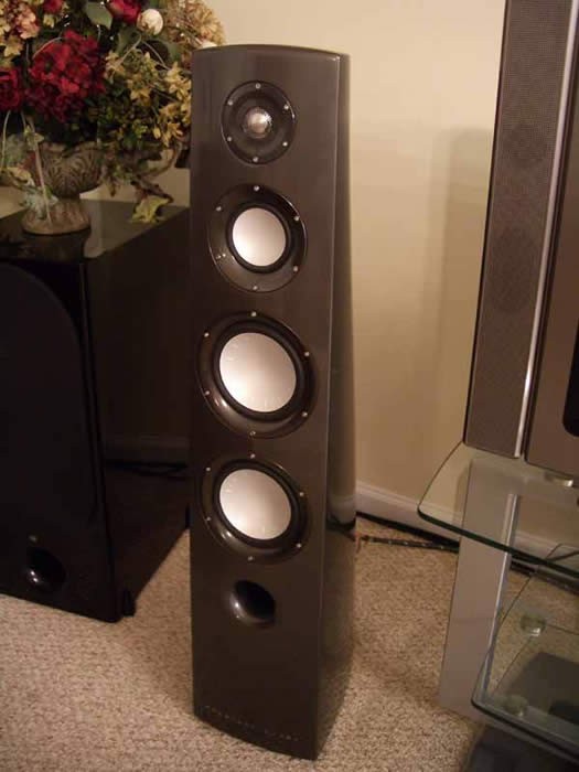

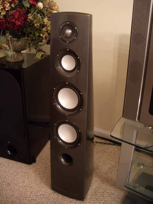

Performance 6 Unpacking and Build Quality
It was last year at CEDIA (yes last year, 2004) that we caught our first glimpse of the Performance 6 loudspeakers from Mordaunt-Short. The reception was incredible as the rather elegant looking speakers were shown off and the new era of Mordaunt-Short was emerging in phoenix-like fashion. Rather than make excuses as to why it took us so long to get to a review, let me just say that it was well worth the wait and allow you to read on.
Unpacking and First Impressions
When the Performance 6 loudspeakers arrived via FedEx Ground I had no idea they would be as large and heavy as they proved to be. The speakers ship face down, individually boxed and surrounded at critical points (top, bottom, middle) by firm foam which is molded to the contours of the loudspeaker. A thick nylon carrying strap is placed within the box around the entire loudspeaker assembly. Via two convenient slots in the top of the box you can perform a simple two-man lift using the straps. These are the first speakers I' ve encountered that sported such a packaging system. It really worked and made sense, considering each speaker weighed in at just over 66 lbs each (much more with the packing materials).
Once I opened the boxes and removed the top protective board and foam, the speakers were shown to be wrapped in a protective cloth and gloves were even provided to aid in setting up the system without leaving visible oils or fingerprints on the polished enclosures. Spikes are available for the bottom as an option and could be screwed in- though users should take care to only tilt the loudspeaker down while on carpet or some other cushioned surface- and only on its side, never on its front or back. I quickly "spiked" the Performance 6 speakers and set them up for a closer look.

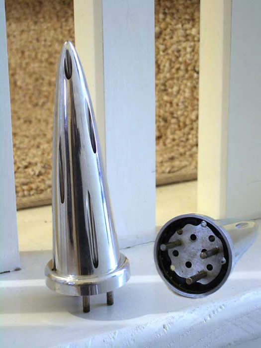

The
                            tweeter is a favorite of Graeme and the design team and was specifically developed to address phase
                            issues associated with traditional tweeters and speaker placement. The noticeable venting
                            that
exists on the rear of the aspirated tweeter
is tuned across 1.5 octaves and arranged in
                            a logarithmic spiral such that these slices of the frequency spectrum are intended to recombine with
                            the originating sound and enhance spatial imaging and overall response. It is designed to have the
                            advantages of adding a back fill tweeter without adding distortion.

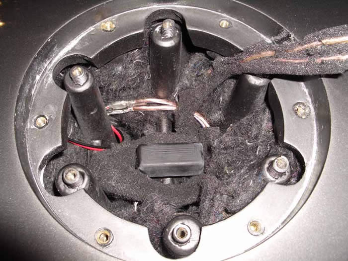

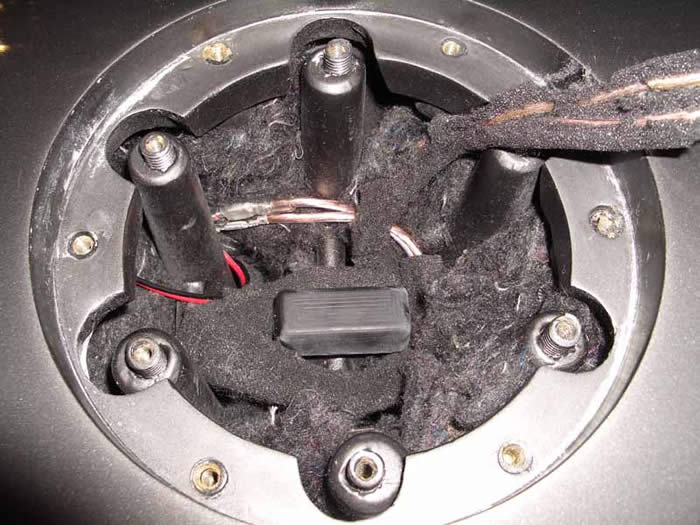

The damped 2nd order crossover was especially developed to address the unique nature of the driver complement and enclosure. It is mechanically isolated at the bottom of the loudspeaker and uses polypropylene capacitors. The goal was complete driver integration and minimal distortion. Very slick-looking 3-way nickel-plated bullet style terminals offer the option of bananas, bare cable, or spade connectors. These are possibly my favorite binding posts to-date and I'd love to see them on more loudspeakers (where practical). They can be easily turned, fit banana connectors easily and securely and lock down resolutely.
 Notice the driver is never connected directly to the front baffle.  |
 The midrange driver has a molded basket and CPC driver.  |
 The dual woofers are magnetically shielded with a removable rubber gasket that covers the magnet structure.  |
 Notice how the voice coil attaches to the CPC.  |
 The tweeter passes through the entire enclosure, essentially floating in mid-air.  |
 The crossover is located in the bottom of the loudspeaker, solidly attached to a thick metal base.  |

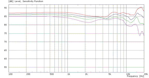

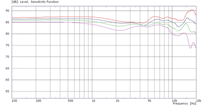

Though the Mordaunt-Short's are a relatively efficient loudspeaker (89dB 1/watt/meter). They appear to be tuned at around 35Hz as specified in their literature. Their impedance profile is reactive in midrange and the overall impedance leans more towards 4 ohms rather than 8 ohms. Thus we recommend partnering these speakers with a solid amplifier that can put out an honest 150wpc or more into 4 ohms with a reasonably low output impedance of under 150mohns for the entire audible bandwidth.
Red trace -
on axis
Blue Trace -
15 degrees off axis
Green trace -
30 degrees off axis
Purple trace -
45 degrees off axis
The tweeter level appears to be set a bit too high as indicated by the +3dB bump at 15kHz (on axis measurement). Though in our extensive listening tests, we never found this to be fatiguing or overly colored sounding. The Performance 6 speakers measured best at 15 degrees off axis, maintaining a ±2dB window from 100Hz to 20kHz. This partly explains why Clint found they sounded best with only a modest toe in. The downward trend in the 2-5kHz region, coupled with the slightly hot top end may also explain why Clint found the upper midrange to be a bit recessed sounding compared to his RBH Sound reference speakers. In any event, the family of on/off axis curves indicate excellent polar response and a very wide listening window which is what Clint experienced when putting these high performance speakers though their paces.
