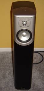

Tweeter: 1”
Dome
Midrange: 6 ½” Cone
Woofer: 10”
Cone
Crossover Frequencies: 100Hz, 3000Hz
Crossover
Slope: 24db/octave
Recommended Power: 35 – 200
watts/channel

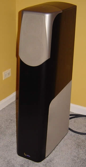

Dimensions (HxWxD): 37.38” x 8.69” x 16.75”
Weight (each): 71.5 lbs
Enclosure
Type: Rear Ported
- Detailed, natural sound that will reveal your best recordings.
- Crisp transient response.
- Stylish, well constructed cabinets.
- Unforgiving of some recordings.
- Tweeter/midrange grille is flimsy.

The Kappa 600's were engineered and manufactured by Infinity in Denmark, originally for the European market. They were available in the United States for a time, and are still available in Europe. Product information for the Kappa series is available on Infinity's international web site .The Kappa 600's are floor-standing speakers with a narrow, tapered enclosure just over three feet tall. The cabinets are finished with furniture grade Danish veneers in maple, cherry, or the review pair's black ash and weigh 71.5 pounds each. The grilles and baffles for all the variants are a contrasting gray/silver. The front baffle is sloped back at 5 degrees to provide phase coherency between the midrange and tweeter and has rounded corners to minimize diffraction effects. The speakers have gold plated dual binding posts with large gauge wire jumpers allowing for bi-wiring/bi-amplification. The crossovers use air core inductors in a low loss design for increased power handling and reduced degradation of sound quality. Threaded carpet spikes are provided to stabilize the speaker on carpeted floors.
The cabinets are formed of ¾" to 1" MDF with wood veneer. The inside of the cabinets are completely covered with foam to provide internal damping. Horizontal bracing couples the sidewalls together at several points for additional rigidity. All the internal wiring is done with 16 gauge, braided copper wire with soldered connections.The speaker is a three-way design with a driver compliment that consists of a 1" dome tweeter, a 6 ½" cone midrange, and a 10" side firing cone woofer in a rear ported design. This woofer placement allows for the narrow front baffle to improve imaging in a dedicated left/right speaker configuration. Crossover frequencies are at 100 and 3000 Hz, effectively making the system behave similar to a two-way system with a passive subwoofer. All the drivers use Infinity's Ceramic Metal Matrix Diaphragms (CMMD) for the cones.
