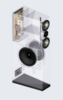

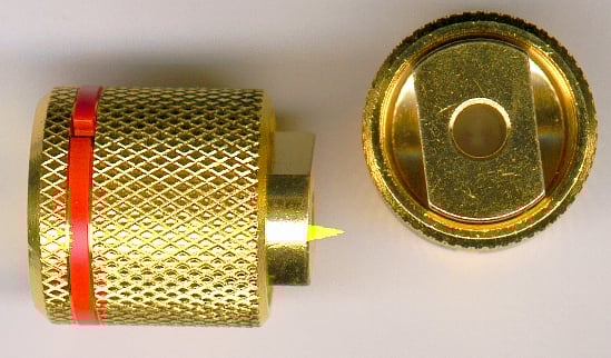

DC-Technology high end cabling with FastAudio Compact 6M gold-plated biwiring/bi-amping terminal, side firing woofer, cabinet 32mm multilayered MDF, 5 chamber system in asymmetric sandwich design
  • Incredible cabinet build quality
  • Esthetically appealing design
  • Trapezoidal cabinet to reduce standing waves
  • Hefty side firing woofer
  • Built in isolation base plate for easy installation
  • Passive radiator tuned below audible range for excellent bass integration
  • D'Appolito style driver configuration
  • Impressive bass performance for design
