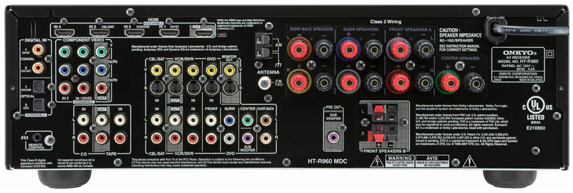

The Onkyo HT-R960 has the ins and outs you'd expect on a mid-fi A/V receiver. As we indicated above, the four HDMI inputs will handle HD sources effortlessly and pas them to the single output, with both audio and video being read from the sources - a big improvement over some of Onkyo's lower HT-R receivers. Dual component video inputs means that legacy products will also be able to get tied into this receiver - and there's no need to connect both component and HDMI to your display since the receiver offers video upconversion to HDMI thanks to the Faroudja DCDi/Edge processor. There are also three other composite video inputs and S-video connections. In addition to these video inputs there are dual stereo inputs for CD and Tape (hey, what's that?) and two each of optical and coax S/PDIF connections.
Note the 7.1 analogue inputs but no preamp outputs or iPod docking connector
In terms of speaker connections, this model provides 5-way plastic binding posts for all primary (left/right/center/surround/surround back) speakers, but the Front B speakers get spring clips. This is not uncommon at this price point, but realize that spring clips of this type do best with 18 gauge or higher (smaller) cable. What we were surprised about was the lack of ability to reroute the amplifiers for a second Zone or bi-amping. The HT-R960 receiver instead uses Speaker B for a second "Zone" but if used, disables the Surround Back speakers. You can also not independently select a source for the Speaker B output. It was interesting to note that the less expensive HT-R570 included support for Sirius satellite radio, while the supposedly stepped up HT-R960 does not.

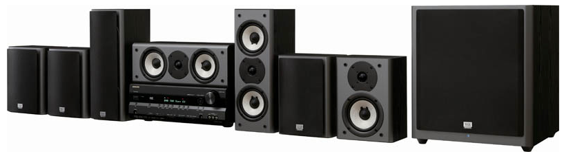

In this system the 2-way front left/right/center speakers differ from the rest in that they have two 5" drivers in addition to the soft dome tweeter. Each speaker is about 17" tall and 6" wide, so placement should be a breeze in the front of any room. They have a gray finish that contrasts the black speaker surrounds. The center channel is an identical form factor, but oriented sideways in an MTM fashion for better horizontal dispersion. The fact that these speakers step up to a two-way system, and the inclusion of a dedicated 1" tweeter means that you'll get clearer audio with less distortion. Plus THX has at the very least ensured that they play all the way up to spec without audible distortion. The mains and center channel produce frequencies, according to Onkyo, down to 50Hz.
The Surrounds and Surround Back speakers are similar in design to the mains and center except that they utilize a single 5" driver. They are still rated to extend down to 60Hz. The front speakers weigh in at around 11.5 pounds each and the surrounds are just under eight pounds apiece. All speakers in this system are made with wood enclosure material.
Subwoofer
The included sealed (acoustic-suspension) sub is active, meaning it has its own amplifier and must be plugged into an outlet, and contains a 12" front-firing driver. The box itself is roughly 15" x 18" x 17" making it a pretty big box, but still small enough to hide away if necessary. A blue LED on the front tell you when the sub is active. We'd recommend keeping it up front if possible and moving it around to find the location that yields the best low frequency response. This is a solid sub, and we've seen many subs in similar systems come with a 10-inch driver - which is often not big enough (in an inexpensive system) to go down to that critical <25 Hz range. Onkyo claims a frequency response of 20Hz with this sub, but provides no specs on how it came to that measurement. It would be safe to assume that the sub is at least 3dB down at this frequency. You can upgrade this subwoofer with an aftermarket solution at any time. Some recommendations are the Axiom Audio EP125 ($375), Aperion Audio Bravus 8A ($319), and the Velodyne Impact-12 ($369).

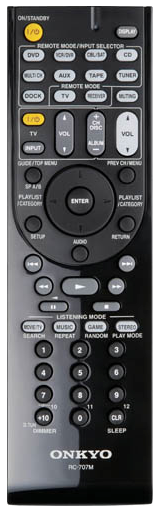

The remote that comes with this unit is sufficient enough to handle most basic systems (TV, DVD player and the AV receiver) but don't expect to have it operate your DVR or more sophisticated cableTV functions. It works via preprogrammed codes and cannot learn commands from other remote controls. The layout is intelligent, with direct access over inputs and the four listening modes (which can be further toggled by repeatedly pressing each button.) There is no backlight on this remote, so plan on using it during the day or learning where everything is for nighttime use. There is also a button to control a second audio Zone. A good universal remote should land this thing in storage pretty quickly - and that's our recommendation for most entry level remotes.
