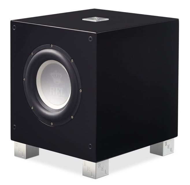

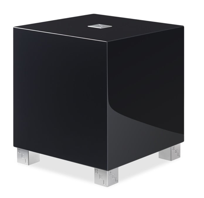

One of the keys to getting a lifelike sound from a sound system is getting the low frequencies right. However, the physics of low-frequency playback is, in a sense, far more demanding than that of higher frequencies. Low-frequency sound reproduction necessarily involves the movement of large volumes of air, and that is difficult to do without building a correspondingly large enclosure. This often runs into conflict with two realities of our homes: living space is precious, and we want our homes to look nice. So compromises must be made if we are to fit a sound system with true bass capability into our homes. Rel’s T/i series subwoofers make this compromise as painless as possible. They do so by their very reasonable sizes and also by being an extraordinarily nice-looking line of subwoofers.
The relatively modest size of the T/i subwoofers does not mean they only have a modest sound. Huge woofers aren’t absolutely needed to move lots of air; woofers of moderate size that have long throw can push a lot of air, but the engineering challenges of these kinds of designs become much more demanding. However, this engineering challenge is one that Rel has long since mastered. In addition to using long-throw drivers, the T/9i and T/7i subwoofers also use passive radiators to assist in the lowest frequencies of their operation. Passive radiators are a great way of getting deep bass from a small enclosure. They are a solution to getting the same deep bass that a vented enclosure can get but without the necessarily larger size of the cabinet and also acoustic artifacts of vents. As with everything in loudspeaker design, there are trade-offs, and the trade in using passive radiators is that they are a bit more costly than simple sealed or vented designs.

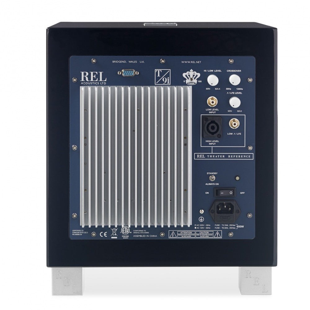

Rel has long been lauded in audiophile circles as a high-end subwoofer manufacturer. What in the T/i series merits this lofty status? Aside from the gorgeous cabinet, one unusual aspect of their design that exudes high-end is the use of true A/B amplification. Rel has to be one of the few subwoofer manufacturers that still use A/B amplifiers. Most other subwoofer manufacturers use some variant of class D amplifier that, while more efficient, introduce more opportunities for error and non-linearity than class A/B. Class A/B amplification produces a purer voltage waveform. Rel states their amps use high-current power supplies and huge toroidal transformers, and that their amplifiers are extremely reliable with very few needing repairs.
Another rare aspect of their design is the implementation of a high-level Neutrik Speakon input. Speakon-terminated cables are greatly preferred for their reliability and security over standard banana plugs or bare wire. Unlike most other subwoofer manufacturers, Rel strongly encourages the use of high-level connection over the use of the LFE input alone, for a more seamless blend with the main speakers.

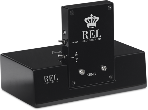

If you've got a space you really want to locate one of these subs but don't have a prewire run for it, don't sweat it. You can add their compact Arrow wireless kit (MSRP: $199) to any REL T/i subwoofer to be free from the confides of a cable at no penalty in audio performance.
