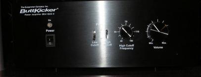

The kit contained from left to right: the BKA1000-4 amplifier, ButtKicker LFE shaker, mounting plate, 14AWG wire, "Y" splitter interconnect, single lead interconnect, mounting hardware, and installation instructions. The bulk and heft of the amplifier really surprised me. With this in mind, I could not wait to see how it was constructed. Removing the top cover and looking inside, I felt as though I was opening the hood of a muscle car from the 1960's. The ButtKicker LFE amplifier has a huge Toroidal-based power supply (note the quarter in the picture shown below for reference). Installed just behind the power supply are the oversized filter capacitors and, running almost the entire length of the chassis, is the oversized heat sink. The Class D amplifier delivers a whopping 1100 watts into a 4-ohm load and 2100 watts into a 2-ohm load - fully doubling its power output.The front faceplate of the amplifier is thick-machined aluminum. There you will find the power on/off switch, high and low pass filter switches, variable cross over control, and large volume control.
