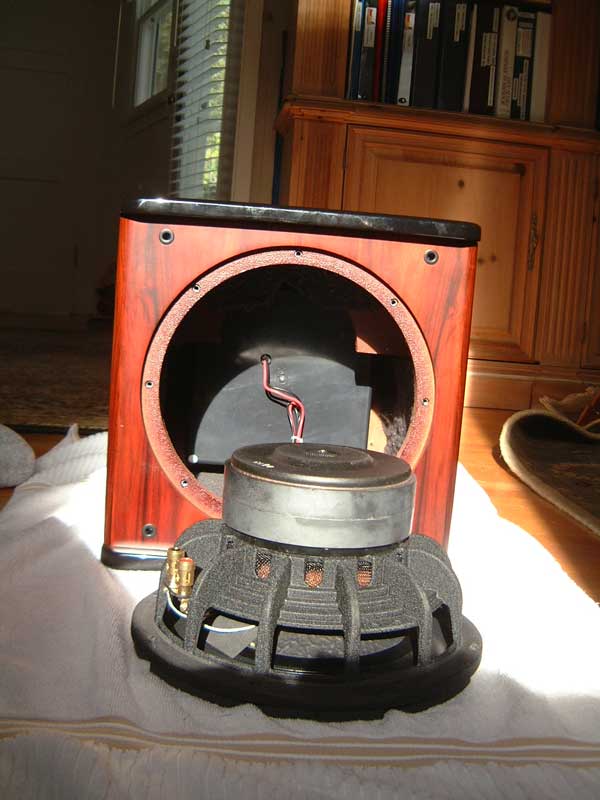

Drive unit:
(1) 10" die-cast woofer w/ 2" voice coil and laminated, black anodized, aluminum/pulp composite cone

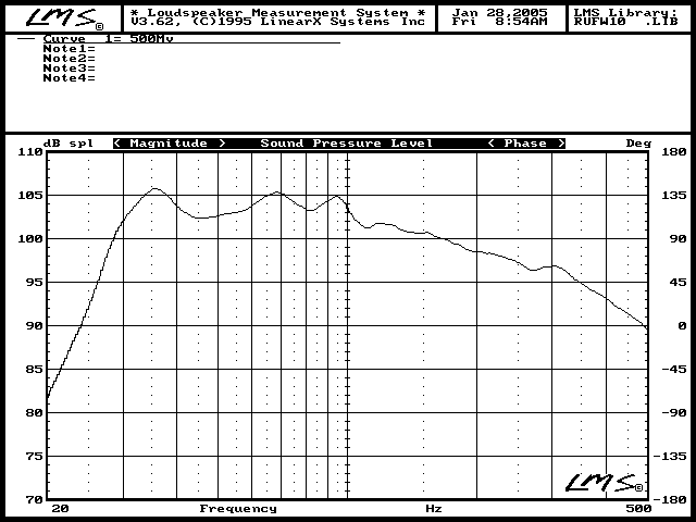

Frequency Response:
Rated 25Hz -150Hz ±2 dB   Measured 30Hz - 108Hz ±1.75dB

  • Die cast woofer frame with beefy motor structure
  • Bass can get loose at high volumes
  • Proper EQ set-up requires extra equipment
  • Pre-amp section overloads if input exceeds 500mV RMS causing low frequency response non-linearities.
