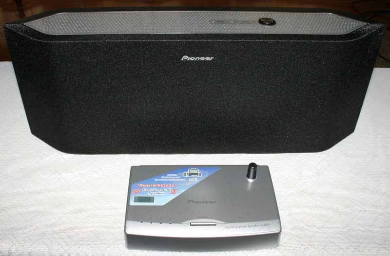

-4600 is a 5.1 home theater system with digital wireless surround speakers operating at
2.4GHz (coincidentally this is the same frequency used for wireless 802.11g as well as many cordless

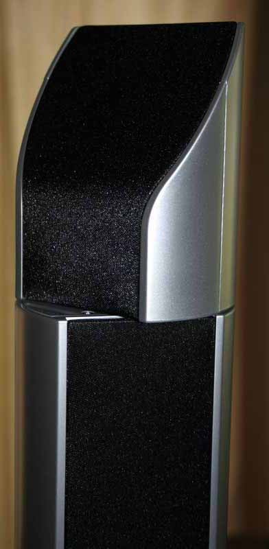

telephones). The Front main speakers are a slim line 2-way design. They include detachable/pivoting
surround speakers for optional 3-spot surround. 3-spot surround is an optional configuration that Pioneer
includes for those situations where placement of wired or wireless surrounds is not practical. It

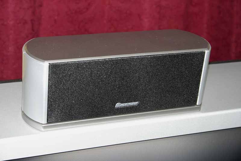

The center speaker is a very small two-way design with a footprint so tiny that it should fit easily on top of most displays. Add some Velcro and it could fit on top of most plasma displays as well. The sub-woofer contains a 6 1/2 inch driver that is a passive design. The sub receives its power from the receiver, unlike active subwoofers that contain a built-in amplifier.

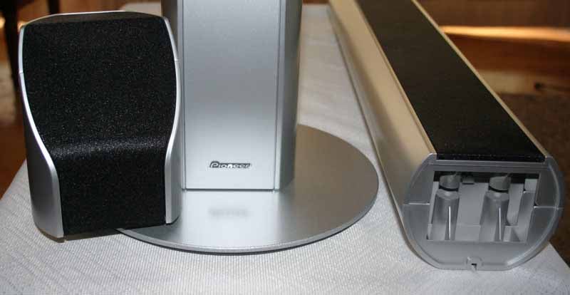

The front main speakers are in three sections and offer an optional cover plate if you are planning on using the removable small surrounds as wired loudspeakers in a 5.1 configuration. Setup consisted of attaching the base plate to the lower section, connecting the middle section, then fastening the small speakers on top. Everything is held securely with screws.

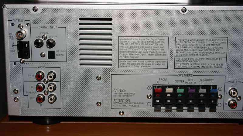

Looking at the back of the receiver, one will notice the lack of connections. There are three digital inputs, two analog inputs, one analog output, speaker outputs, wireless surround outputs, and AM/FM antenna inputs. There are no video inputs and no subwoofer out. This system is designed to work together and not be upgraded. If you are someone looking for a starter system to build upon, this is not the system for you.

a small to medium sized listening room. The rear surround unit was placed high on a shelf in the back of
the room directly behind the listening area. It conveyed a sense of depth but no real left and right
separation. I suspected that this would improve a bit in a smaller room in which the side walls were a
little closer to the surround speaker.

Bilbo narrating. Dialogue was clear, but a little thin or hollow. This is due, no doubt, to the very
small driver size of the center channel speaker. In a smaller room for which this system is suited for,
