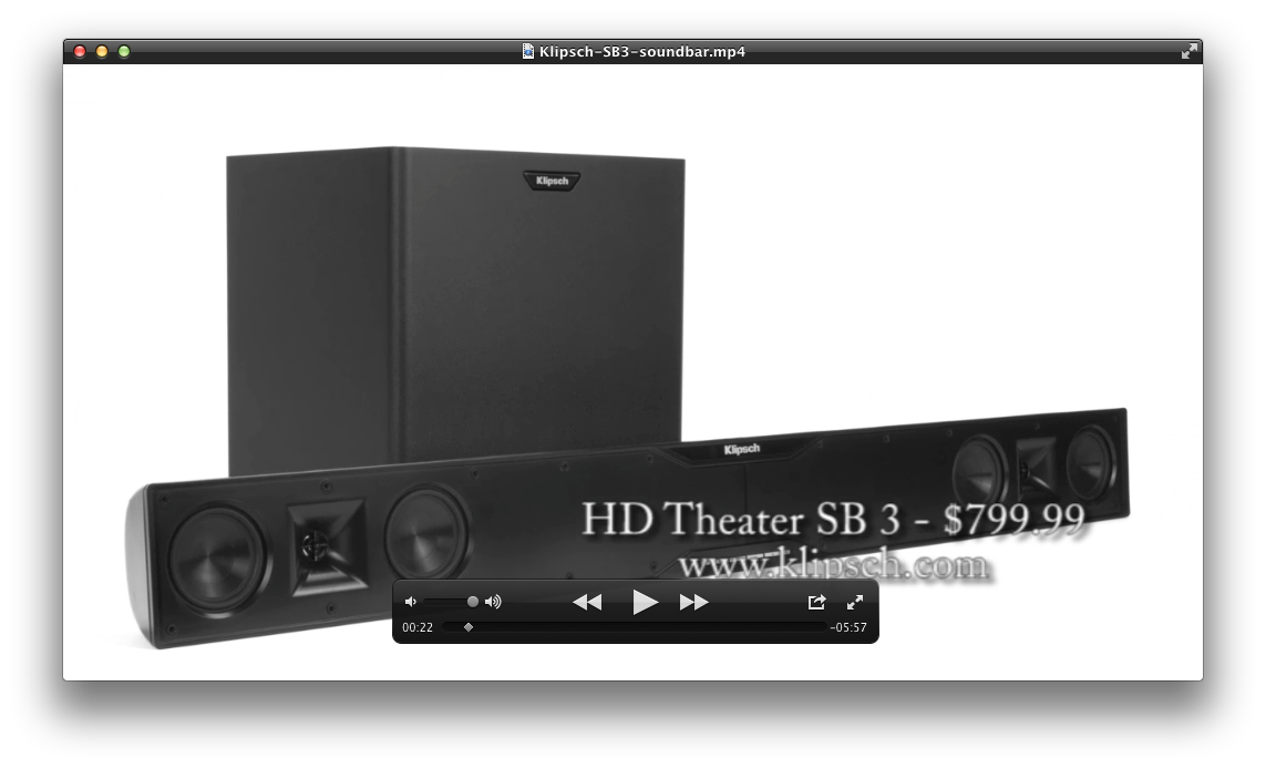

Every speaker has its place, whether large or small.  Free-standing speaker advocates are free to cast their derision, but for folks looking to improve on the anemic sound baked into modern flat-screens, without giving up that near-zero footprint, soundbars are an intelligent choice. In the HD Theater SB 3, Klipsch has taken their trademark horn design, coupled it with a wireless subwoofer, and cooked up an easy way to improve sound with minimal impact on aesthetics.
In the Box
The box was larger than I expected, mostly to accommodate the 10" subwoofer enclosure.  The subwoofer and sound bar were each clad in styrofoam and a poly-bag for secure shipping. Included are power cords for both the subwoofer and sound bar, mounting feet and template, a 5 foot RCA cable, and a 5 foot optical TOSlink cable. Integrated keyhole mounts on the SB 3 can be used to mount the speaker on the wall. They also serve as anchor points with which to slide the included feet snugly into place for table top applications.
The sound bar measures 44" wide x 4.6" high x 3.1" deep, with the feet adding less than an inch to the height and depth. It weighs just 12.5 lbs., however. The semi-gloss black finish, married with removable, inset, cloth grills, looks great and seems well-constructed. Two sets of drivers were arranged on either end of the sound bar, each consisting of a single horn tweeter flanked by a pair of 3.5” midranges. My first impressions were that this was a solidly built, quality product.

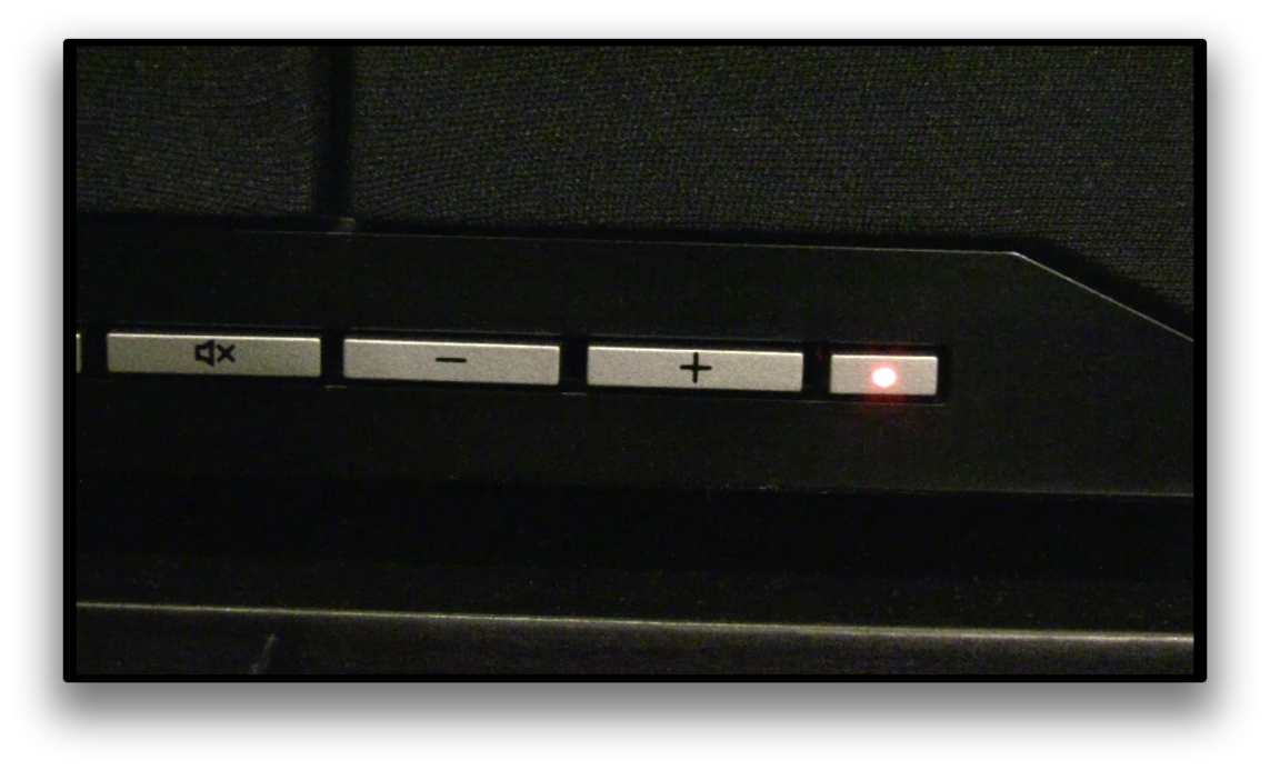

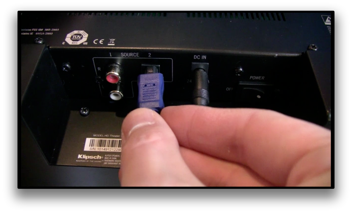

The width matched my 50" plasma almost perfectly. The control panel consists of a multi-color status LED for 3D mode and remote programming, buttons for source, mute, volume up and down, and a 2nd multicolor LED for identifying the selected source.  There is no power button; the soundbar sleeps automatically after approximately 10 minutes without a signal.  On the back, there were connections for power, RCA and Optical inputs, and a power switch.  On the right end of the soundbar is a third input, a 3.5mm jack for easy connection of a phone or music player.

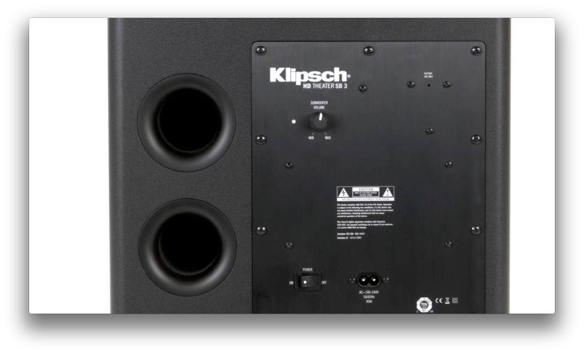

The down-firing subwoofer is 13 inches wide x 13.5 inches deep x 14.5 inches tall and weighs 25lbs. It's finished in a near-seamless matte black vinyl with rounded corners. The only controls on the subwoofer are a power switch and gain control as the subwoofer connects wirelessly with the soundbar.  A rear LED shines blue when powered on and wirelessly connected, and red when in power save mode.

Setup was foolproof: You simply connect your input(s) and power cables, power on both the subwoofer and the soundbar. They link wirelessly within a few seconds.  The Quick Start guide didn't list which LED colors corresponded to which source, so there was a little trial and error with the source button to find the optical input.  There is no auto-setup routine for level matching the subwoofer to the soundbar, so the Type A's will need to break out an SPL meter and some test tones, while the Type B's will just adjust to taste.
The Quick Start guide does provide a step by step on remote programing.  The Klipsch HD Theater SB 3 has the useful feature of learning your TV remote's signals so that you can use a non-learning remote that was included with your television. Basically, you push a combination of buttons on the soundbar, press the corresponding button on your remote a few times, and, voila, your existing remote now controls your new Klipsch Sound Bar.

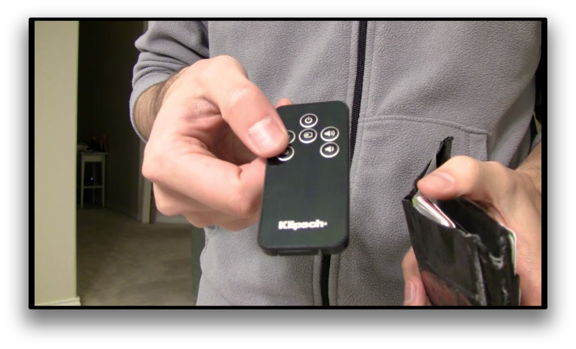

Of course, you could use the included "credit card" style remote.  However, limited ergonomics, button batteries, and a form factor that encourages consumption by your couch cushions makes this an unappetizing proposition.  The included remote does add 2 additional buttons, a power/standby and a 3D mode.  This is the only way to engage/disengage the 3D mode if you don't have a learning remote as there is no 3D button on the soundbar itself.  This seems like an unwarranted exclusion, in my opinion.  I would have liked to have seen a hard button for the 3D mode in case the diminutive remote is broken or lost.

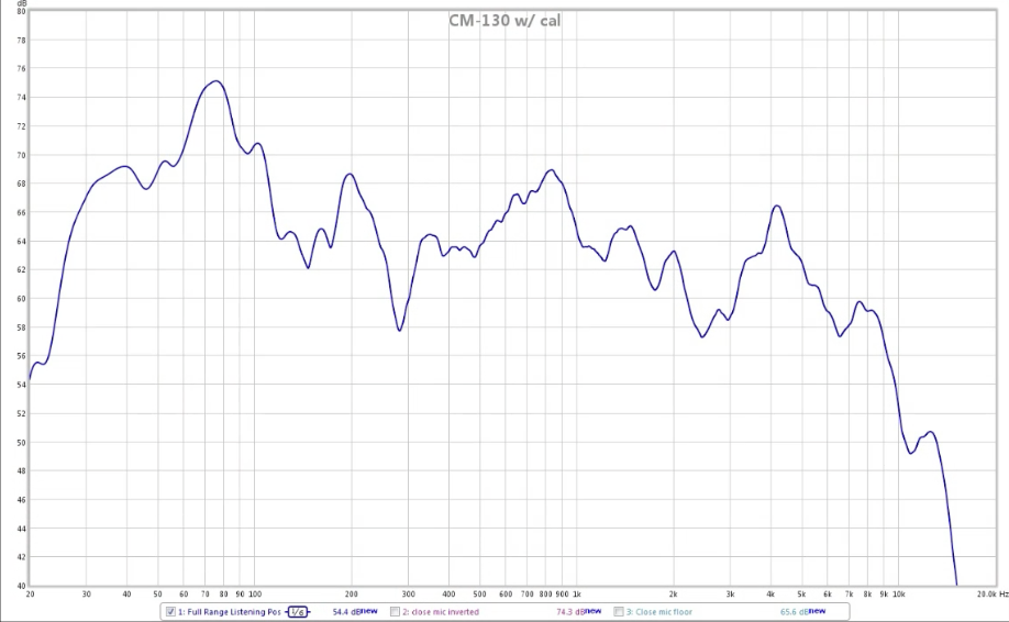

Power consumption for the sub plus soundbar was under 20 watts while in use, and about 1 watt in standby according to my Killawatt power meter so regular use won’t break the bank.  A measurement from the listening position with a Galaxy CM -140 meter showed in-room response down to the high 20Hz range, inline with the Klipsch specs.
 room response
At it’s highest volume setting, from my listening position, the soundbar was able to produce 82dB using broadband pink noise.  In real world use in my room, I found max volume to be sufficient for casual to moderate listening, but I would have personally wished for a little more headroom for more dynamic content in large rooms, even at the expense of some irregular frequency response.
