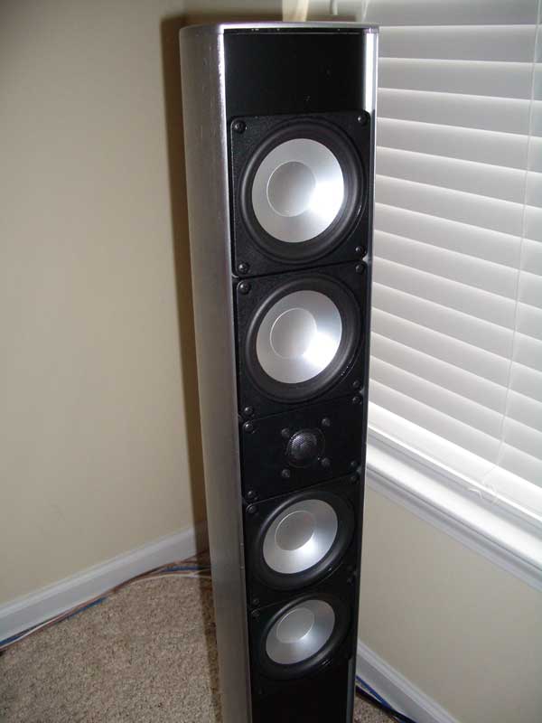

CD 300
Floorstanding speaker - $2,000/pr
Engineering Principle: 2½-way
Bass reflex system
Nom. /Music power handling: 110 / 170 watts
Frequency
response: 30 Hz - 30 kHz
Crossover frequency: 400 / 3.300 Hz
Woofer: 2 x
4" (110 mm) aluminum
Midrange: 2 x 4" (110 mm aluminum
Tweeter: 1 x 1" (25
mm) aluminum
Nominal impedance: 4-8 ohms
Dimensions: 4.8'' x 47.2'' x
6.3'' (12.3 x 120 x 16 cm
Weight: 26.4 lbs (12 kg)
Enclosure finish:
brushed aluminum silver
Cover: Silver metal grill
Special features:
Magnetically shielded, aluminum speaker base plate

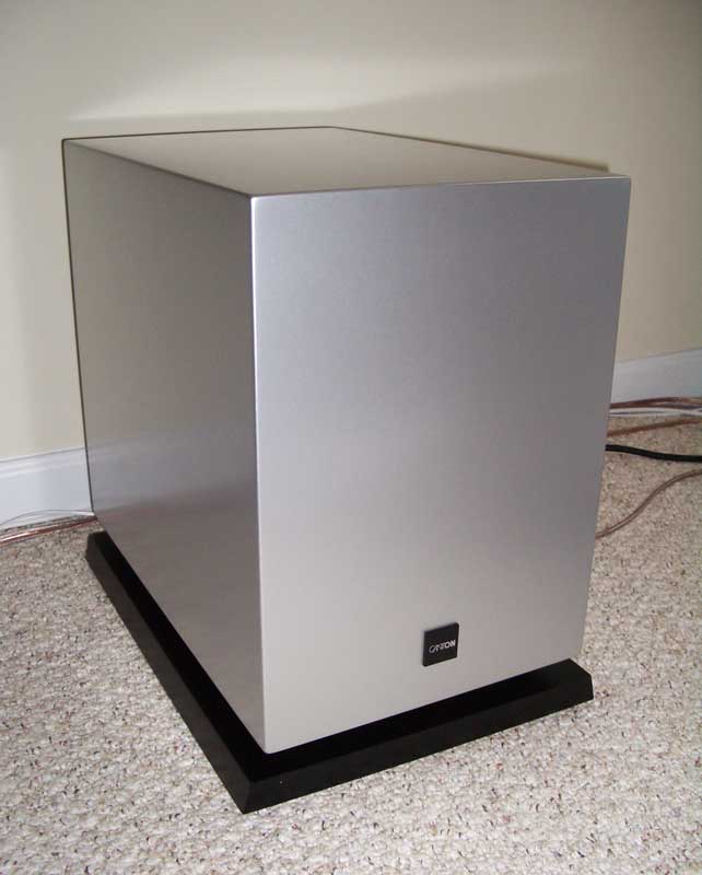

Karat AS 200 SC Active Subwoofer -
$1000/ea
Engineering Principle: Bass reflex
system
Nominal/musical output: 140 / 200
watts
Frequency response: 22-150
Hz
Crossover frequency: 50-150 Hz
(adjustable)
Woofer 1 x 10" (260 mm)
Cellulose/graphite
Dimensions: 11.6'' x 17.7'' x
18.5'' (29.5 x 45 x 47 cm)
Weight: 50.6 lbs (23
kg)
Enclosure finishes: Lacquer graphite, cherry veneer, beech veneer, silver
lacquer
Special features: Downfiring woofer, magnetically shielded, adjustable
phase limiter, adjustable crossover frequency, adjustable bass level,
SC-technology

CD 300 towers are separate from the tower and screw on via three Philips head machine screws. The bases
are even indented so there's no way to misalign the loudspeakers in the stands. Each stand has a hole
in the base, allowing you to unobtrusively run a small gauge cable through it and further hide system

All speaker covers are silver metal grills and are quite easily removable. Simply slide a screwdriver or other flat object between the grill and case and gently pry the grill out. We liked the speakers with the grills on as well as off, but would suppose that since this system so favors an unobtrusive design, leaving the grills on would be the best option for aesthetics. Of course, if your television is black you might decide the opposite.
Build Quality
When you lift the CD 300 towers you will at once note their impressive weight and relative density. I wanted to take a look inside and see what Canton did with the enclosure and the drivers. As you can see in the accompanying picture, Canton used plenty of dampening material in the cabinets and the diameter of the motor structure on their 4" aluminum drivers are almost as big as the cones. Canton labels this a 2 1/2-way bass reflex system, meaning that each cabinet contains four 4" aluminum drivers and an aluminum-manganese ADT-25 dome tweeter. The top two drivers handle mid-range and bass while the bottom two, primarily handle bass frequencies. The idea is that this type of configuration will yield a much "bigger" sound from a smaller, narrower package. Canton claims that this design provides the equivalent surface area of a single 8" woofer, but in a narrower cabinet. If you do the math: Four 4" drivers = 4 x 2^2 x pi = 50.26" while one 8" driver = 4^2 x pi = 50.26" thus their claim is absolutely true. The CD 360 F speakers are a shorter but otherwise identical version of the CD 300 towers which also lack the front-firing flared port.The 4 mid-bass/bass drivers are a modified version of the 4" concave aluminum cones used in the Karat and Ergo lines. The difference is that the CD 300 Series needed to rework the motor structure in order to get the lower frequency response needed by the CD 300 and CD 360 F speakers. Each of the 4" drivers has a concave aluminum dust cap which Canton applies for reasons of better linearity and increased dispersion. The surrounds are formed from injected rubber and are quite sturdy, appearing to have longevity as a strong point.
The ADT-25 tweeter does something unusual in that it has a single structure for the dome and voice coil former to achieve better heat dispersion and avoid some of the problems with glued domes. Aside from heat benefits, the resulting structure also better maintains its shape during use and resists break up during high SPLs.
The AS 200 SC subwoofer surprised me with its performance considering its modest size. I wanted to peel it back and see just what was inside that yielded such a sizable response from a relatively small enclosure. Opening up the sub I was pleased to find that it was manufactured from 1" thick M DF and had some significant cross-bracing to stabilize the cabinet. In addition, there was ample dampening material to render the interior of the cabinet fairly inert. We were not surprised to see that the basket for the 10" cellulose/graphite driver was apparently made out of the same polycarbonate that we've seen before in Canton lines. They prefer this over aluminum or steel, claiming better stiffness across the entire operating range of the speaker and superior damping. The 140 Watt R M S amplifier, though not very powerful at this price range, seemed beefy enough to deliver the goods. The sub also featured adjustable level control, a variable 50 Hz - 150 Hz crossover and adjustable 0 - 180 degrees phase control. The AS 200 SC also features line level and speaker-level inputs and outputs.Canton CD 300 Series Setup and Listening Tests
