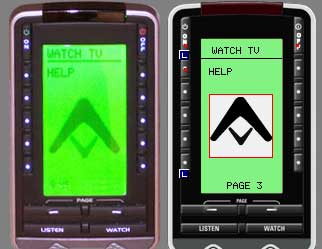

Custom Graphics
How about some more? The MX-950 also accommodates
basic graphics. You can select from the included library or import your own JPG or BMP files. We
snagged the Audioholics logo and entered it in to see how it looked and were rather pleased with the
results. A practical example of how to use a graphic would include setting up a "waiting" or
"macro-in-progress" screen that you could trigger at the start of a complex macro, then jump to the
destination page at the completion of the macro. It's these types of niceties that spell the difference
between a "nice remote" and a truly functional system controller. The graphic system is drag-and-drop
so you simply pull a file off of the image gallery, and drop it onto the remote screen where you want
it to appear. You may want to create a hidden page to house specific graphics that can be used during
the course of executing macros and commands.

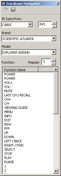

Database Navigator
The IR Database Navigator is a very direct way to call up discrete remote codes from any device in the Universal Remote Control library. Using the MX-950 Editor, simply select it from the Tools menu, choose the brand and model of the device control you wish to procure and then drag it to a button on the remote control. This is a very quick and easy way to utilize commands from devices other than the currently selected one without having to learn them (assuming the required codes are in the database).
