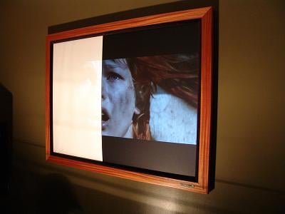

Using the Optoma H-72 1280x720 DLP projector currently under loan from Projector People for an upcoming review, we started with the daytime broadcast of the Winter Olympics and Speed TV . What, you were expecting Oprah or Days of our Lives ?
A word about screen shots: It was very difficult to obtain picture perfect screen shots of the screen with all the ambient light in the room. This had more to do with the limitations of our Olympus digital camera than the Visage screen's ability to display the image.
When we started viewing the projected images, it was hard to believe we were viewing a front projection system. The image looked more like it was being viewed on a conventional CRT television. Colors were bright, punchy, sharp, and vibrant.
The Visage screen did an absolutely wonderful job of overcoming the huge amount of ambient light that was abundant in the room. We did a direct A/B comparison of how well the screen stacked up against our 42 舡 Panasonic LCD TV in the same lighting conditions and were very surprised to find very little difference in the brightness of the image.
No monitoring surface is perfect when having to deal with direct ambient light. The Visage was no different. When the sunlight streamed through the open windows, broadcasting directly on the left side of the screen the image did wash out. It would also do the exact same thing on any monitor placed in that position. Even the CRT monitor, we are using to type this review!
The bottom line is that this is the first screen we have tested that you can view in the daytime and be able to achieve a watchable image. In fact, no other screen material that we have tested to date even comes close to the performance level obtained with the Visage. To summarize the experience with the Visage during daytime viewing, we felt like a vampire that had been cured from the nighttime curse and now free to enjoy the warmth of the sunshine. Watching Nascar and the Olympics during the day on a 92-inch diagonal was an exhilarating experience to say the least.

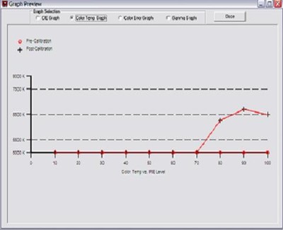

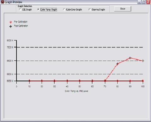

Projector Screen Measurements (Light Controlled)
We decided to take some calibration measurements in a light controlled environment. We were very pleased with the very solid color temp measurements we obtained using the New Optoma H-72 projector, previously calibrated close to D65 on a white screen. We obtained very solid readings from 20IRE to 100IRE with the H-72 and the Visage combination.
