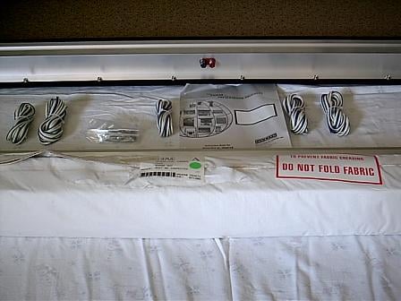

Upon opening the Da-Lite Acoustical Imager Screen box I found the contents well packed. The box contained the screen frame, screen material, frame mounting plate, instruction manual and five pieces of 18 AWG speaker wire. The manual is well written and easy to comprehend. The speaker wire supplied with the screen will work but I recommend the use of a larger gauge OFC wire. Laying out the frame upside down on the sheet, I noted that the frame was very well built. The speaker terminals mounted on the back of the frame are 5-way binding posts Though 14 gauge wire was the largest size that could be threaded though the post hole. If you use large diameter wire you will need to use spade or banana connections. Using a low torque cordless screw gun I was able to assemble the screen frame in just a few minutes.

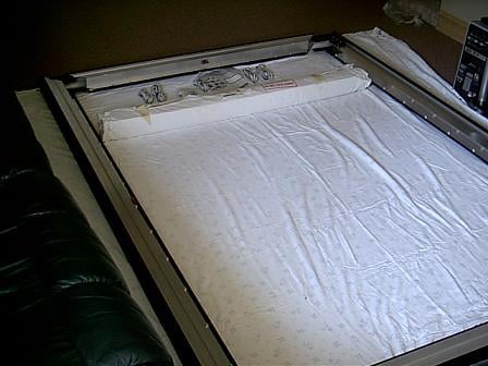

Moving along, I carefully unpacked the screen material, leaving it
rolled up. I began snapping it to the frame, unrolling the material a
little at a time and alternating from top to bottom as I snapped. Using
this method you are less likely to scratch the screen. Installing the
screen frame was pretty straightforward. You will need at least two
people to accomplish this task because the Da-Lite Acoustical Imager
screen is fairly heavy. With the weight in mind, you will also want to
attach the supplied mounting bracket to at least two wall studs and use
heavy-duty wall anchors for any mounting holes that do not line up with
studs. Once the wall bracket was attached to the wall, leveled, and at
the correct height, the screen could be lifted onto the bracket.

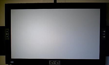

Now that the screen frame was assembled and the screen material installed on the frame, I gave the front of the screen a close visual inspection. The Screen frame is contoured like a picture frame and the black Pro Trim velvet coating made the entire frame look elegant and refined. The black velvet Pro Trim not only looks nice but it also absorbs spill-over and reflected light. The center bottom frame rail and the center side frame rails house the JBL speakers. The speakers incorporate dual 3-inch midrange drivers and one 0.5-inch titanium laminate tweeter. The grills are removable but leaving them in place allows them to blend perfectly with the black Pro Trim, making them virtually invisible from the seated viewing position. Only a small JBL logo on each grill gives away their location.

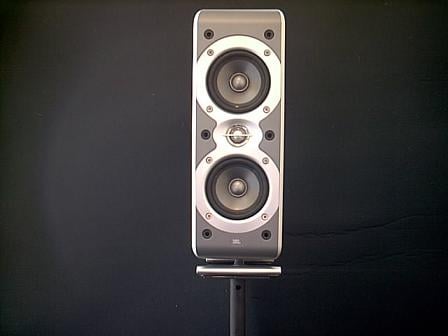

I then unpacked the second box which contained the 10 inch subwoofer and the two
                          surround satellite speakers. The satellite speakers use the same D'Appolito driver topography as the
                          speakers mounted in the screen frame: two 3-inch midrange drivers and one 0.5-inch titanium laminate
                          tweeter. Frequency response is listed as 100Hz-20kHz (-6dB) with a sensitivity of 88dB and nominal
                          impedance of 8-ohms.

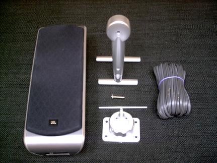

I want to be the first to congratulate and pat the back of the persons responsible for the design of this system. With regards to the satellite speakers, Da-Lite has thought of every possible installation scenario. The satellite speakers can be stand mounted or wall mounted. Da-Lite has even included the flexible wall mounts.
Here you see the speaker stand and the flexible ball mount provided with the kit. I commend the forward thinking by Da-lite for providing these options for installation. Standing only 11.5" tall x 4" wide x 3.5" deep, the satellite speakers' small, unobtrusive footprint make them easy to incorporate into any décor. Their elegant shapely design and modern silver/gray color should please even the most sophisticated designer.
The stand provided with the satellite speakers included cable management and concealed the spring post speaker terminals.

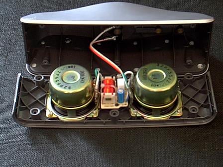

As is expected at Audioholics, we like to see how products,
regardless of cost, are constructed. Removing the hidden screws and
separating the enclosure, revealed the inner workings of the satellite
speaker.
I was very surprised and even a little taken aback to see very good components used in the construction of the speakers, considering the cost of the kit. Note the use of enclosed shielded drivers and crossover placed between the midrange drivers and above the tweeter. High quality, high strand count speaker wire was used from the connection terminal to the crossover. The ABS molded enclosure was very solid and well-built.

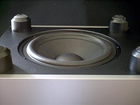

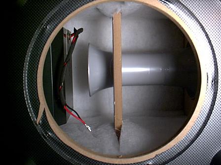

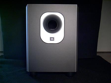

The 10-inch subwoofer included with the Da-Lite Acoustical Imager Kit matches the color scheme of the satellite speakers. The subwoofer is a ported design, measuring 20" high x 14" wide x 16" deep and weighing 35lbs.

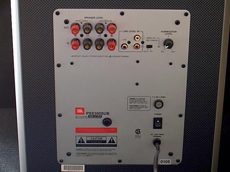

On the back of the subwoofer is the 150 watt RMS plate amplifier. The subwoofer amplifier has a dedicated LFE input, right and left analogue inputs for older Pro Logic receivers and pre-amps, speaker level inputs, an auto on/off input sensing switch, subwoofer gain control, and main power on/off switch. The line level inputs are gold plated - another nice touch.

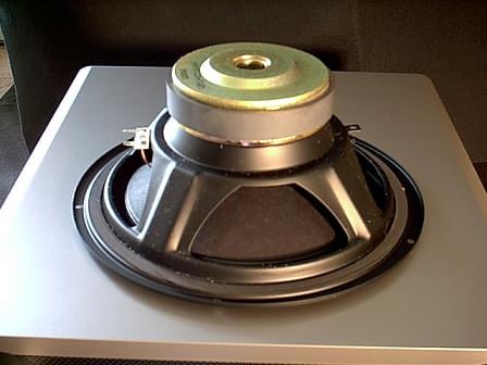

The 10" woofer is mounted on the bottom of the enclosure. Notice that the woofer is recessed into the enclosure instead of being surface mounted. Large rubber feet support the subwoofer and allow the consumer to place it on just about any surface. Removing the woofer, I found the build quality to be very good - surpassing my expectations by a wide margin. The enclosure is made from 0.75-inch MDF and has one shelf brace in the center of the enclosure. Note the use of a fluted port and polyfill on all sides of the enclosure to prevent resonance. Finding these design features in a subwoofer that is included in this kit was quite a shock. It was very refreshing to once again see Da-Lite's quality-oriented thinking.
The woofer installed in the enclosure was not massive but was well built. It features a stamped metal basket, a large spider and motor structure, and a vented pole piece for cooling. Note the use of a rubber gasket around the woofer basket: this helps control resonance and seals the woofer against the front baffle.Reassembling the speaker components, I began prepping the system for a viewing and listening evaluation. With budget always in mind I wanted to use components that were budget-oriented, though I believe this system would do just fine with higher quality components. I used the RX-V1500 receiver to drive the speakers, but realistically any of the good entry-level receivers would be sufficient (the RX-V557 or Pioneer VSX-1015 would be great entry-level choices at $399 and $499 respectively). The DVD player I used is the new Yamaha DVD-S657 DVD-A/SACD progressive scan player which has a $229 MSRP.

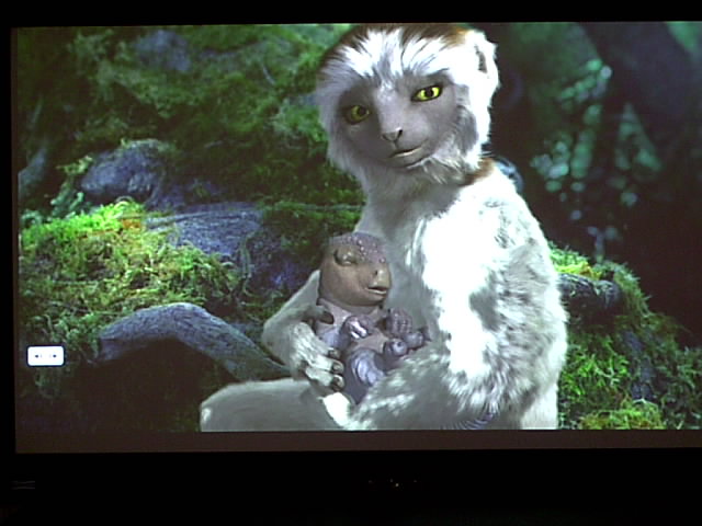

The first DVD I selected was Disney's
Dinosaur
. This is a near reference video quality DVD with excellent audio sound
effects and music score. As I began to play the opening chapters of
this DVD in my light-controlled room, it was readily apparent that the
Da-Lite High Contrast Cinema Vision screen material was a great choice.
The colors were very saturated and vibrant. It was as though I was
looking at a box of brand new Crayola Crayons. The blacks were inky
black and the whites looked natural. Walking around the room I noted
that the viewing angles were very wide at about 35 degrees. This
indicates that this screen material would also be a great choice for
rooms that have multiple seating positions that are off axis to the
center of the screen (or viewing positions that are above or below
desired screen heights). This also makes this screen very desirable for
those needing placement flexibility in the event you need to mount the
screen up high or down low.
Starting up chapter 6, "Meteor Strike", and turning the volume up on the Yamaha RX-V1500 to about -18dB, I began to listen as the chapter started. The sound of the system totally shocked me. The sound quality was right up there with any of the higher-end micro satellite systems on the market. Dialogue from the center speaker was clear, concise, and natural sounding. The music score sounded a touch dry from the right and left speakers but still very good. Surround sound information was easy to hear and sounded very spacious in the rear surround satellite speakers. The little 10" woofer filled my room with generous amounts of LFE as the meteors began to hit the island. The subwoofer did sound a little less composed and compressed compared to my reference subwoofers; but it still did a Yeoman's job of handling the LFE effects. What really surprised me was the amount of sound that this small system was able to generate in my room. It was more than enough to satisfy my listening level needs. As I sat there evaluating the speakers, it was hard to believe that I was listening to a small micro system and the thought occurred to me that this is definitely a cube speaker killer. The sonic performance of the Acoustical Imager thoroughly surpassed my expectations.
