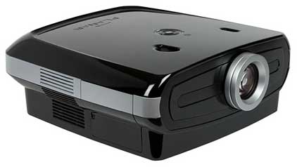

The PD7150 is a 720p DLP product; however it offers such advanced features as horizontal and vertical lens shift, large optical glass assembly, and robust (Pixelworks) video processing (plus it has discrete on/off IR remote codes). Even their near-entry-level PD7010 sports RS-232 support, dual digital inputs (HDMI and DVI-D), and a 12VDC trigger, making it more suitable for custom install use and advanced applications.
Overview of the Technology
The PD7150 doesn't offer any particularly groundbreaking advances, but it implements exiting technologies quite well:

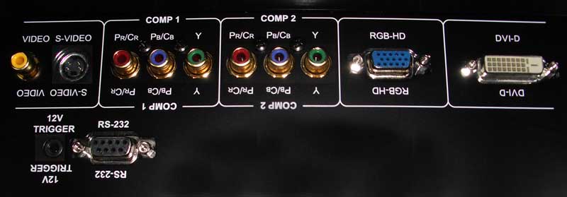

While there is no HDMI input (a bit odd in this day and age) the PD7150 does sport a DVI-D input in addition to dual component inputs and standard definition s-video and composite connections. A 12V trigger and dedicated RS-232C port separates this from many other entry-level units. Custom installers will have a unit designed with them in mind. For those looking to truly hide the wiring on an installation, DVI-D is a big potential problem, however with modular, field-termination-capable products like Impact Acoustics' RapidRun Digital this might not be such an issue.
The PD7150 has a unique door in the back that clicks open to allow access to the connections. Cables can be run underneath the door through a provided opening (in a ceiling mount scenario this would allow cables to come directly into the unit while hiding the connections from view. This is a very nice design and shows that Planar is doing more than just throwing in some projectors to the competition; they are listening and responding to their target market.

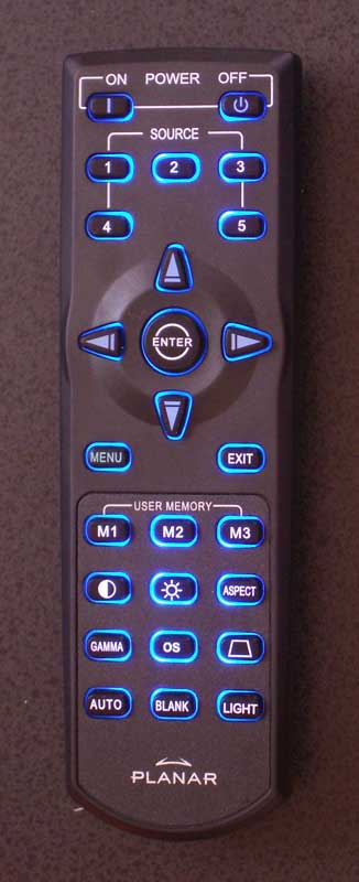

This remote is elegant, but has a few flaws. First and foremost, the 'light' button is located at the bottom right. Ergonomically this is easy to remember, but very had to get to with your thumb. Backlighting also doesn't engage automatically when a button is pressed - I've always liked this function on home theater projector remotes since they almost always get utilized in the dark.
The presence of discrete power 'On' and 'Off' buttons on the remote is a VERY welcome sight and it seems that Planar listened carefully to requests from custom installers. The programmable source buttons are a feature, but they are almost overkill. Labeled direct inputs might be a better way to go rather than having to remember which input is assigned to a number. In terms of importance, this rates about a '1' on a scale of 100… The remote was more than a tad finicky on angle and at times I had to stretch to get the unit to respond when mounted in a front projection, floor-oriented position. Menu delay was also an issue at times, though this was unpredictable and typically limited to such items as recalling the Memory Picture Settings.

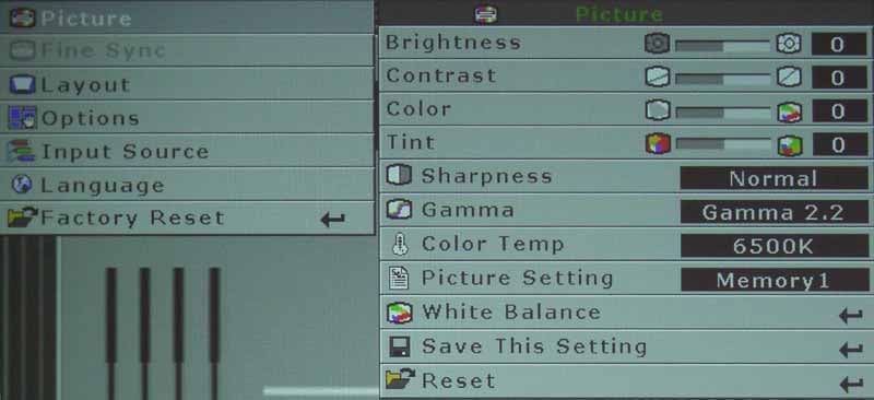

Picture Menu
Browsing through the Picture menu you'll have access to all main picture controls including Brightness, Contrast, Color and Tint. You'll also be able to adjust Sharpness (keep this on 'Normal' and Gamma as well as Color Temp settings. The Picture Setting control is for recalling one of the Memory positions (we could only get 2 working despite the 3 hard buttons on the remote control.)
Since the Planar PD7150 has no "Picture Modes" per se (i.e. Sports, Vivid, Daytime, Cinema, etc) you'll likely want to use the Gamma controls to adjust the unit for day and night viewing - at least until you can set up some stored calibrated Memory settings. Setting a Gamma of 1.0, for example, gives you the brightest image for daytime viewing of television in a room that is not light controlled. For cinema watching we found the default Gamma 2.2 to be a very good starting point. You may find different results depending upon your screen type and viewing room. RGB Gain and Offset controls are available under the designation "White Balance".

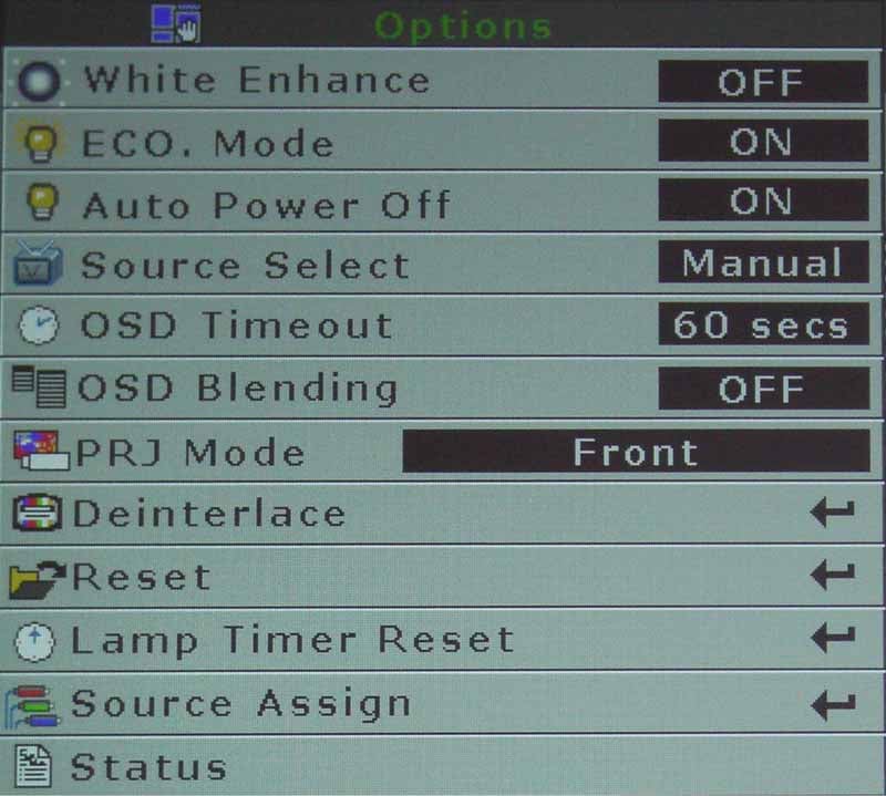

Options Menu
You may spend some time in the Options menu. Serving as a sort of 'catch-all' for important adjustment items, this menu permits access to lamp modes (ECO and Auto power off) and a White Enhance mode that basically steps up the Contrast to allow whites to appear more vibrant.
The Projection mode (front, rear, etc) as well as On-screen display settings can be found here as well. Deinterlacing mode settings, an important aspect of the PD7150 for proper functionality with DVDs, are also found here. It is very important to ensure you have the right settings here in order for 24 frame-per-second film-sourced DVDs to be accurately converted to 30 frame-per-second video. Another feature is the ability to assign sources to each of the 5 remote key positions.
Editor's Note: All of our primary evaluations were done using the 3:2 pull down Film Mode with Video on film (VOF) set to 'On' excepting times when we played with settings and gamma to tweak the projector and find out its capabilities and flexibility.
Everything else in the menu system is self-explanatory. Language can be selected for the on-screen menu system and you can do a factory reset from the top menu (unusual and a tad dangerous for overzealous 'clickers'). There is a nice way to monitor the input source format with horizontal and vertical timings (as well as the lamp timer). It also provides the firmware version (258.11.157 as of this review).

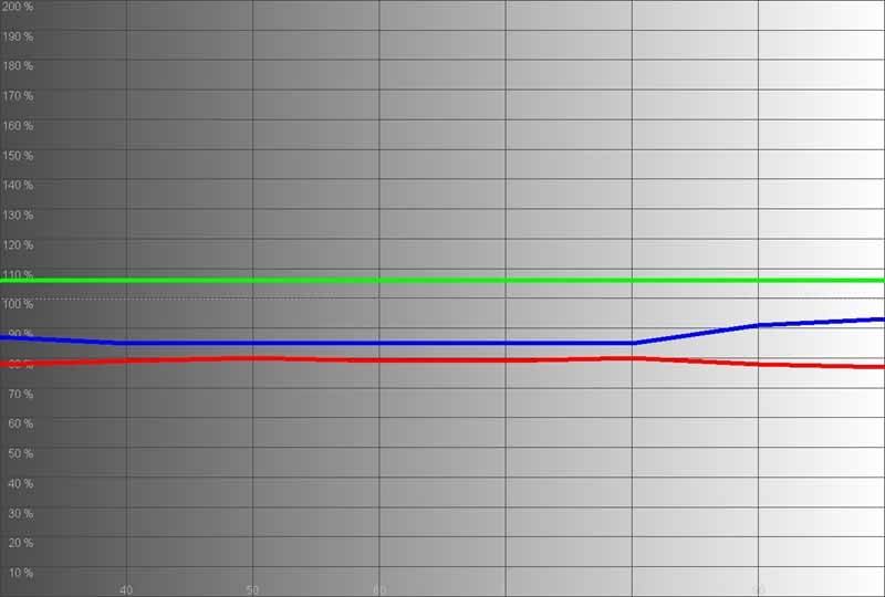

We utilized datacolor’s ColorFacts Professional 6.0 software to calibrate and measure the grayscale response of the PD7150. I was very pleased with both the starting configuration of the projector and the end-results of calibration. The process was painless and we were able to dial in our desired settings very easily.
Before Calibration |
After Calibration |

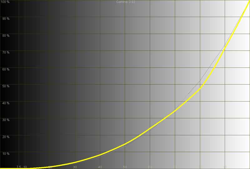

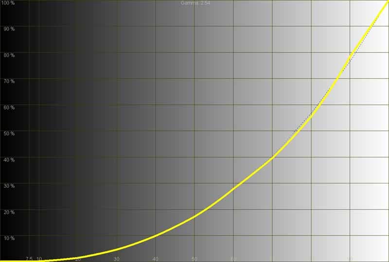

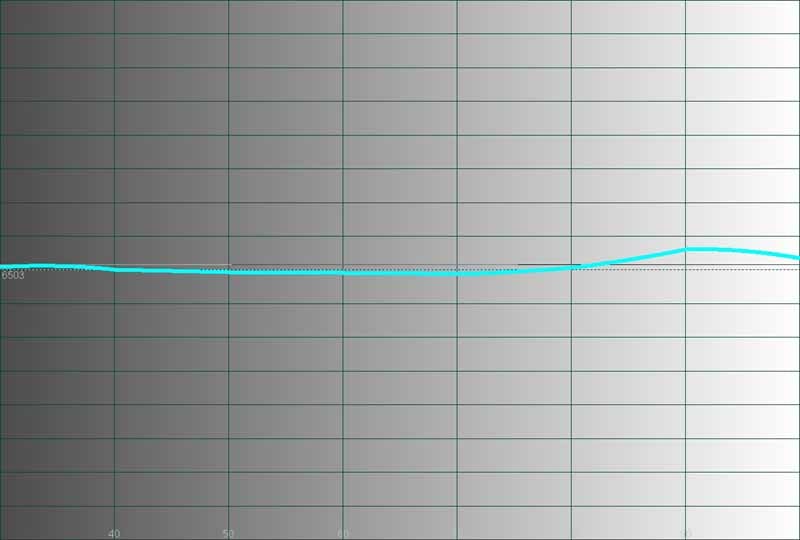

You don't want green to be your dominant color. Just about any other color would be better. When viewing real world images, the picture didn't appear to have a green tint. |

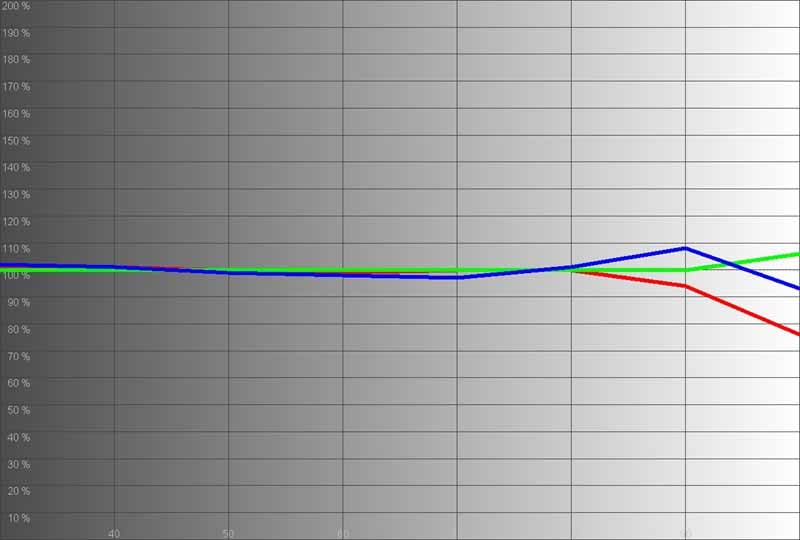

We were able to really dial in all but the highest extreme of the Planar projector. The calibration "stuck" better than most projectors I've tested of late. |
The initial luminance graph isn't bad except for a slight dip around 80IRE from what we'd be looking for. |
After calibration the chart is nearly spot on. |

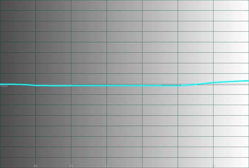

Color temp measured an incredibly "out of the box" accurate 6400K across most of the range. |
You can argue that dialing in the projector, while balancing the levels up to 80IRE, actually caused a slight shift into the 6800K range for 90 and 100 IRE. |
Only the very top end of the projector seemed to go a bit off during calibration and we noticed that backing down the Contrast and re-running calibration seemed to do the trick. Keep this in mind when you run this projector. Full Contrast ratio measured "off the charts" for my sensor's reliability but we know that the real world reading was better than 1400:1.
At maximum output, we measured over 36 cd/m^2 reflected off the 100-inch Stewart Studiotek 130 screen. Not the brightest projector we've measured, but it certainly does the job in a home theater setting. In ECO mode we showed a max of 29 cd/m^2 at 100 IRE. White Enhance mode should actually be 'On' according to our measurements as it yielded better and consistent color response overall.

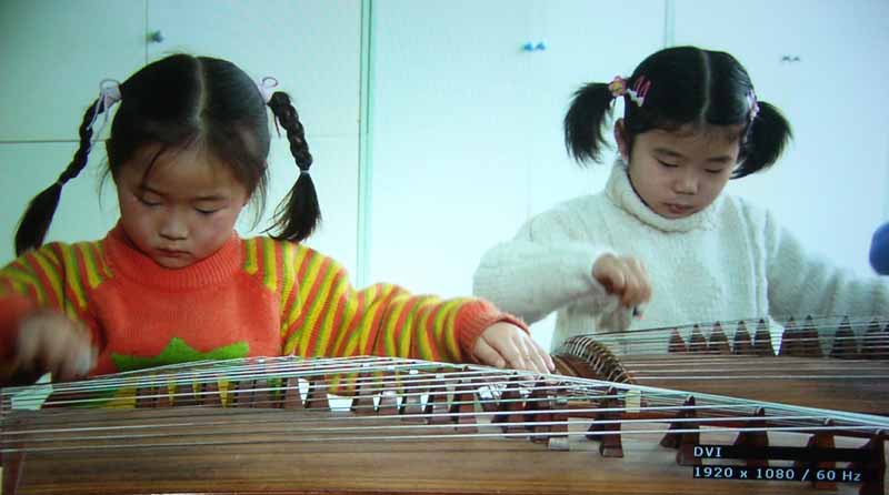

The PD7150 passed the AVIA Pro 2-3 Moving Zone Plate tests, but failed the Standard and 2-2 Zone Plate tests. I have not seen many systems pass the non 2-3 tests. The Deinterlacing settings had no affect on performance in this area (except of course for 2-3 where you need to have the 2-3 film mode engaged.)
We tested for rainbow effect (RBE) using the AVIA Pro Rainbow Dither test and found the PD7150 to be pretty good unless you darted your eyes around the screen. As with many other DLP systems, if you have a “white on black” shape or edge and you dart your eyes quickly across the viewing area, you’re going to see rainbows (if you are susceptible to this). In a lot of ways this is like the man who walks into the Doctor's office and says, "Doc, it hurts when I do this." Well, then, don't do that.

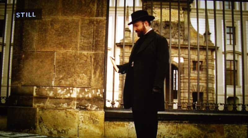

DVD: Jet Li's Fearless
There's nothing better than a good martial arts (Wushu) film - except for maybe a Samurai movie… Well, regardless, this action flick wasn't the best looking picture I'd seen all year, but it did have lots of great color and image depth. We viewed some other films for detail, but take a look at these images and note the excellent black levels captured to the best of my camera's abilities:
DVD: The Illusionist
This movie was the "clone" to The Prestige (in Hollywood all movies come out in topically-related pairs as an initial idea leaks and multiple studio clamor to get on board).

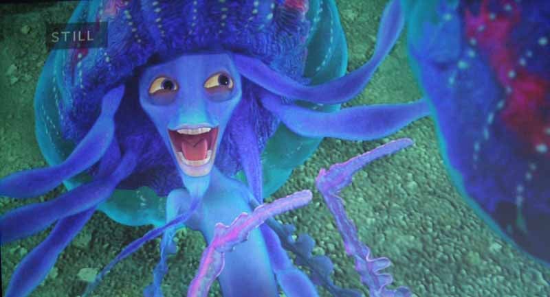

DVD: Shark Tale
It was now time for some color and edge detail. An obvious choice was Disney's Shark Tale, which has an exceptionally good range of colors and edges to check out the real world performance of the DCTI color edge enhancement feature. As with the test patterns, we still recommend this be set to 1 or 0, depending on whether you feel the enhancement bothers you, or simply makes colors pop more. It can do either based on your perspective. We noticed a tad more vibrancy when it was engaged, but it also had the effect of occasionally coming off as bad edge enhancement artifacts.

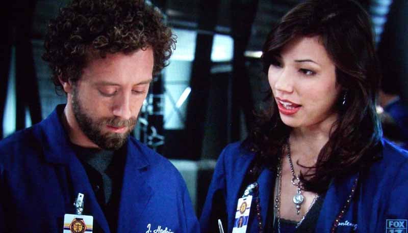

HDTV: House, Bones, Discovery HD
As a final series of viewing tests we watched several episodes of HD cable shows. House is one of the better shows on television in terms of clarity and detail (CSI: Miami is also very good).
