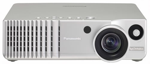

In most of our reviews we like to see hefty equipment but that doesn't necessarily hold true for a front projector. Sure, it is important to have solid construction and quality parts but a light weight projector can be attractive when you are hanging it from a ceiling. At only 8 pounds I found it very easy to attach to the ceiling mount at my parents house.

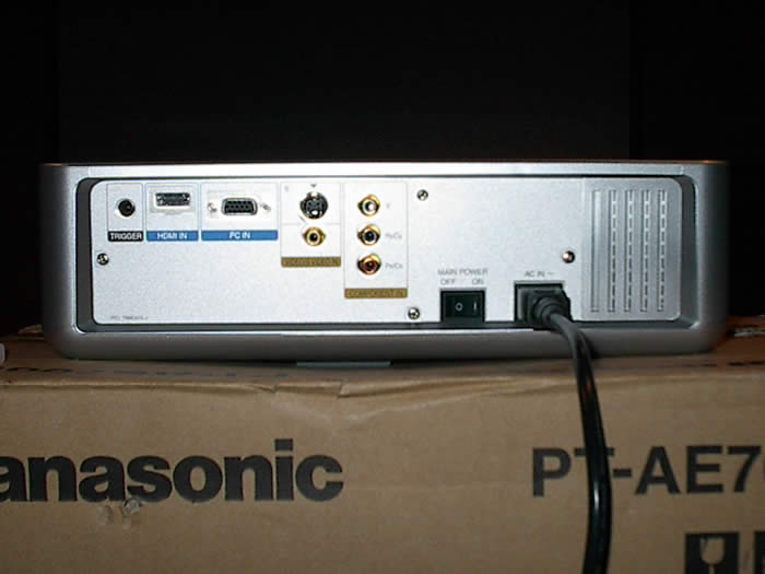

The rear panel was simple and uncluttered. The inputs consisted of HDMI, RGB (HD15), s-video, composite video and component video. There is also a 12VDC trigger which can be used to operate an electric screen. The component input used RCA connectors. No BNC connectors were available, however you could use the PC (HD15) input and a breakout cable to get RGBHV. The master power switch is located next to the AC input connector.

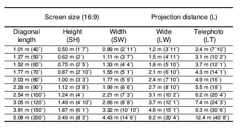

In my reference system I had the projector set up behind my first row seating at about eye level and about 15 feet from the 110 inch 16:9 diagonal screen. While thinking about the placement let me mention the fan. Although I certainly haven't experienced every projector on the market, this projector has to have one the quietest fans in its class. It was right next to my head and I could barely hear it, so it could be placed on a table top with no distraction. To connect it up I used a 25 foot Impact Acoustics SONICWAVE component video cable and a 25 feet DVIGear HDMI cable. I did not try the s-video or composite video connections. It may seem pointless to have these latter two connections these days but on my reference projector I need one because the Integra RDC-7 does not output the On Screen Display via the component video output so I ended up running an s-video cable along with the others. Here is the general table to give an idea distances and screen size.

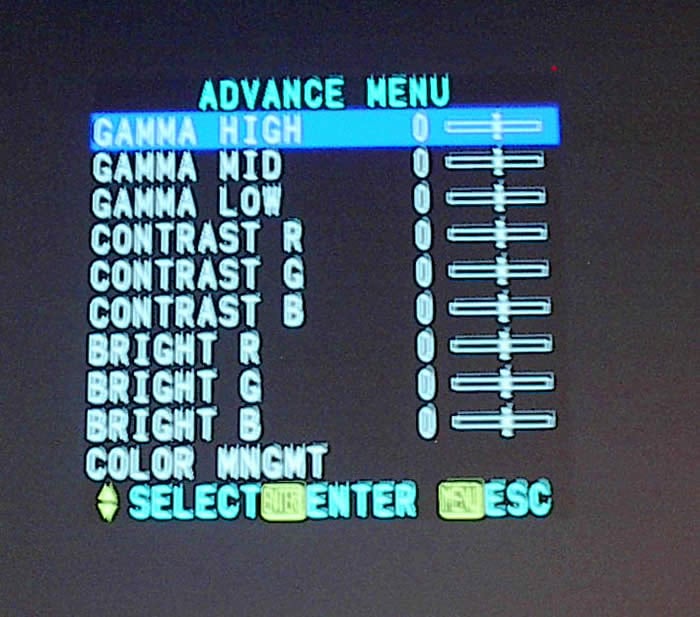

Beyond the basic video adjustments there is an Advanced video menu that some may choose to take advantage of for tweaking the RGB gain, cut and gamma levels. Once everything was set up there were 3 user memories to save the settings. This allows for configuration of Day and Night settings, as well as one for Black & White films (setting the color temperature to around 5000K).

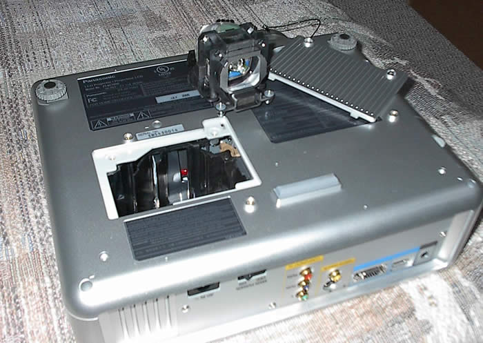

The next thing
I wanted to know was how easy it would be to replace the lamp.
The manual does warn that lamp
replacement should be performed by a qualified technician before it shows how to do it.
My guess is
that most people that are purchasing a projector in this price range are probably going to replace the
lamp themselves.
The lamp replacement turned out to be almost as easy as cleaning the filter except
a Phillips screwdriver is needed.
If the projector has a ceiling mount then that would probably
have to be removed but this lamp is rated at 3000 hours which should equate to at least a couple of years
depending on your viewing habits.
There were two screws that held the lamp cover. Once the lamp was
exposed there were two more screws that held in the lamp assembly, but these screws only needed to be
loosened and not removed.
Once loosened, the whole assembly easily pulled right out and put back
in. Notice from the picture that the projector was placed on something soft, as you would want to be very
gentle in handling it.
