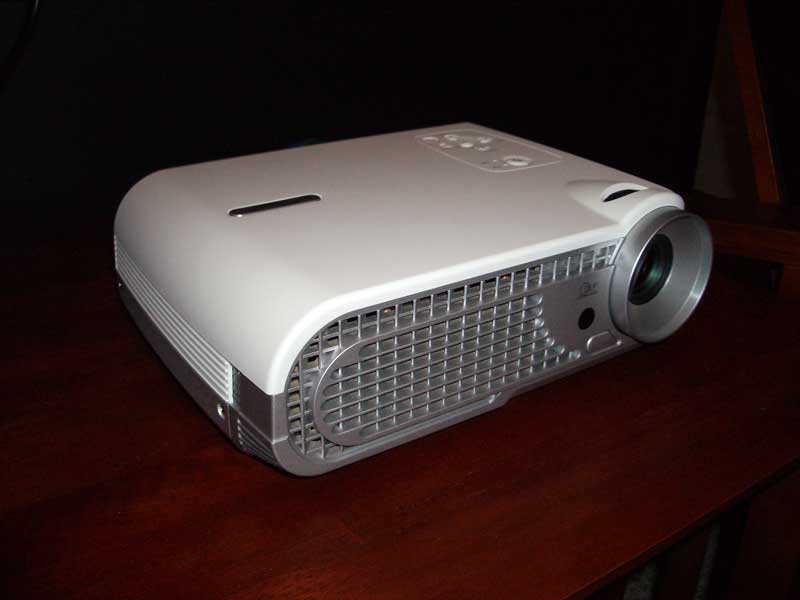

Optoma H31 Setup & Installation
This projector is a bit difficult to mount using a tabletop, due to its unusually high projection angle. However, if you are ceiling mounting it you will only need to concern yourself with the distance required to correctly fill your screen. For this review we utilized a Carada Criterion Series 92" diagonal screen (with Brilliant White material). This is a nice high quality screen and is optimized for excellent white levels while allowing for deep, rich blacks in a light-controlled room. For those considering the Optoma H31 in their home theater room, take a look at the 16:9 throw chart:

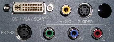

Connections
You can connect an array of devices to the Optoma H31 projector, including DVI (w/HDCP), component, s-vide and composite. An RS-232 breakout cable is provided and there are both front and rear IR receivers, allowing for flexible mounting options.
As previously mentioned, we utilized the component video inputs (YPbPr) as well as the HDCP-enabled DVI input for our tests. We sent interlaced signal from the Denon DVD-3910 to the Optoma projector and allowed the onboard PixelWorks PW1231 to convert the signal to progressive scan, performing all deinterlacing functions as well as 2:3 pulldown. The connections are very nicely spaced out and are much easier to utilize than some other projectors I've worked with. The DVI input is odd in a market quickly being dominated by HDMI, however the DVI connection offers a much more secure connection. For video, the two formats are nearly interchangeable and the included adapter should help take care of any mismatches you may have.
When asked, Optoma quickly noted that the advantage of DVI-I (in additional to more secure connection we mentioned) is that it provides additional support for analog or digital RGB signal from either the VGA or DVI port of a computer. H31's good color and contrast makes it an excellent tool for displaying digital photos or video from computers. As the H31 is a very lightweight projector, this makes it an excellent choice to double as a presentation product (and thus potential business write-off - but don't tell your accountant I said so).
