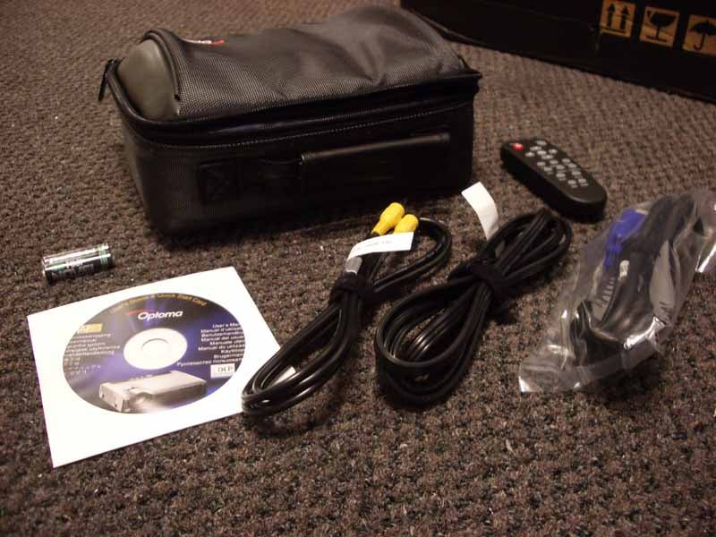

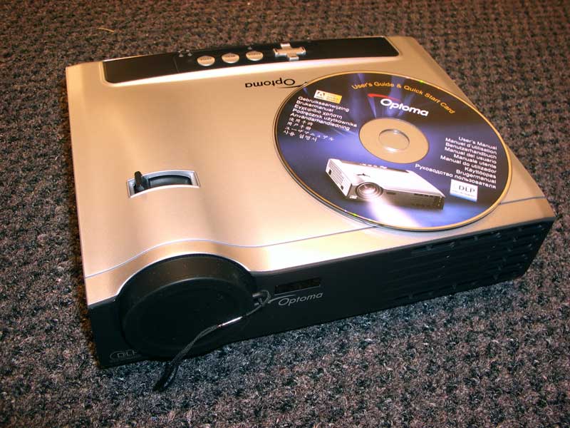

The EP7150 comes packaged in a nice box that includes a ton of goodies.
First of all, the padded carrying case is a wonderful inclusion as it provides
protection for a unit that is almost certainly destined to be carried about on
business trips. S-video and VGA cables ensure that the two main methods of
connectivity for this product are taken care of and a remote control (with
integrated laser pointer) accompany a durable, removable power cable and CD-ROM
user manual.

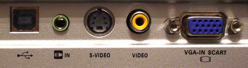

The EP7150 doesn’t have a ton of inputs, but it doesn’t need to. Just like an ultra-portable laptop may not have an on-board optical drive, the EP7150 saves weight by eliminating things such as HDMI/DVI and reducing the optical system (for instance, it utilizes a smaller 2x speed 4-segment color wheel).
I tested both the VGA input connections as well as the composite video connections for our viewing tests, however I believe the VGA input to be the most commonly use on this type of projector. While you can connect a DVD player to this projector using VGA or s-video I don’t think that running a full suite of benchmark tests would be an appropriate fit – it would be like entering a Porsche into a truck pulling contest – wrong class, wrong test.

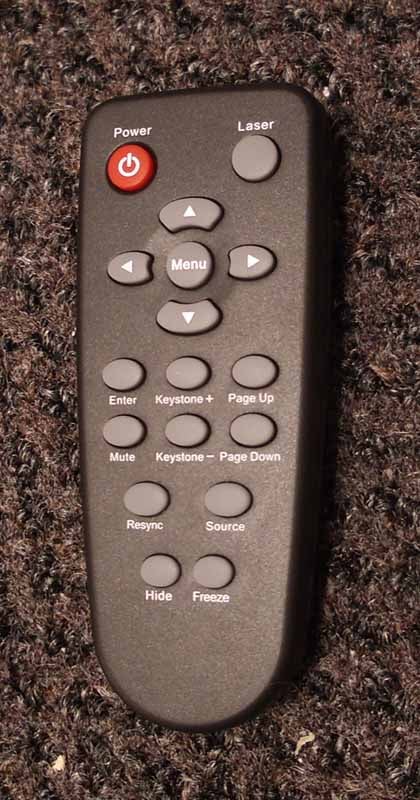

True to their style, it
seems as if every Optoma projector sports a different remote control – that
changes with ever new model. This one is functional, and since it will almost
certainly be used in full light (and not a home theater environment), there’s
no reason for it to be backlit. The obligatory on-board laser pointer is easy
to use, however I did find that it had a “slippery” trigger. Sometimes I’d have
the button down, but it would somehow deactivate the laser anyway so I’d have
to “reacquire”. The handy ‘Resync’ and ‘Source’ buttons work well if you don’t
have Source Lock engaged and want to use two different sources for some reason.
The USB connectivity allows you to utilize the remote as a mouse, though I
found the ‘Menu’ and ‘Enter’ buttons to be somewhat flipped. The other function
that would be a great addition to the remote is the ‘Display Mode’ – for
cycling through the output and color options. If you are in a light-controlled
board room, the Movie mode will
result in much more accurate color reproduction than the PC or Bright modes. Audio
is also not controllable via the remote (nor is there a Mute button) which is a
major oversight in my opinion.
Keystone buttons are readily available, and with a business-class projector you’ll finally hear me recommend its use. In fact, the net effect when observing text on the screen is akin to anti-aliasing, making the fonts appear to be “bold”:

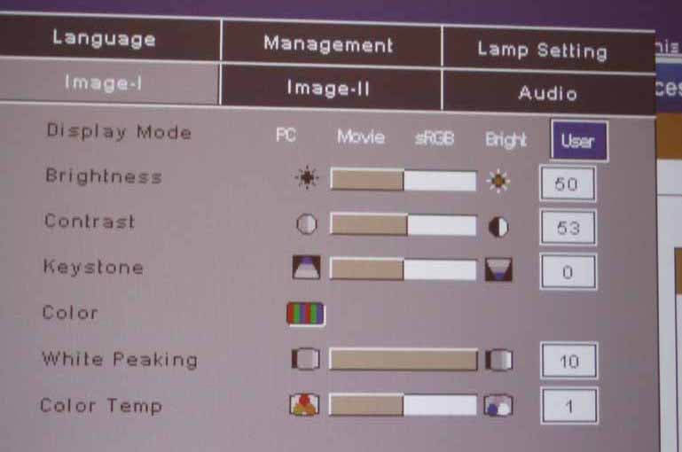

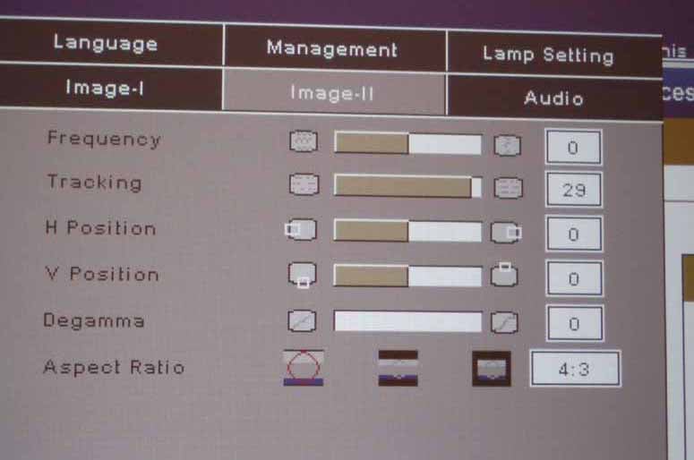

The menu system of the Optoma EP7150 is simplistic in use, but robust enough to deliver all of the basic functions you’d need or expect in an ultra-portable unit. The system is divided into 6 sections: Image-I, Image-II, Audio, Language, Management, and Lamp Setting. Here is the basic layout:
The key items that will come in most handy are the Display Mode, White Peaking and Color Temp settings under the Image-I menu. White Peaking is great when you have a lot of ambient light in the room, but it will also result in your oranges being converted to brown due to the artificially high contrast. If you get some light control, dialing this setting down will give you much more accurate colors. If you do happen to utilize a source that is 16:9, you can go under the Image-II menu and switch to 16:9 mode.
Under the Audio menu you can
raise or lower the volume and mute the projector. As we mentioned previously,
this is not directly available on the remote – a potential problem if you
frequently need to adjust or mute audio output in your presentations.
Calibration is also not something you can do handily with this unit – but then
again I’m not sure why you’d bother with anything beyond basic color controls
(and universal RGB adjustments are available if needed.)

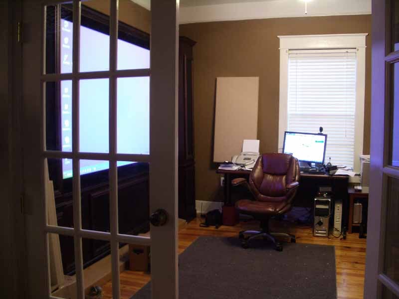

Lights On? No Problem
One of the continuing themes of this review is brightness and lamp
output. The EP7150 is so bright that I had a hard time, with digital
photography, getting the concept across using a picture. Finally, I snapped a
shot from outside the viewing environment after I removed all drapes and light
blocking material from the room. With full lights on you can see the results
here – a super-bright image that can be easily seen. It’s almost unreal how
much light output you can get from this tiny projector.
The rest of the pictures you’ll see in this review were also taken with the room lights on. There simply was no reason to dim the room for photos.

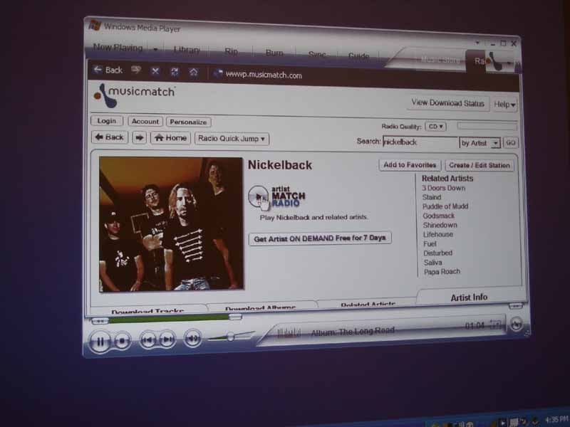

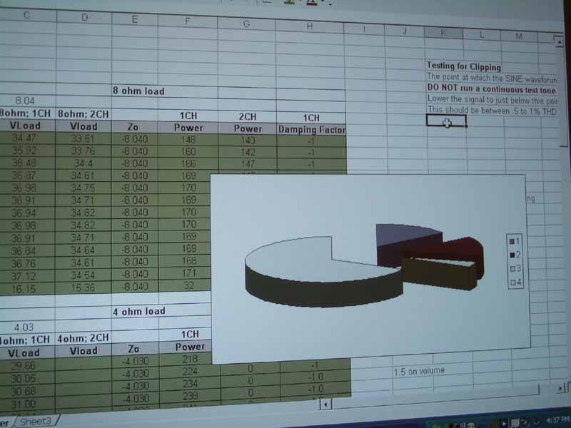

PC: Charts, Microsoft Office and MusicMatch
Charts look pretty colorful
and text is, of course, extremely legible at the native resolution of this
projector. I always recommend flipping the source PC to the projector’s native
resolution. When you’re projecting on to a screen, you don’t want to match the
laptop screen – it’s all about 1:1 pixel mapping onto the projector. The result
is clean, clear, readable text that isn’t “fuzzy” or artificially anti-aliased.
When utilizing Windows Media Player and MusicMatch, all information was easily
viewable on our oversized screen.
