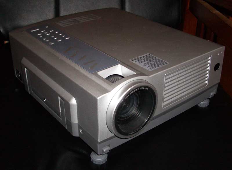

LCOS 1400 Features, Setup and Connections
Having been a fan of LCOS technology for some time, we were excited to receive a sample LCOS 1400 projector from MAXX Products. Running it through its paces allowed us to compare this technology up close to LCD and DLP projectors we had utilized to date. The sample we received was a heavily-used model lacking in some of the features MAXX says is present in its newest revision of this machine (such as DVI with HDCP). As the LCOS 1400 is pretty much a re-badged JVC D-ILA projector (the DLA-SX21U/E) we believe MAXX Products when they tell us that currently-shipping models include DVI w/HDCP.

Basic Setup and Installation
There are a couple of things you need to concern yourself with when purchasing a front projection system. First and foremost you'll need to determine the mounting position for the projector and, concurrently, what type and size of screen will be required for a good fit. For this review we utilized a Stewart StudioTek 130 screen, This is an ISF (Imaging Science Foundation) certified screen and is optimized for excellent white levels while allowing for deep, rich blacks in a light-controlled room. Focusing the MAXX LCOS 1400 was a challenge as it could only be done manually. From about 15 feet away I found myself rocking the focus back and forth until I settled in the middle where the image on the screen appeared to be in focus. A digital focus would have been much more welcome - especially with a fixed focal image that could be projected onto the screen.
The LCOS 1400 also has a manual zoom that goes from Wide to Tele. You can use this to get the sizing you need, so you'll have some play to get the exact distance to match your screen size. Other than that, you'll need to set the Aspect Ratio for the projector content and some other small details like screen type (16:9 or 4:3) and whether you want the menu to stay on for 10 seconds or until you tell it to go away (we preferred the latter.)

One other thing you'll need to be aware of is that the MAXX LCOS 1400 lacks any lens shift capability. This means you'll need to mount the projector exactly in the correct position for your room and screen size. It does come with a fairly sophisticated digital keystone function, but that should be avoided whenever possible as it softens the image - even if used just a little bit.

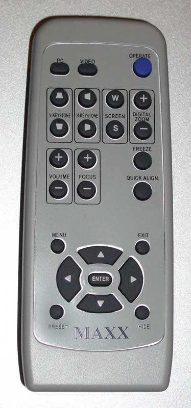

LCOS 1400 Remote Control & Calibration
The
MAXX LCOS 1400 remote control is about as basic as it gets. No
backlight, no direct input selection, and no frills. What it does offer
is direct access to keystone functions, menu access, volume and input
selections (two buttons for cycling through "PC" labeled inputs or
"Video" inputs. The PRESET button should really be labeled "Reset"
since that is all it does in the scheme of its functionality. There are
not multiple user presets available for color temperature or the
display settings, so do not confuse this button for anything having to
do with recalling user preset functions.
There are FOCUS buttons on the remote, but they do not function with the LCOS 1400, which has manual-only focus. A HIDE button temporarily blanks the screen and mutes audio. Overall I found the remote to be very simplistic and uninteresting. One of the first things you'll want to do is get the commands into your universal learning remote and set it to the side. For installers this is a given so typically we don't place much weight on the remote control portion of a projector review at this price point.

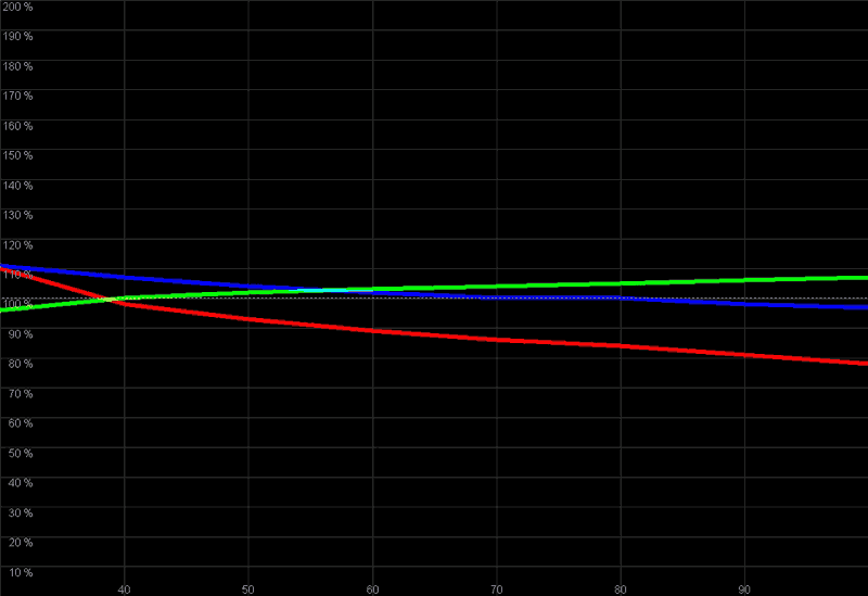

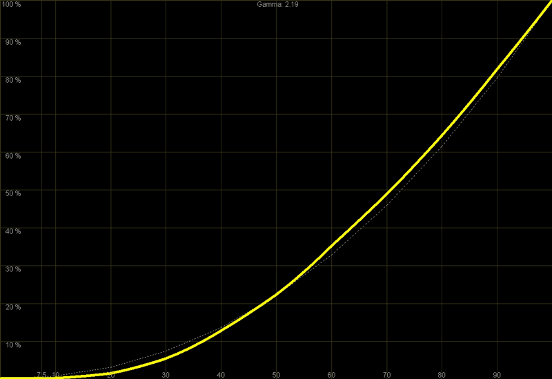

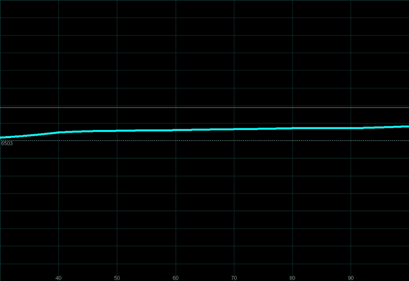

The LCOS 1400 offers you the standard Contrast, Brightness, Color, Tint, and Sharpness controls available on most displays. During my calibrations I ended up dropping the Brightness (black level) to -12 in order to get Video Essentials' pluge pattern down to where I felt it needed to be. The same menu that offers you basic video controls also provides a Color temp. option whereby you can select 6500, STD, or User (where you can adjust Red/Green/Blue parameters.) I set the projector to 6500 and proceeded to run some basic calibration tests using the M ilori ColorFacts System.
As you can see from the above results, the LCOS 1400 passed our color balance and grayscale uniformity tests without breaking too much of a sweat. The Temperature Histogram is fairly flat. The luminance Histogram shows a consistent ramp from 0 to 100 IRE. The RGB levels are not quite uniform throughout the luminance range, however they are tolerable, with red tending to dip down gradually as luminance increases. Since we were on a rushed review schedule I didn't even bother attempting to improve the performance of the projector. It would likely take going into the service menu to make further adjustments as RGB adjustments are not readily available as such in the user menu.

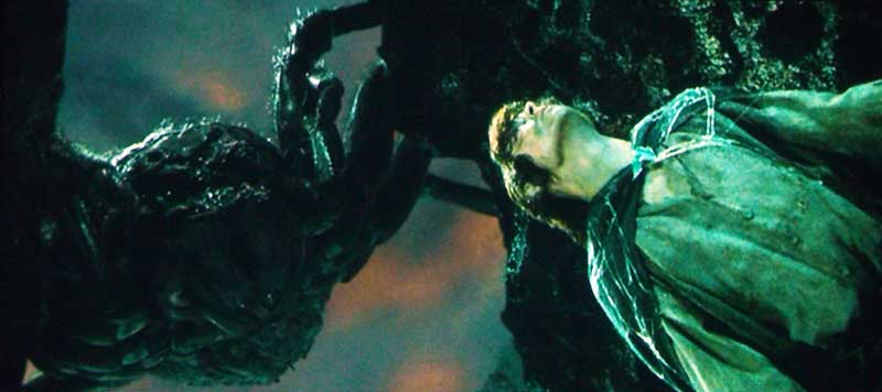

story. In the scene where Frodo attempts to escape from Shelob the
amount of detail and depth is amazing. Take a look at the rock detail
and the expansive but visible depths that can still be seen in the
darkness of the cave areas. The spider is part CGI, part prop, however
in both cases the armor detail is absolutely meticulously detailed.

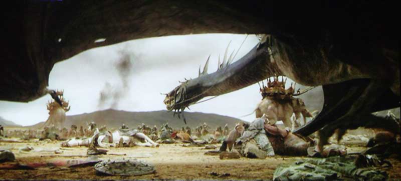

as well as the armor and faces of orcs and goblins. In the second half
of the movie, when King
Theo
den is killed by the Lord of the Nazgul take a look at the winged
creature as well as the surrounding landscape. The color and depth of
field in the scene was really brought to life by the high resolution
LCOS display.
